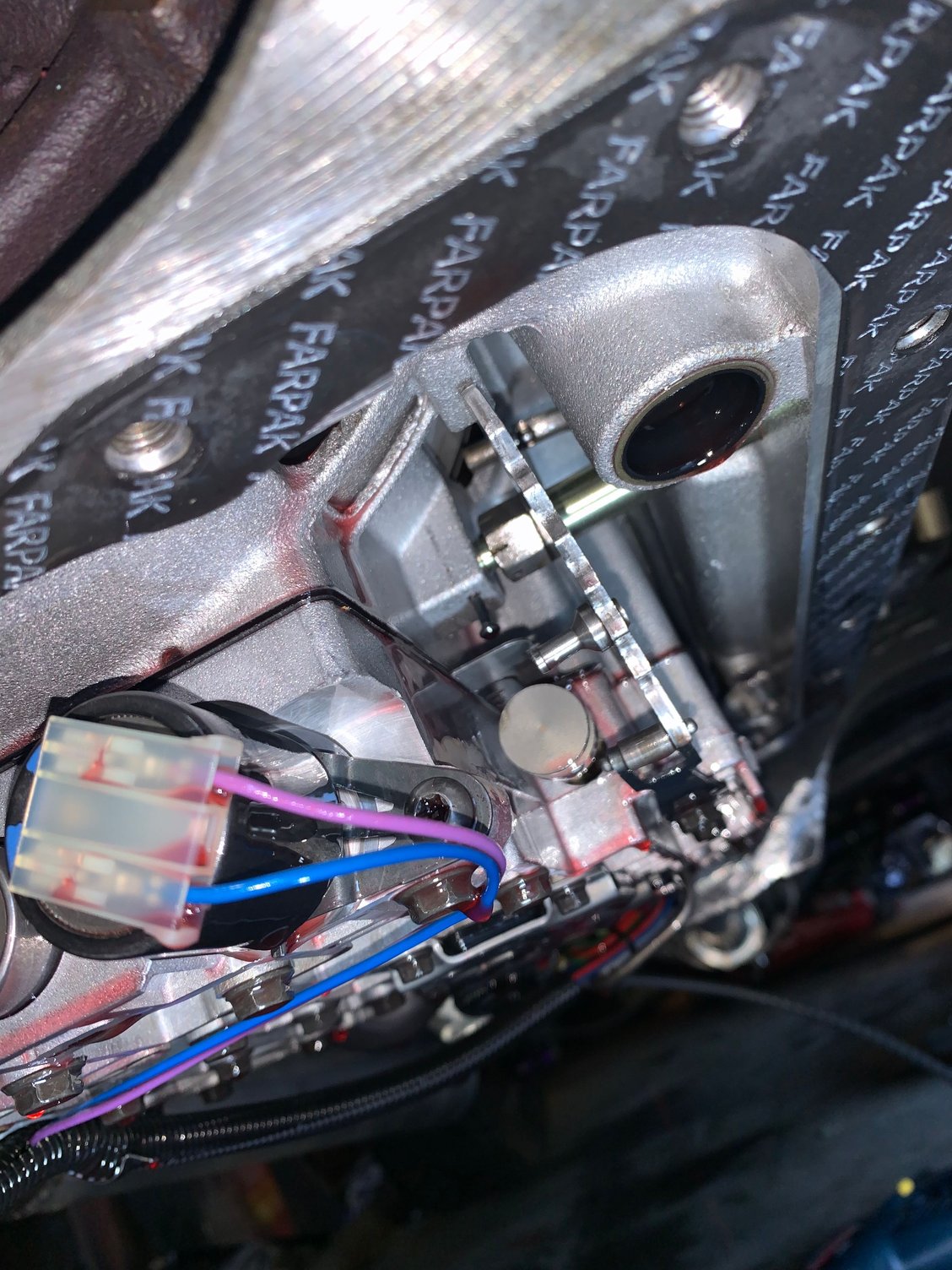

So I took the pan off today. The manual valve was not connected to the rooster comb. I saw that the rooster comb was not flat and as you turned the shaft the bend would pull the arm away from the manual valve.
It’s hard to see in the picture but the rooster comb is not flat. It is warped.
Good engagement into the manual valve
After straightening out the rooster comb the arm is firmly in the manual valve

thats a new one! usually the whole shaft is bent from the JY parts pullers bashing them around with forklifts
