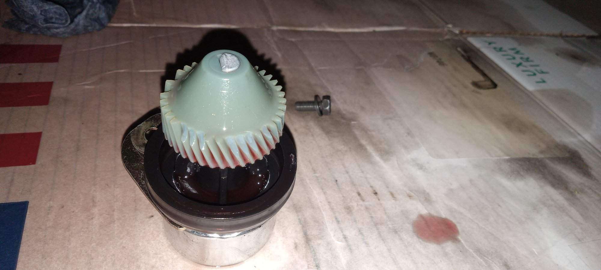

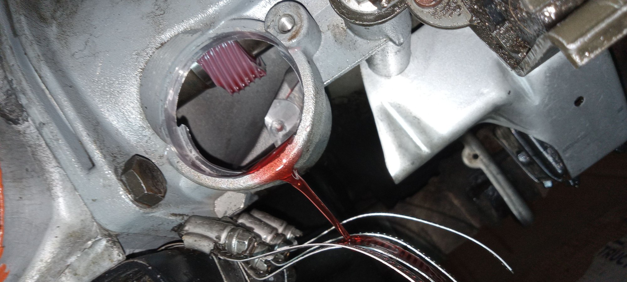

Originally Posted by mrvedit
F14D: Not to be an a-hole, but this forum is LS1Tech, meaning it starts with cars from 1998...Now for a suggestion, please post pictures of the VSS. Please be patient and perhaps consider posting on a forum which better covers your '93.
The subtitle of the automatic transmisson section reads: "2-Speed thru 10-Speed GM Autos | Converters | Shift Kits"
Tayto, what do you think? Looks to me i might have the 17 tooth red and 42 green or 45 light blue? I didnt count its teeth regretably but spacing and color suggest. My homework found my 700r4 3.23 245/50r16 should have 38 blue and 15 grey or keep the red 17 and buy 43 purple..info is from TGO
Chipping. Niiiiice. Please disregard the tan yellow comment in the new topic. Clearly I was wrong there and want to admit when I'm wrong.

Old Jul 1, 2022 | 10:33 AM
tayto's Avatar
Joined: Jan 2013
Posts: 463
Likes: 179
Looks like your driven gear has seen better days. I would pick the combo that will read the most accurate. changing the drive gear isn't that hard of a job, just make sure you put the clip in the right hole, there are 2 to choose from. Your calculations look correct, I would see what' available. You might have a harder time finding the speedo gears with a metal shaft as they are different than the "regular" all plastic all mechanical speedometer gears. Try Teal Automotive in Indiana for parts. I used them the last time I recalibrated a 700R4.
