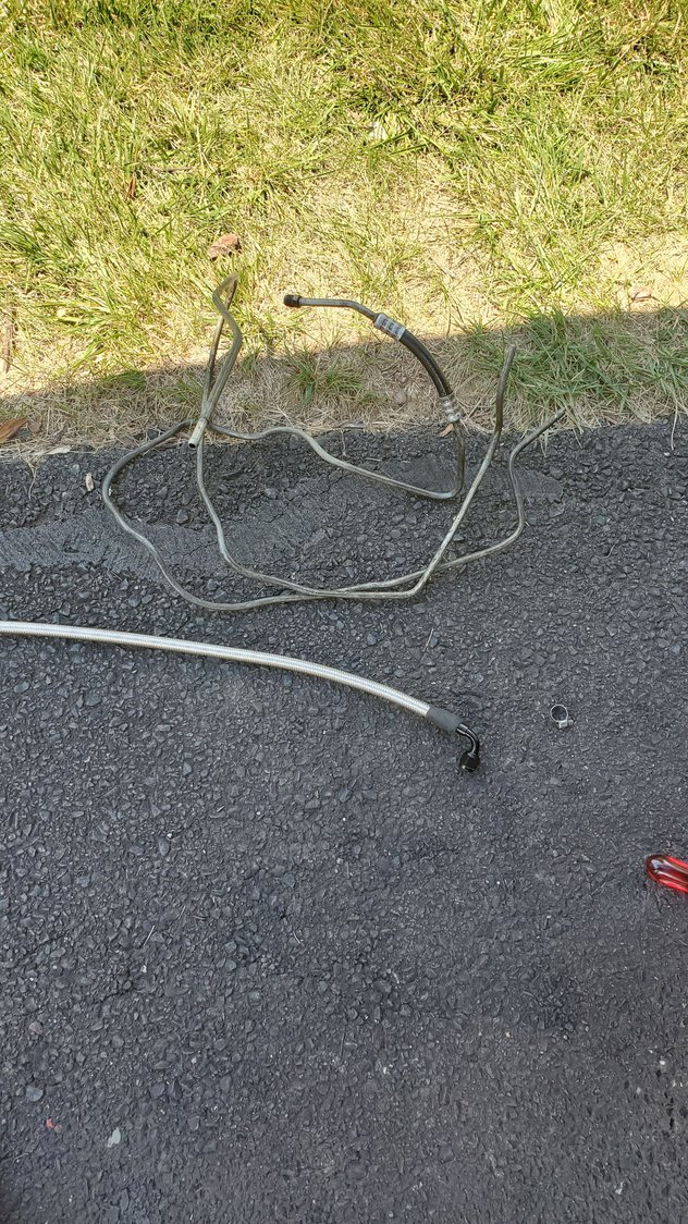

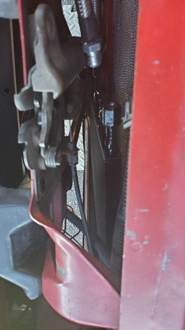

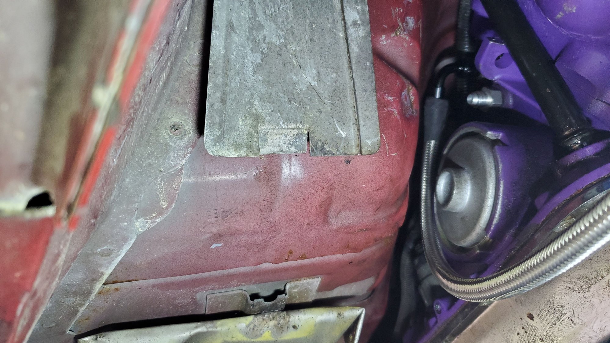

well I'm giving it the old college try and making sure that I didn't overlook something.
I pulled the stock trans line and I'm not sure in the process of swapping the cam, if I twisted the lines by chance. I also checked under the car and I did somehow miss getting the dipstick tube grommet back into the hole. might explain the leaking some. looking closer at the trans I don't see anything being pushed out the vent.
I now am running 6an lines to a tube and fin cooler to mitigate any restrictions in the cooling.
after some careful negotiating of the old lines and fittings, the new 6an fittings and conectors went right in.
the old lines didnt look like that lol had to bend them on the way out.
a low restriction tube and fin from autozone to make sure nothing is in the way.
