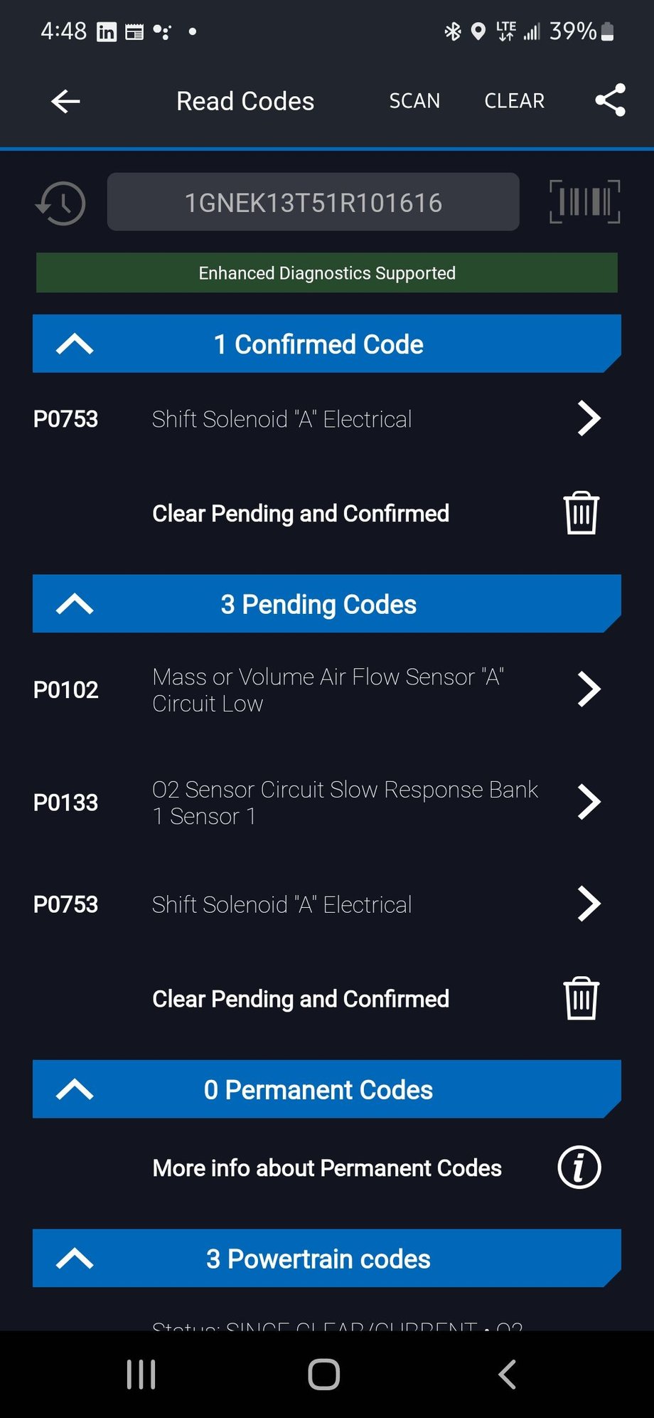

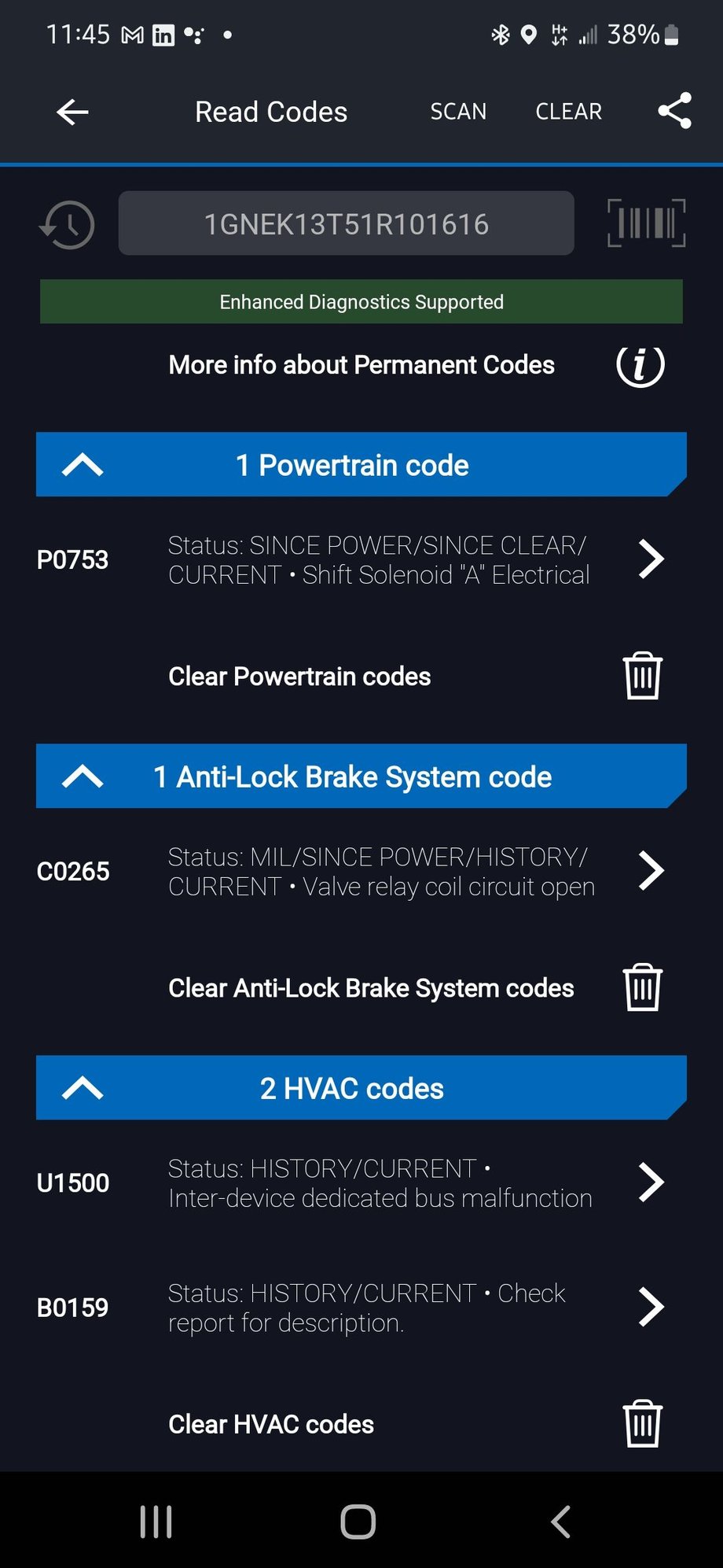

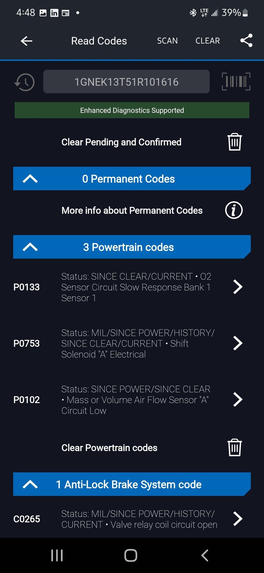

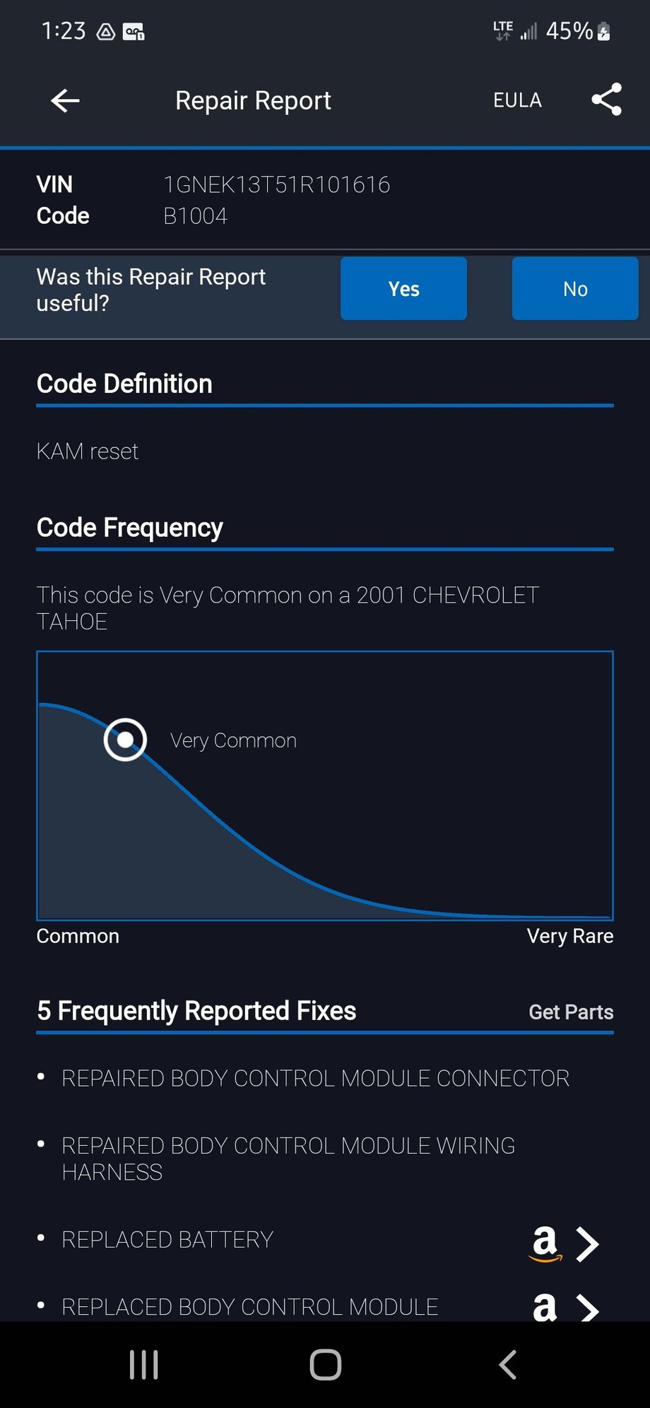

Hey everyone. just looking to get some pointers in the right direction as to what to look for next. Tranny is in but believe I am only getting 2-3. Reverse works fine. Manually shifting through 1-2-3 works but getting no OD. Code thrown was Shift Solenoid "A" electrical. I replaced both solenoids at the back just because I was in there anyways although they were both brand new. Fluid is good. Here's where the confusion comes in. My cluster doesn't come alive unless I plug a dongle into the OBD2 port at which time it works fine. It also started throwing a service 4x4 code which dissapears randomly. Starts up no problem. I'll attach a copule pics of the codes I got on my blue driver.

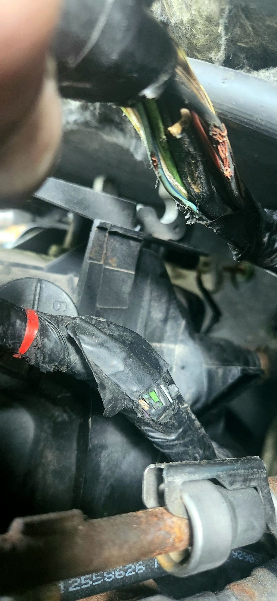

Sounds like there might be wiring issues. Here is some very good and useful info here

Well my friend, You nailed it. If that is not a wiring issue I don't know what is. I will update after but I'm sure we all know it will fix something lol.👌
