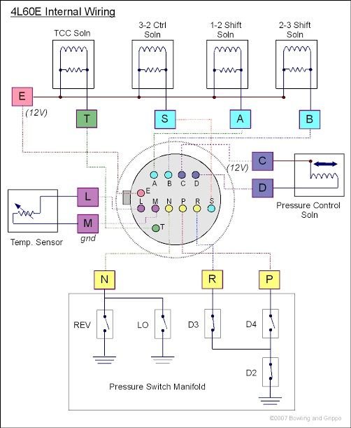

im not sure of the brake switch in your car but if it’s a normally closed switch then the problem won’t go away with unplugging the switch for some reason I have a feeling it could be a stuck solenoid you could test it by giving the trans 12v and grounding the tcc wire see if you can hear it engaging
heres a diagram for the socket on the side of your trans to help
