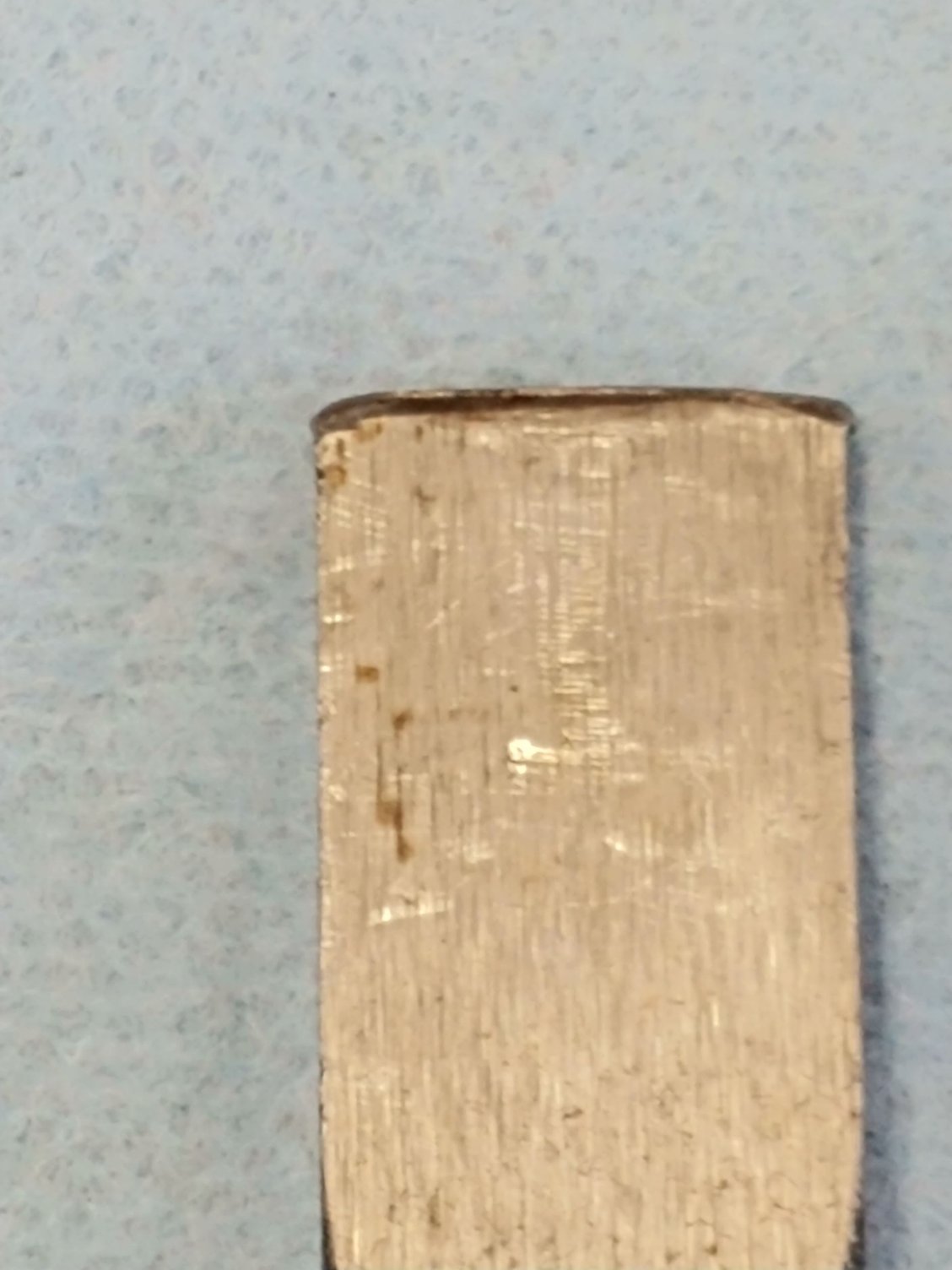

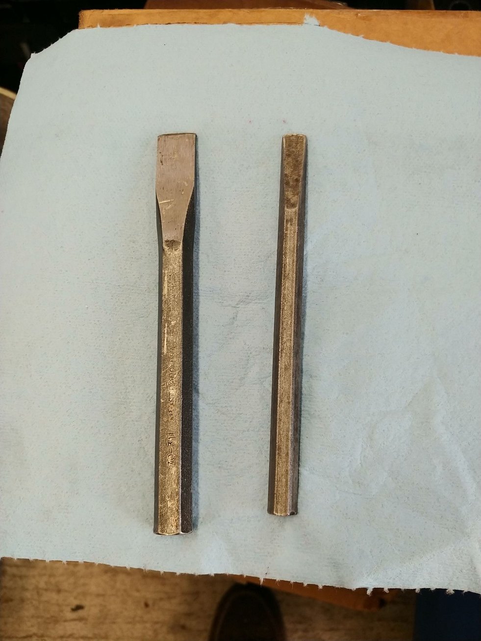

I used to rebuild planets. I have a cold chisel that I rounded the chisel point to stake them with. I also have an old 3/8" wide rounded tip chisel that worked very nicely too. I don't have pictures of those to upload. I could take a few tomorrow and upload them. If it will help you out...

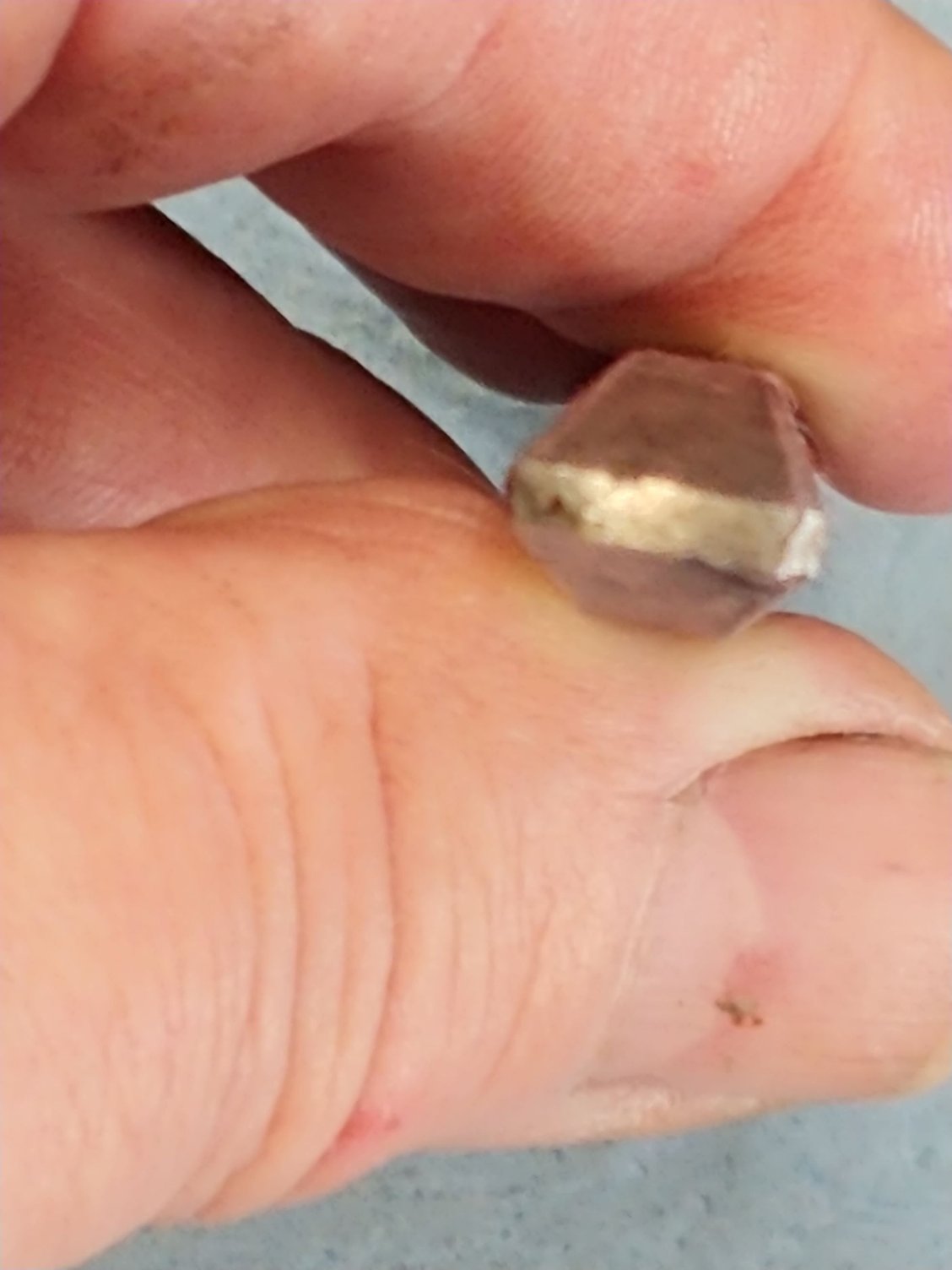

I do each side one pinion at a time. i use a hardened 3/8" bolt that I rounded the threaded end. I clamp it in a vice so that it will support the pinion shaft. Then you can stake the 4 on one side and readjust the bolt for the other side.

Here is the pictures I spoke of. Sorry if some are a little blurry..
that is simple enough I guess I was overthinkong it lol. Thank you

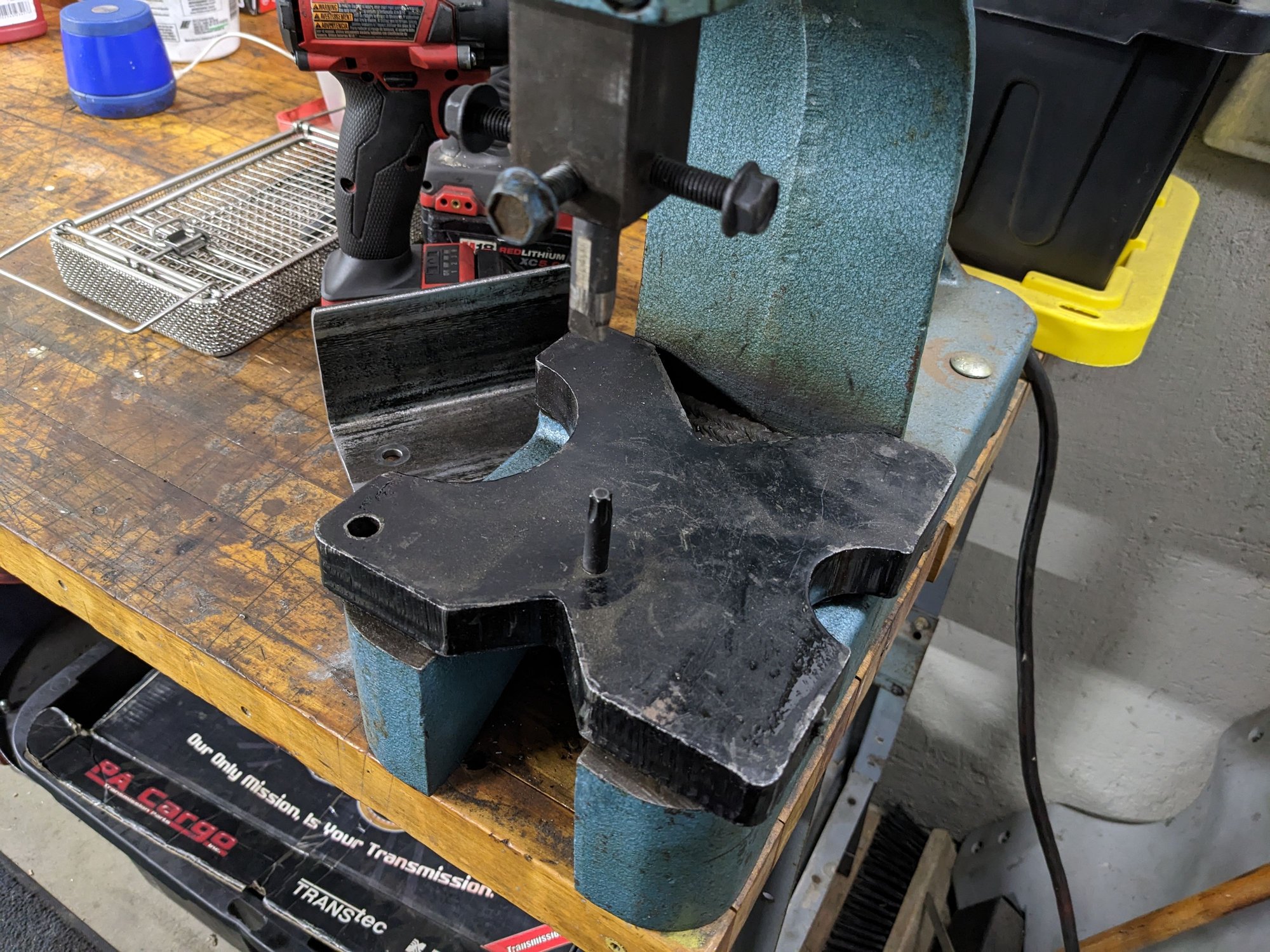

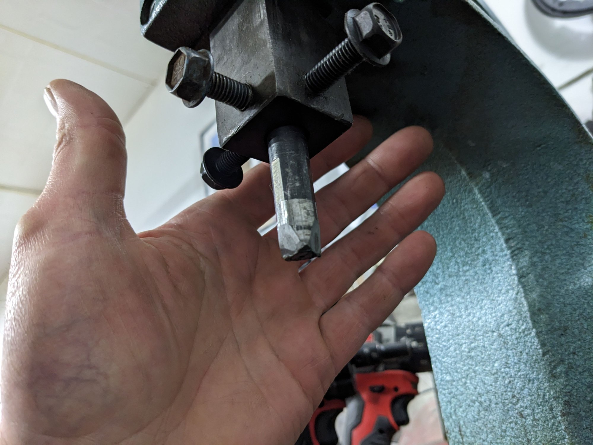

i do it essentially the same way, i just put my tool in a cheap arbor press and bash the top of the drive ram with a hammer to make the swage. i tried using a big pipe to get enough leverage but that just broke the cheapy casting of the press body.
and yep, one side at time, supported with a length of a tool steel from a rounded out torx impact that I drilled a hole partially into the arbor's anvil plate
i'll try and get a pic when im out in the shop next.

thank you for the help. I don't have an arbor press. Could I use my shop hydraulic press? If not I can buy an arbor press. Im gonna wait for a pic so i can get an idea. Thanks again nick
