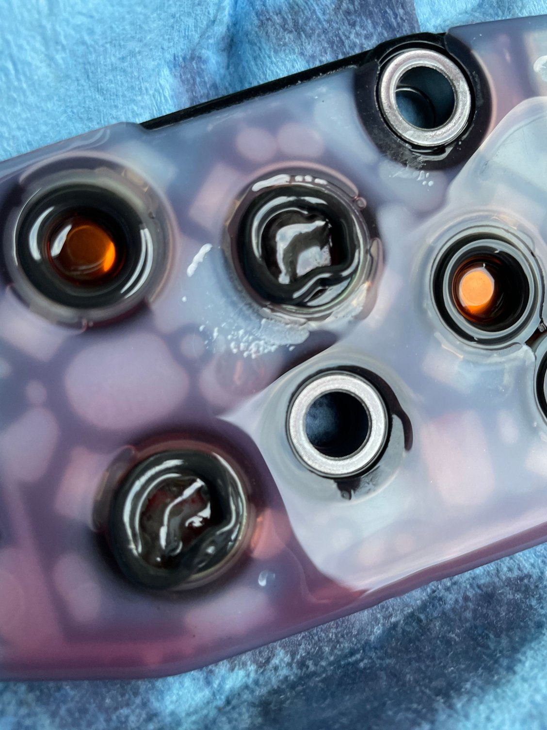

Dropped pan, removed tfp manual switch
its bad
smacks head
glad I found the problem
don’t order parts from Amazon

Glad you got it figured out. You can replace just those seals. You don't have to buy a new switch.
