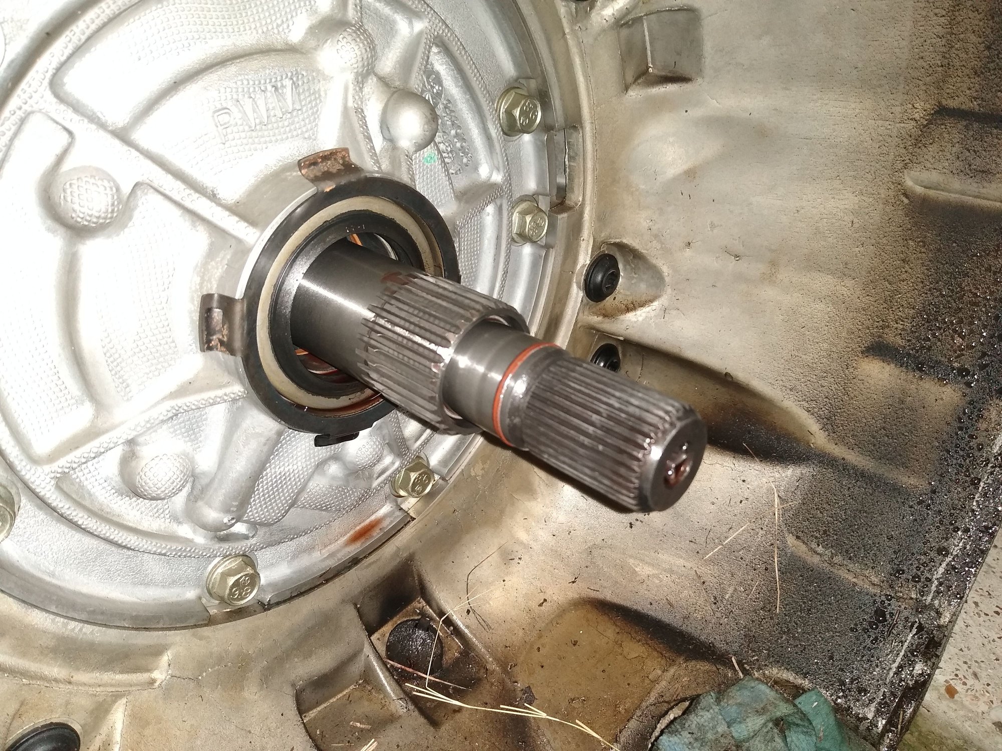

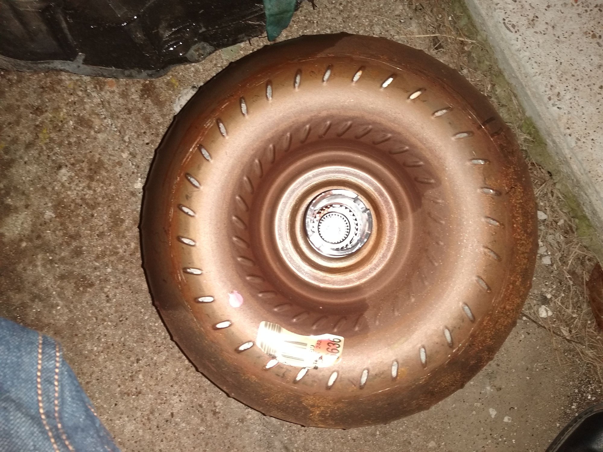

I assumed the GMT800 4L60e were all the same? The 4L60e that was in my 99 Silverado 4.3 had that top LS bellhousing bolt, which was empty. It also had the 300 mm input shaft. I've got some pictures somewhere.
I was doing a V8 swap on my truck and decided to swap to a 4L80e. The original transmission had developed that notorious P1870 valve body code, but otherwise was still fine with cherry red fluid. It had 260k. I sold it to a guy that had a Tahoe whose transmission blew up and was grinding. I told him I serviced mine and what it had, and was probably better to fix that one instead of his. I don't know what he did.
Now the 4L60e from the trailblazer, I don't know about that one. But I think some guys steal the torque converters for a budget higher stall speed converter?

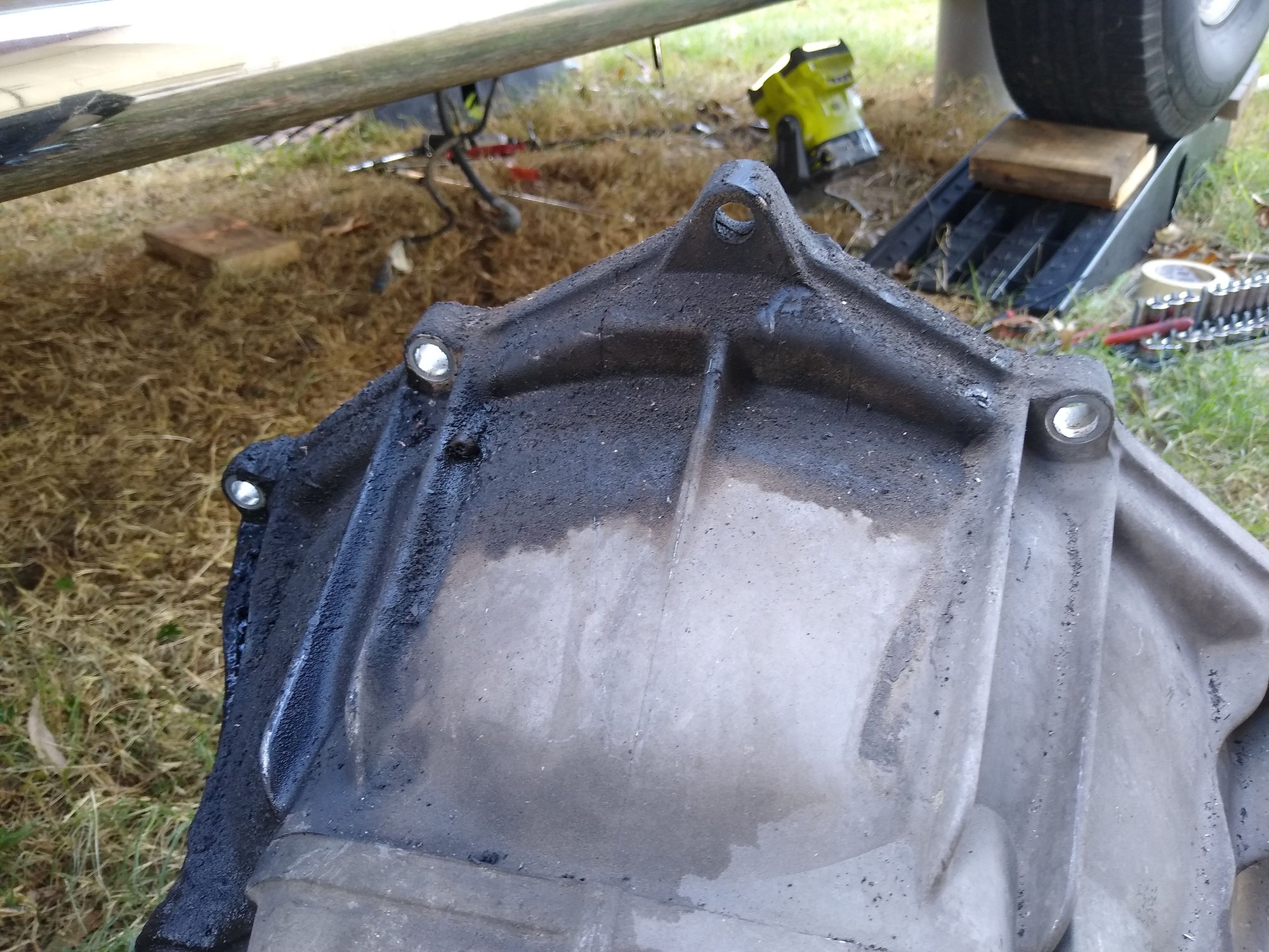

The s10's, sonomas, jimmys and blazers used the 298mm converters/inputs behind the 4.3's til the end in 2005.
Heres a 2004 out of one.

Attached like this from the sticky thread above.
Originally Posted by mrvedit
The spacer is only needed to bolt an LT-style 4L60E to an LS engine.
All pre-98' are LT style but some later years from non-LS engines are also LT-style.
LT style have a 298mm input shaft. LT converters have a shorter pilot.
LS style have a 300mm input shaft. LS converters have a longer pilot.
LS style have a slightly deeper bell housing and have a bolt hole in the 12 O'Clock position.
Most LS engines have a shorter crank that LT or SBC/BBC engines; hence the spacer is needed to properly engage the short LT converter's pilot into something solid. Alternatively a pilot extender can be used to engage into the crank.
An exception are some '99-'00 6.0L truck engines have a long crank LS-engine and came with the 4L80E trans. They would not need a spacer, but conversely will not directly bolt to an LS-style 4L60E. If really needed, the converter sponsors can make custom converters to solve incompatibility problems.

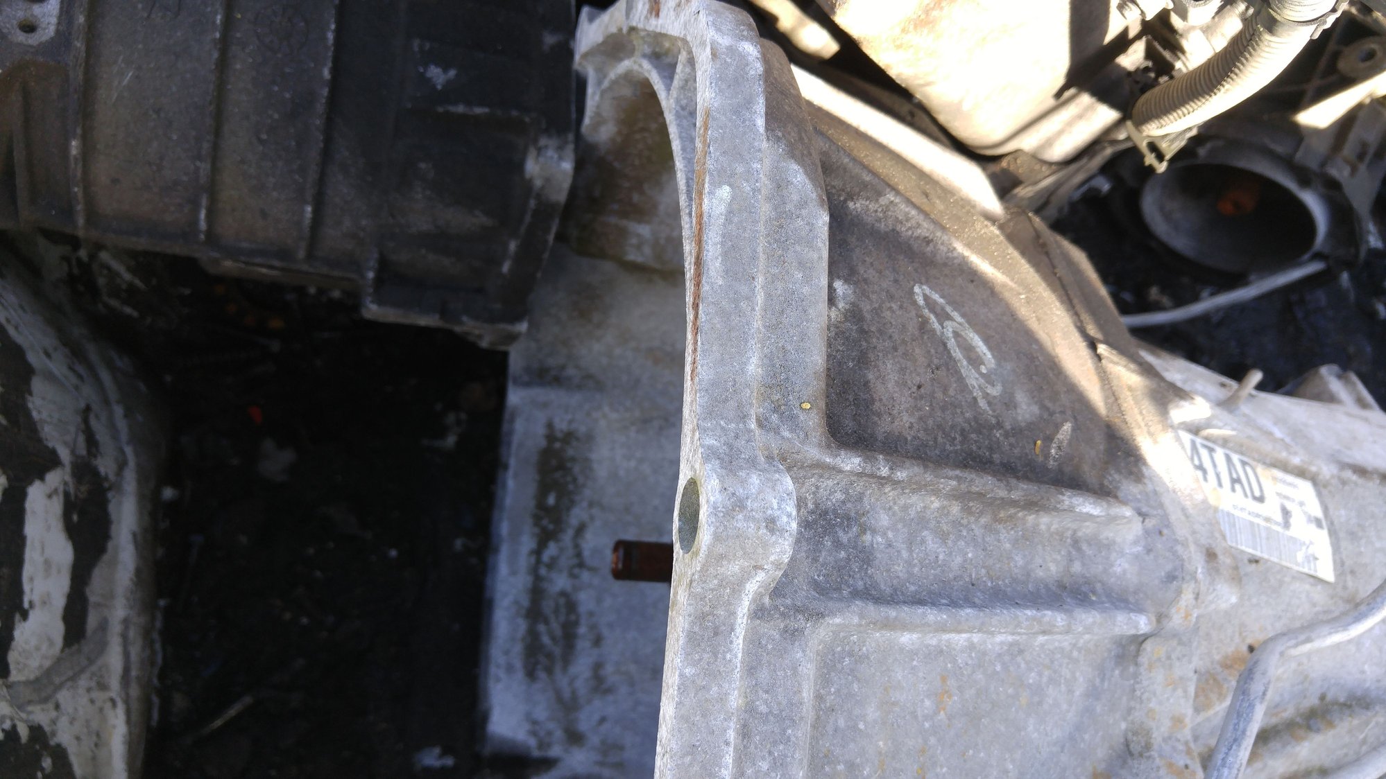

The 4.3L transmission in full-sized trucks had a 298mm converter & used the bell-housing casting 24206579 until the 2001 model year. In 2001 they started using a 300mm converter & the bell-housing casting 24206975. That is the same as the LS bell-housing.
The S & T trucks kept the the Gen 1/2 set up through there production run.. The picture of the 4TAD transmission is from a 2004 T-truck 4x4
And Yes I use the S & T truck 4.3L converter for a mild stall all the time, The full sized truck has a 1400-1600 stall, the S & T is a 2000 stall from the factory.
Same as using a Trailblazer 4.2L that has a 1800-2000 factory stall. it works very well in an LS with a mild cam. My own S10 LS swap is using the 2200-2500 High stall version that CVC makes with that OE core. It stall's very nicely at about 2400 from a stop. I just can't got WOT from a stop without frying the tires..
Thank you for the information!
Maybe my truck was an oddball? I bought it from the original owner back in 2007 w/ like 87k from an older gentleman and it was bone stock. Truck is an 1999 LS trim ECSB 2wd with 3.42/G80. Here are some photos that I took. I didn't get any numbers off it though, but on the first photo you can see a "9___." 1999?
Just dragged out from under the truck
Top LS bellhousing bolt hole
Old worn out 4.3
Input shaft
Torque converter

It's more likely my info is incorrect! Maybe it is the 4.3L in the vans or just the S/T vehicles and I'm confused.
My CVC converter catalog shows the 1999 up 4.3L use a BU45 converter. That converter is listed in the 300mm converter section. The 9CBD code in the picture is listed for a 1999 4.3L extended cab. It's clear that your unit is a LS bell-housing & a 300mm converter.
I stand corrected... LOL
Strange, this is what I have out of a 2003 Blazer while doing a 2.2 to 4.3 swap in my other s10.
I didn't take a lot of pictures but here is the '03 with no top bolt.
I cleaned it up and resealed it, it has a 298mm converter but I have not pics of it.
