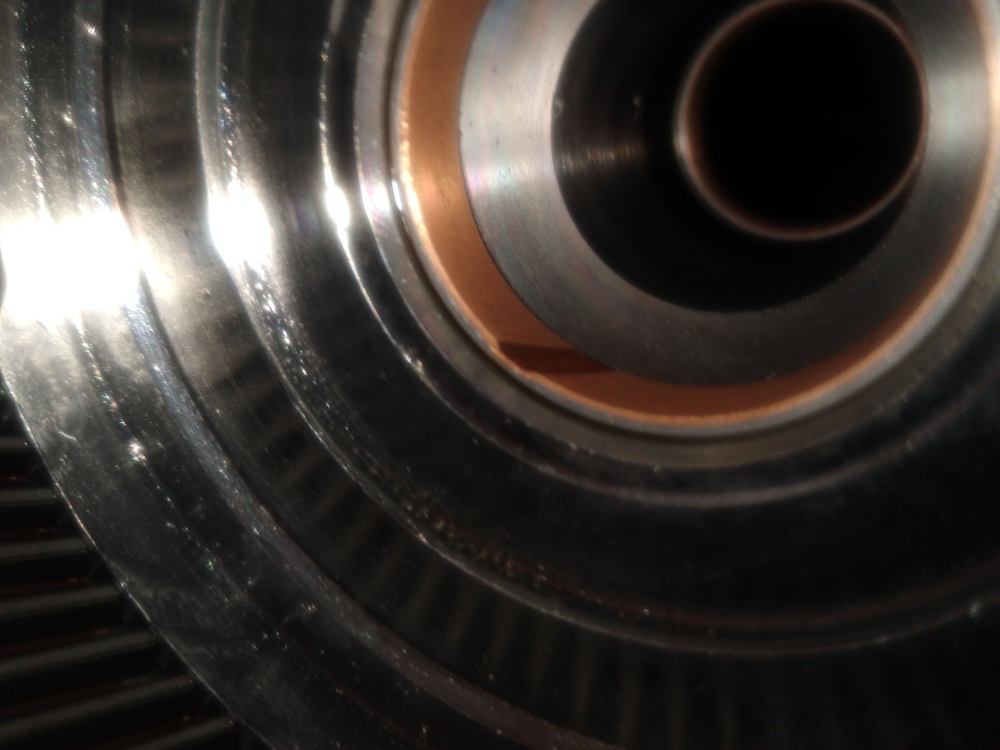

lube groove in that bushing is critical and yours are not lined up.
Not the right way to do it
I usually just recommend the wide bushing. It isn't much money and it's a nearly foolproof way to get it right!

wide bushing is fine.
Orientation relative to the lube hole is insignificant.
But orientation relative to each other when stacking bushings is critical. Need to make sure the slots act as one continuous slot.

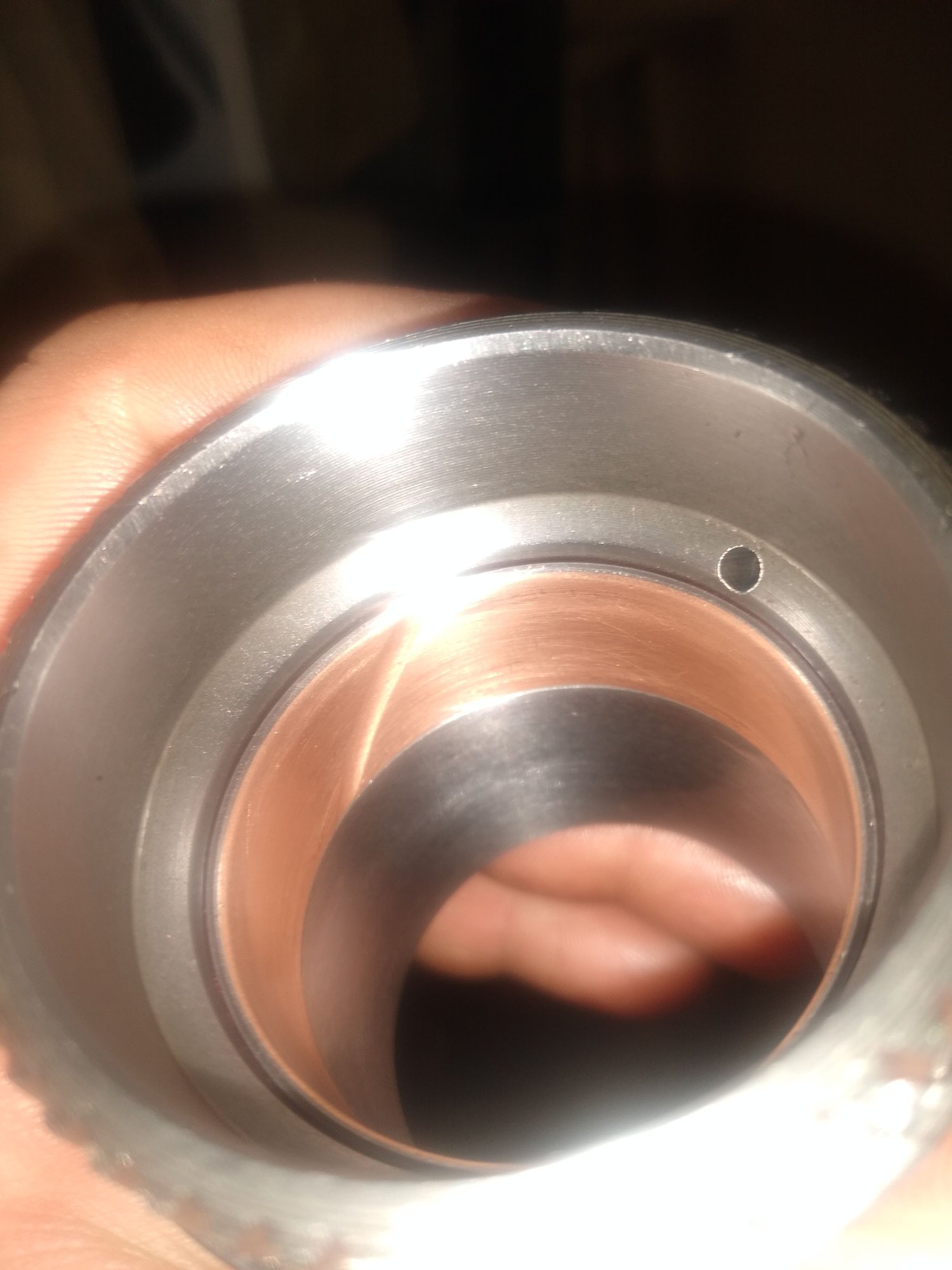

I have avquestion guys I'm now stressing about this so I checked my input drum air check they all hold good except when I put fluid on top where input shaft seals to case there's air bubbles coming out steady from this little hole not sure what this means hope I don't need a new drum because I don't have much $ right now any help? You guys will know pointing to it with screwdriver.
Edited about right after air checked again now I see some bubbles coming out of different spot looks like I need a new drum then right? very disappointing.
It has been a while, but I think a small amount of air from there is okay. The main thing is that there are no air leaks between shaft and the drum. I will check a few drums later this morning and get back.

After looking at an input drum more closely, that appears to be a plug. So, no air should not be coming from around that plug. You could try removing the plug and putting a setscrew in its place or replace the drum.
If I am wrong someone please speak up.
