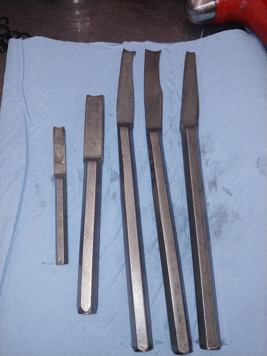

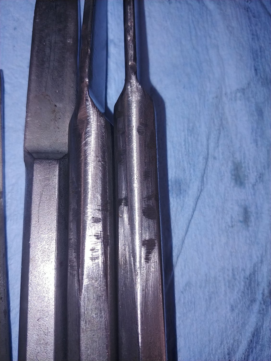

Once that bushing is out you can see how the machining for the front bushing stopped at the ledge. Different machinist's cut it deeper than other's. What I'm saying is that I have never had a wide bushing not fit. Some go to the edge of that chamfered edge and some won't. it's not real fussy, just as long as it it doesn't stick out of the stator. if pressed to hard into the ledge it will cause to tight of a fit. Then you will have to start over again. The wide bushing is much more difficult to get back out.
this is a picture of the bushing tools I use regularly. These came from Matco tools. I ground down some of the tips and the back side of the hex where i would contact the inside of the stator. The second picture shows 5 different ones. the three from left to right are the ones I use the most. I also have a coping chisel that I ground down the edges. that way it doesn't cut into the stator's softer metal.

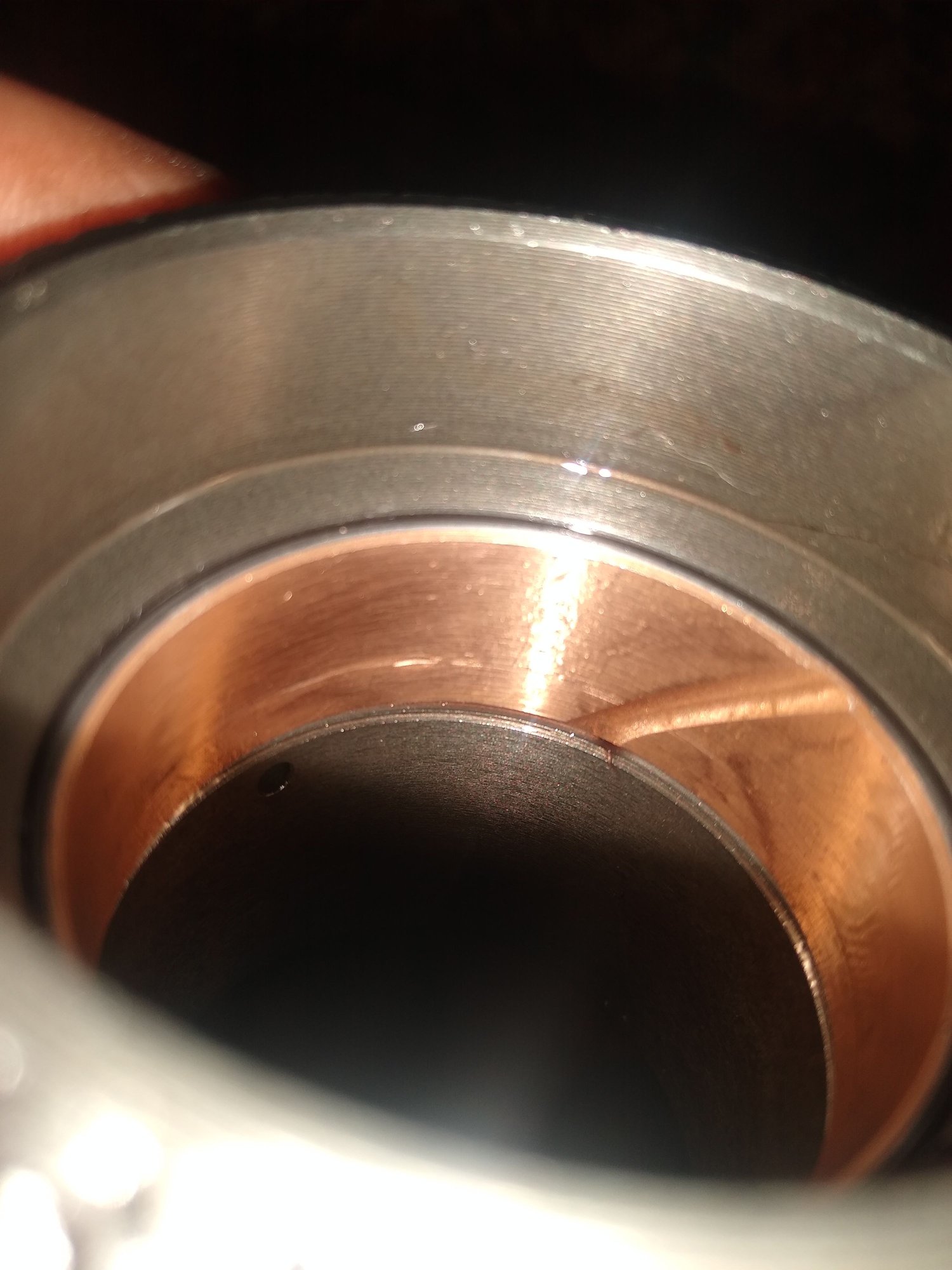

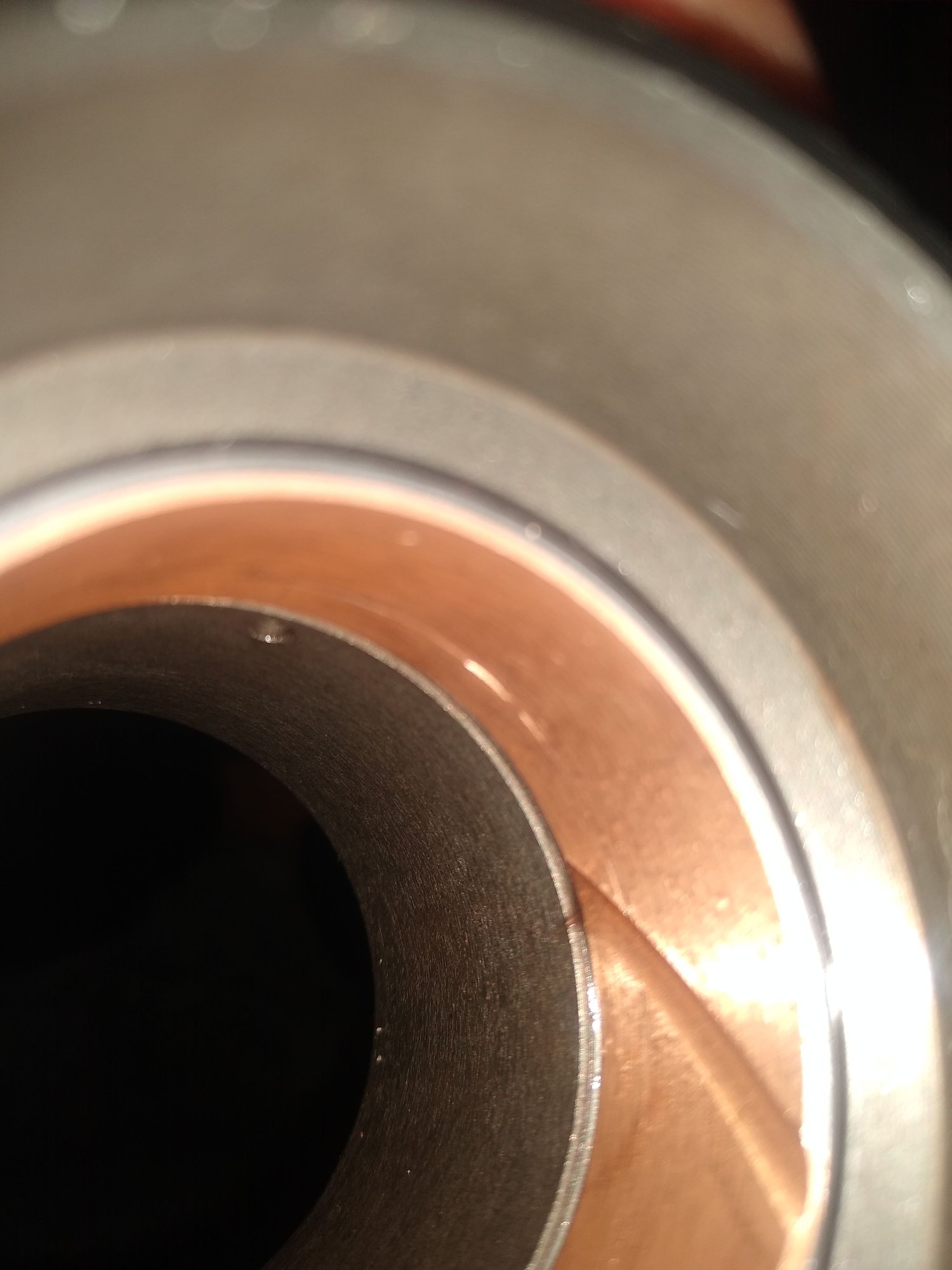

I installed wide sun gear sonnax bushing it had these lines around the edge is this no good now looks like it's coming apart I was careful I thought used a vice with bushing driver correct size drivers on the vice so I wouldn't marr it up. Can anyone tell me if this is no good or is it okay?
Old Feb 17, 2023 | 07:53 AM
bbond105's Avatar
Joined: May 2012
Posts: 3,052
Likes: 716
From: Poplarville, MS
If the bushing doesn't bind on the shaft, it is good. It appears to be a mark from the bushing driver.
That's definitely a bushing driver line. If you measure the driver length it is usually made for the OE narrow bushing. Add a little lube to the bushing and trial fit it on the reaction shaft. It must spin freely, if it feels a little tight use a disc brake flex hone to polish it up some. Or you can use some scotch bright wrapped around a drill bit or a accumulator buddy. I had one that was a little tight and thought it would fly, it welded itself to the reaction shaft on a road test.

If it is just a bur, I have had some luck with tapping the shaft or whatever piece the bushing is in with a plastic hammer. This will flatten out the bur a lot of times.

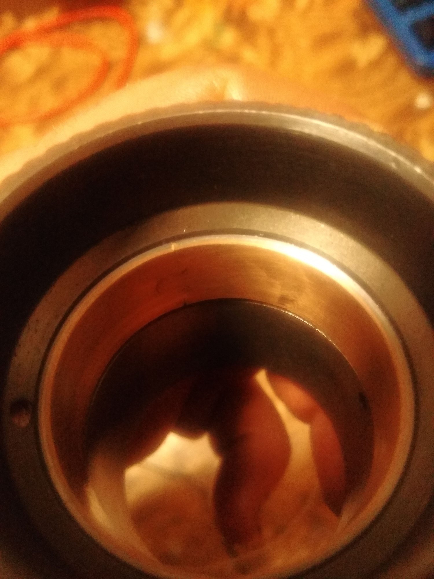

Thanks for replies guys so you think I'm good then? And so as long as it spins freely it's ok? And maybe use a brake cylinder home? Also does placement look good on my depth? I appreciate all the help. And what if the puzzle piece looking part started to separate at one point a little when I was driving it in?

I honed it out alittle the gouge is still there looks kinda deep is that bad to the point I gotta redo it? It's not very big but I don't know what should I do what would you do? I don't mind reinstalling if I have to.
