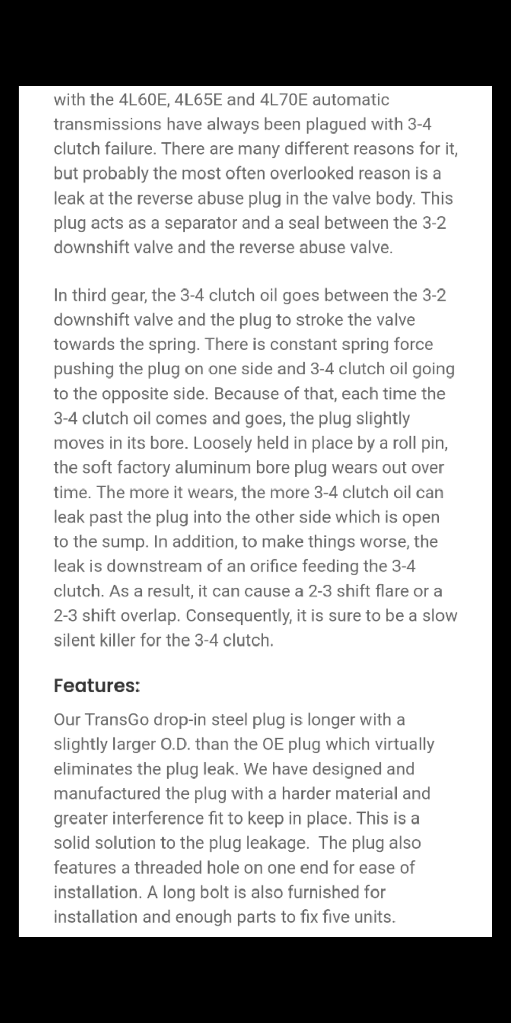

First Im gonna disconnect VSS , and check PCM at connector for corrosion. Parking is a problem, where I live , So hopefully, I can do it one of the weekends coming up ,then I need to physically check it, Im gonna make my list of parts, and order them, drop the pan , first look for chunks of clutch , if it seems good . Im gonna try and concentrate on the 2-3 shift , area of the valve body , note to self. Change the harness and the A n B solenoids and the other solenoids and manifold ,also I remember ,when I did the valve body plate that some hole was not looking to good and might have enlarged , so valve plate/ gaskets and the 2-3 valve, also there is a Abuse kit, I will probally leave the other parts I purchased alone and wait and see outcome😒💣🎲

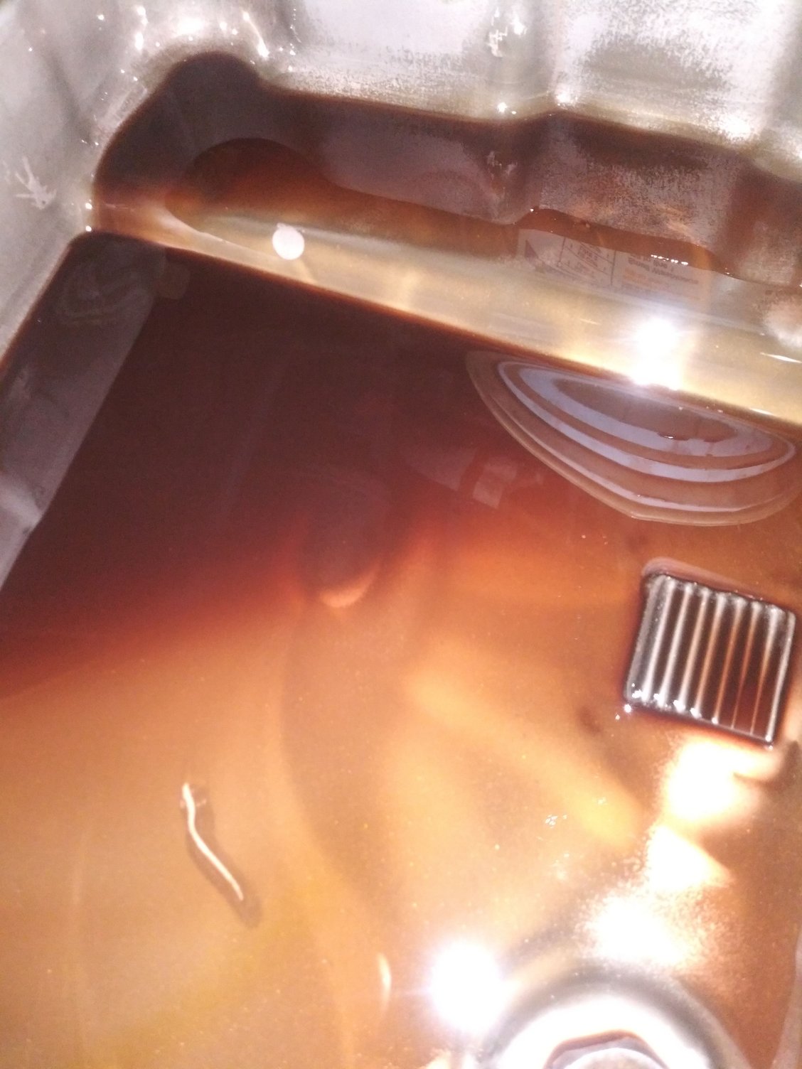

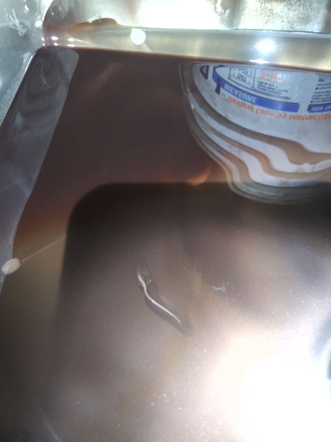

Last edited by GrumpyBstrd4L6LS1; Jan 29, 2023 at 11:55 AM. Reason: Looks like it is toast! Dam !Now should I get a trans with a long parts and Labor anty? How long? Low mile trans or rebuilt ?

Originally Posted by GrumpyBstrd4L6LS1
That's quite a bit of debris and burnt fluid. I have see far worse in less time. When you first actually got the pan loose. If you got a huge blast of a burnt odor, you can more than likely take it to the bank the 3-4 clutch is gone.. Time to pull it and rebuild it.

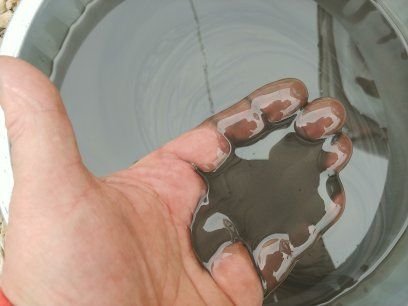

Here's a picture of fluid from one that made it 58 mile's on a defective NEW EPC solenoid. It spit a code for it and I told the customer not to drive it, he drove it anyway...

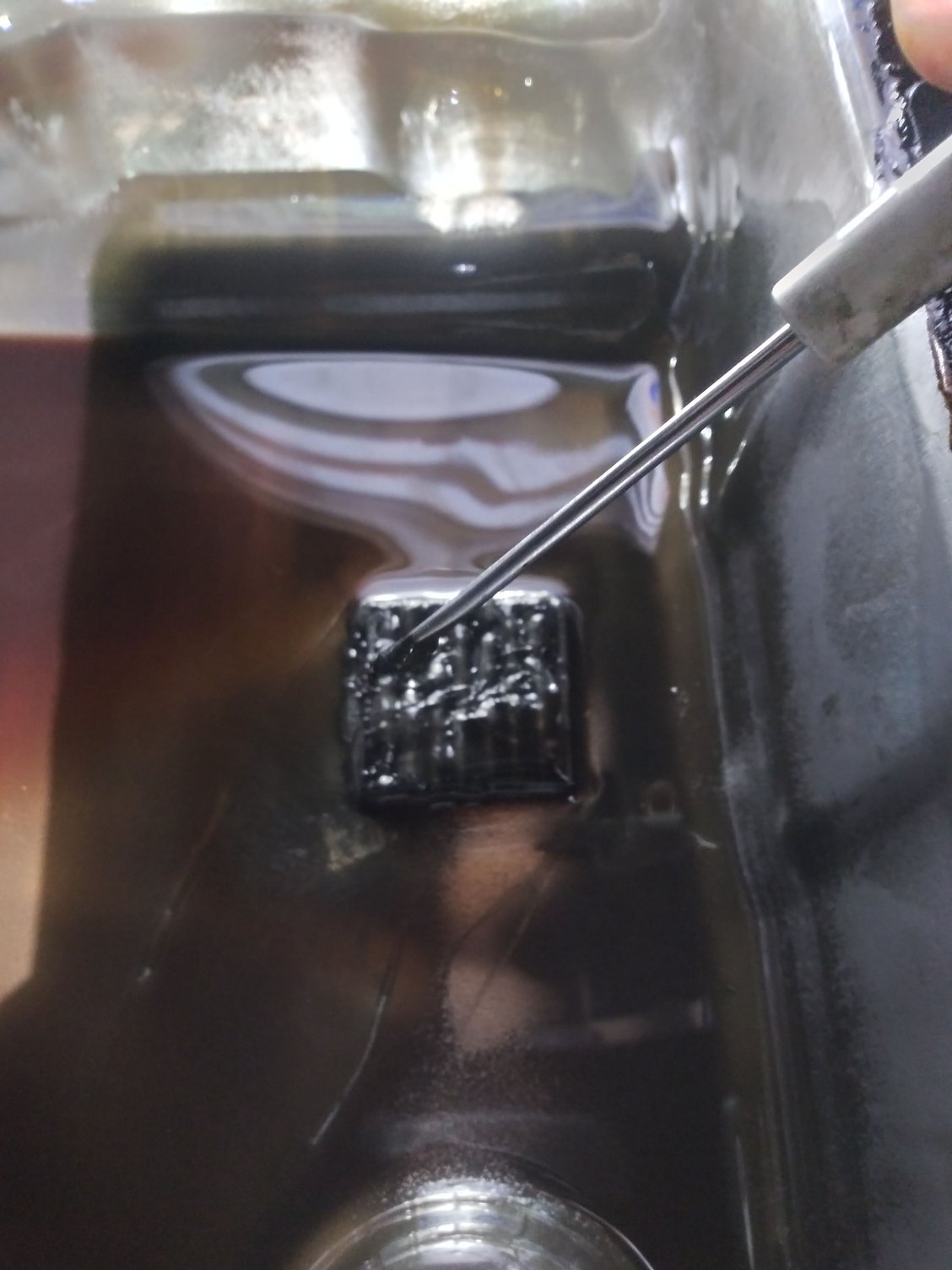

I never smelled any burnt smell even when I dropped the pan, but I see alot of metal tiny shavings and that gunk on the magnet! Mine has the transgo sk kit in it, so what I read, from other members saying that mine won't go into 3rd gear because I have the transgo kit , it just goes into 1st and 2nd and reverse . I did not disconnect the VSS, would that possible force it to go into 3rd gear to make sure it is toast , with the pan dropped it visually looks that way??

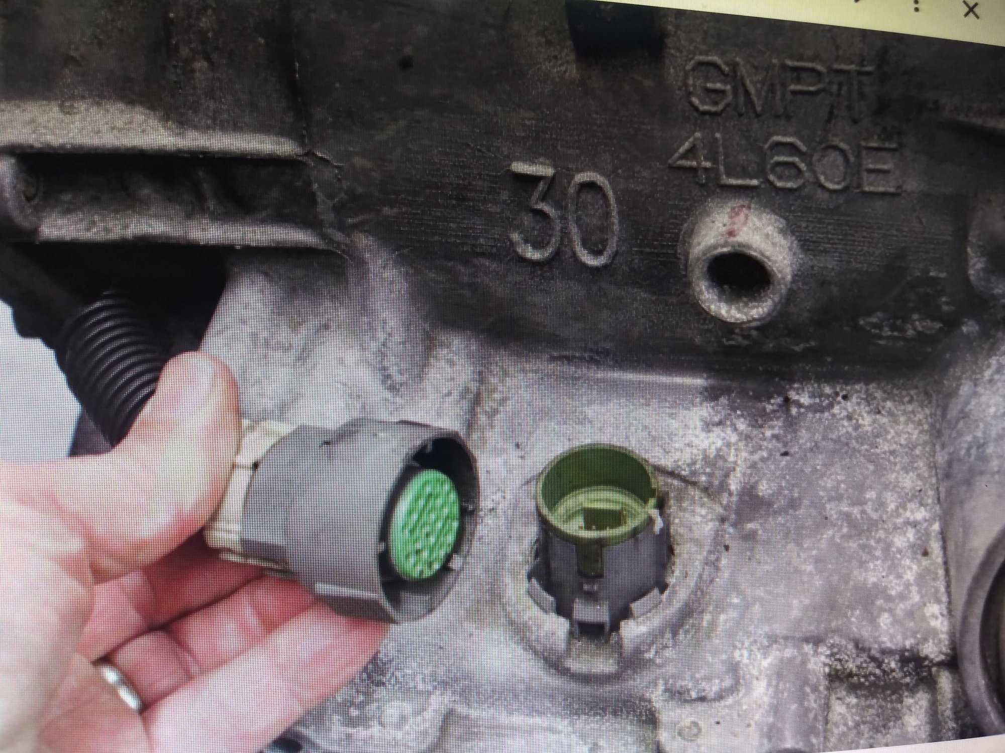

Disconnecting the VSS will only allow first gear. The VSS signal is required for the PCM to calculate the shift speed.
The only way to force 3rd. gear is to disconnect the main connector or remove the fuse. That takes the power away from the solenoids.
The TransGo Shift kit has nothing to do with the lack of 3rd & 4th gears. The TransGo SK addresses known problem area's, such as worn AFL,PR, TCC circuits. They also make changes to the accumalators for shift feel. There are thing's to look for the 3-4 clutch at or vacuum test on the VB for it too.

This is the connector I disconnected but only got 1st 2nd and reverse still
