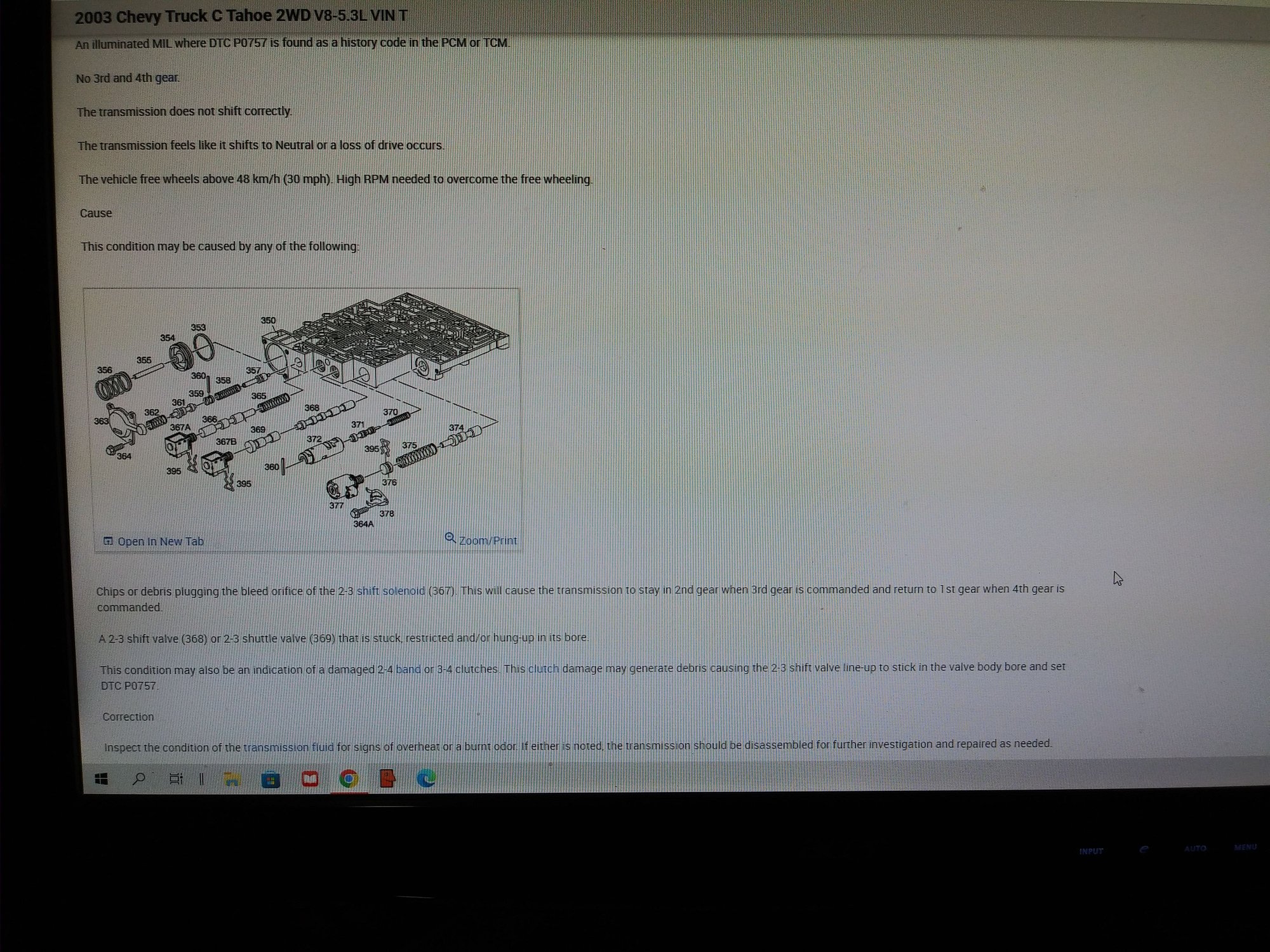

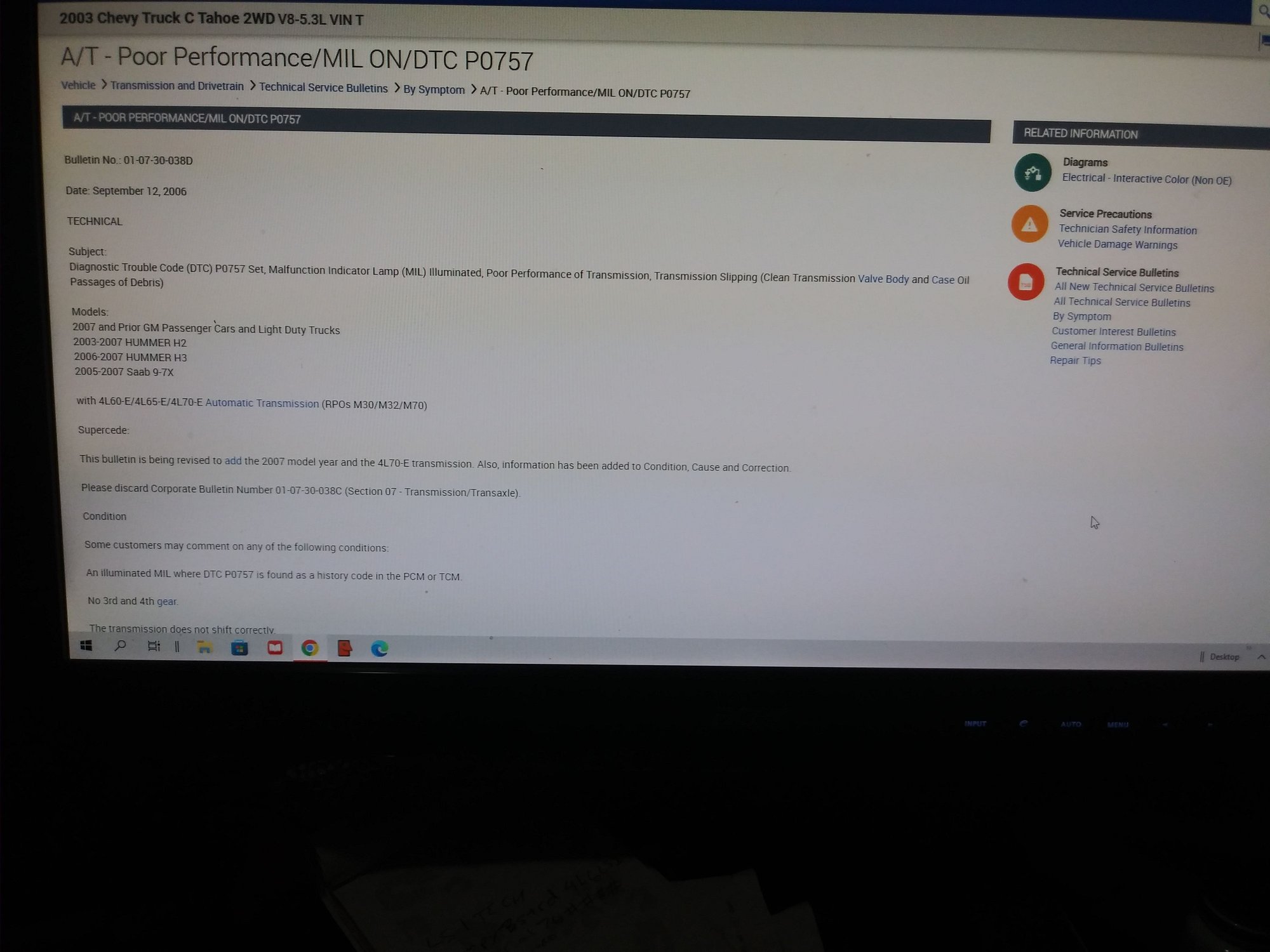

I did get codes! But because of the harness disconnected! Ok I found hopefully some helpfull info off alldata for help , Im new to this forum, so Im gonna try to post tech Bulletin and if it does not help me hopefully it helps others👍
Hopefully helps !👍

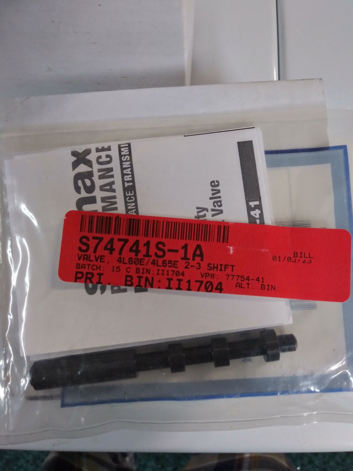

Lol ! Earlier today , I recieved this a sonnax shift valve 2-3 #77754 that I was already suspecting and had ordered last week and a servo kit 2nd gear and 4th servo here go pics.

Also it talks about solenoids . and man ,I wouldnt be surprised ,if some dam O-RIng might ,be the culprit 😐 or a solenoid screen fell off or its bad, also there is the manifold switch , etc more and more crap, oh well if not, its a transmission sooner or later for everyone 💣😈
