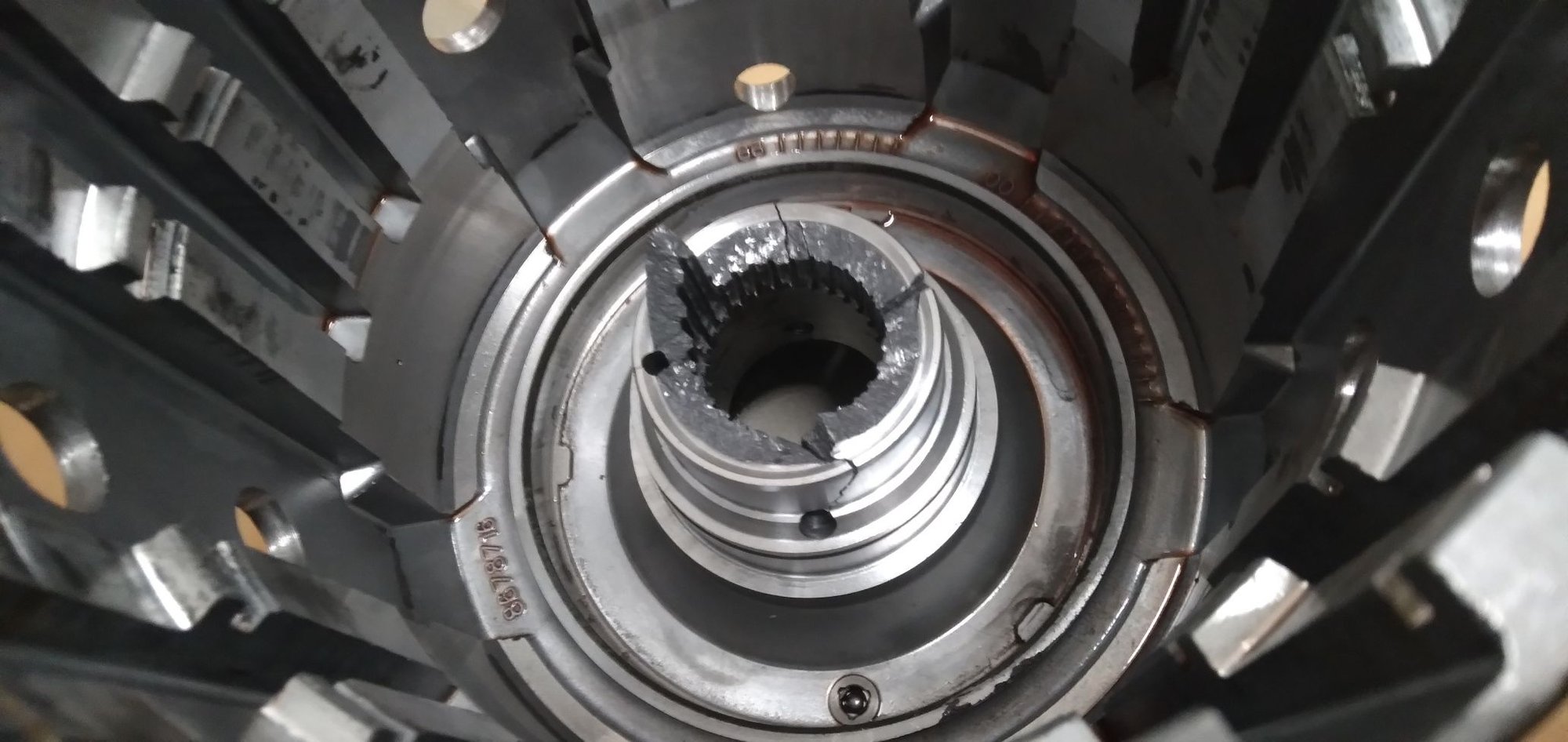

First time I have come across this. Just thought I would share. I believe it was behind a stock 5.3 in a truck.

Rather common actually...
Sonnax has made 2 attempts at "Band-Aiding" this.
They unfortunately are trying to treat the symptom instead of curing the problem.

Oh No
Better put a stupid sleeve on the piece of junk.
get a good drum and install as is.
You'll get to reading about the sonnax sleeves, and think it's your savior.
it's not
You're more likely to cause damage during the pressing on of the sleeve...take that times 2 if you use their new sleeve that goes down on a lower area of the drum
That 2nd sleeve sonnax released basically confirms what I've said in many threads. The original sleeve doesn't actually fix any problem. It just moves it.

I've installed ALOT of reinforcement sleeves. I've never had an input drum fail with a sleeve. I have had several split that did not have a sleeve. I 100% believe that its extra insurance. Is it the end all? Obviously not, after seeing the pic posted above. However, I have no doubt in my mind that I could easily split the hub in that drum without a sleeve if it were in my car. My setup is tuned to perfection I feel like in regards to shift timing, shift pressure and torque management. But no doubt, I'd split that thing without the ring.
I feel like this kid of breakage could happen if the endplay is too tight. Or maybe something in the trans or convertor was "walking". Maybe the "flex" plate was flexing too much.
I look at this a couple different ways. 1) the splined area that splits, certainly has to be weaker than the area shown above thats broken. 2) I install the input shafts with sleeve retainer. I feel like the sleeve retainer adds even more strength to it. I bet I'd bust the whole hub out of the drum before i'd break the part illustrated.
Would be nice if Sonnax would have redesigned the drum and changed how the 3-4 are applied, instead of using a flimsy stamped steel basket with fingers on it that relies on bends for strength. Other areas that could be improved but if they made a billet drum with redesigned (whatever) it would probably cost $1500-$2000.....and likely not be a hot seller.
