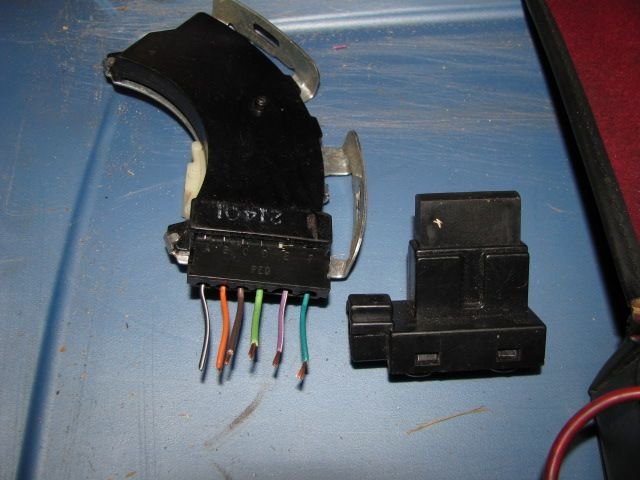

ah ha it is a 4l60e and I got a better look at it this morning. I see that the only wiring missing is on shifting positions. Driver's side. The guy that sold it to my friend is telling him that that part is not needed. It still seems to me that it would be. I don't think either one of them knows what they're doing. I'm not sure what I'm doing that's why I was asking you guys. I would like to get it done the right way and I will keep researching and I sure do appreciate all the help thanks

I bet they are giving you a 4L60E from a truck or SUV which has the electronic PRNDL switch that has neutral safety built into the switch. That said, no you dont need this switch to perform a swap. All you need is the round connector on the passenger side and VSS.
A truck/SUV shift shaft is longer compared to a car shift shaft. The cars didnt use the PRNDL switch but had neutral safety switch at the shifter in the console.

The F-Body cars did use a PRNDL switch, it is mounted to the console shifter. You may be able to find what you need on this site. www.lt1swap.com. If you don't use the switch on the side, you may have the jumper the neutral switch and you will not have back-up lights. Also, the ECM will not speed up idle when placed into gear.
