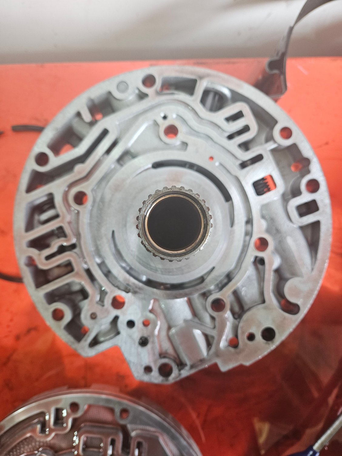

I have removed the pump and I am seeing no damage. Is there something that I should be looking for?
Also I should note that yesterday when I started it up to tow it in the garage, I put it in drive and was able to drive it in the garage. Once i got in the garage i put it in reverse and nothing. I put it back in drive and nothing again.
Thank you again for the help.

Are the input shaft splines stripped? What about the T-Case - are the shafts spinning as they should?

The threads look as they should. No wear. I have another pump that I am installing right now that I know worked when it was in the truck 2 weeks ago.

What do the drive lugs on the rotor's seal side look like?

The Pump's Maximum Main Line Pressure Relief Spring may be broken and the Valve (Ball and Seat) may not be sealing...

Threads? Do you mean splines? Also did you replace the EPC when you had it rebuilt?
As far as the pump you pulled, inspect the rotor carefully to see if there's any fracturing - also make sure that the slide support ring and cover are installed. Also check to see if the PR valve will move freely on its own or if it's sticking...An intermittent movement condition as you described in your post w/the pump pics is usually caused by a failing pump that's beginning to break up but yours appears to be intact. It can also be caused by a sticking or stuck PR valve. Look at the conical filter and its o-ring to see if it got pinched/torn (or if its missing).
Lastly, What about valve body tests, AFL valve specifically? 96-00 had more issues than other vintages w/worn AFL valves. I will usually bore/ream then for the Sonnax oversized AFL valve kit if the valve fails to hold at least 12 inches of vacuum. These aren't likely causing your problem but doesn't hurt to check if you haven't already and the trans is out and apart.
Reinstallation: Put 1-2 quarts into the converter before installing it back onto the trans (assuming it's not already full) and once on and fully engaged w/the pump, spin the converter a bunch of times until fluid starts to trickle out of the cooler line(s)...that will at least confirm it's moving fluid when converter is spinning. Then install it, fill w/fluid and do a line pressure test once back in and engine running...
Also, flush your lines and cooler (as well as any external coolers) to rule out any restrictions if you haven't done that already...Seen a few rebuilt transmissions have issues w/shifting/movement or even gear train failure due to lines and/or cooler(s) restricted or clogged by tons of clutch material and other contaminant.
