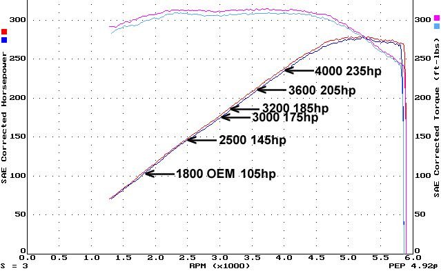

Rated stall rpm can also be called 'flash' rpm, where the rpm will immediately jump to when power is applied. Comparing the 2800 (165 horsepower) to the 3600 (205 horsepower), why waste time climbing thru the lower hp part of the powerband.

Originally Posted by FirstYrLS1Z
As in post #2, 3600 minimum from a reputable source. Yank, FTI, CircleD. No TCI, B&M,
And don't even contemplate buying a $400-500 converter, you want to be in the range of 800-900. Buy inexpensive and never be satisfied until you buy another one.
3.42s' and a Yank (or equivalent) 3600.
Excellent post, I agree. 3600 minimum for that setup, 3.42/3.55 gearing depending on which axle you install.
