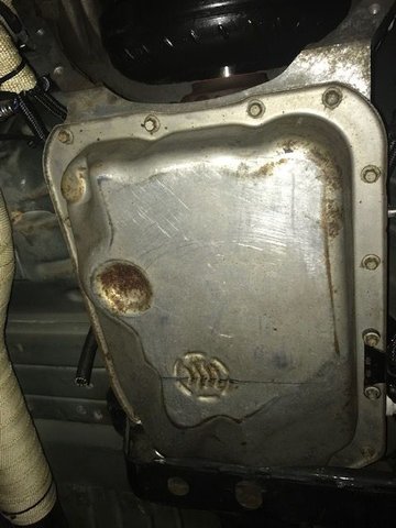

The 2004 with the 6.0 should be a 4L80. Have the junkyard tell you if it is or not. Look at the trans pan.
This pic is a 2005, 6.0, has 17 bolts
I wouldnt dare trust the words of any of the people that work in that place. I was looking it up online and I couldn't find a definitely answer because some sites show the 4l80 with the 5.7 and some show the 4l60 but the 17 bolt thing is definitely good advice. I'll keep that in mind when I go look
