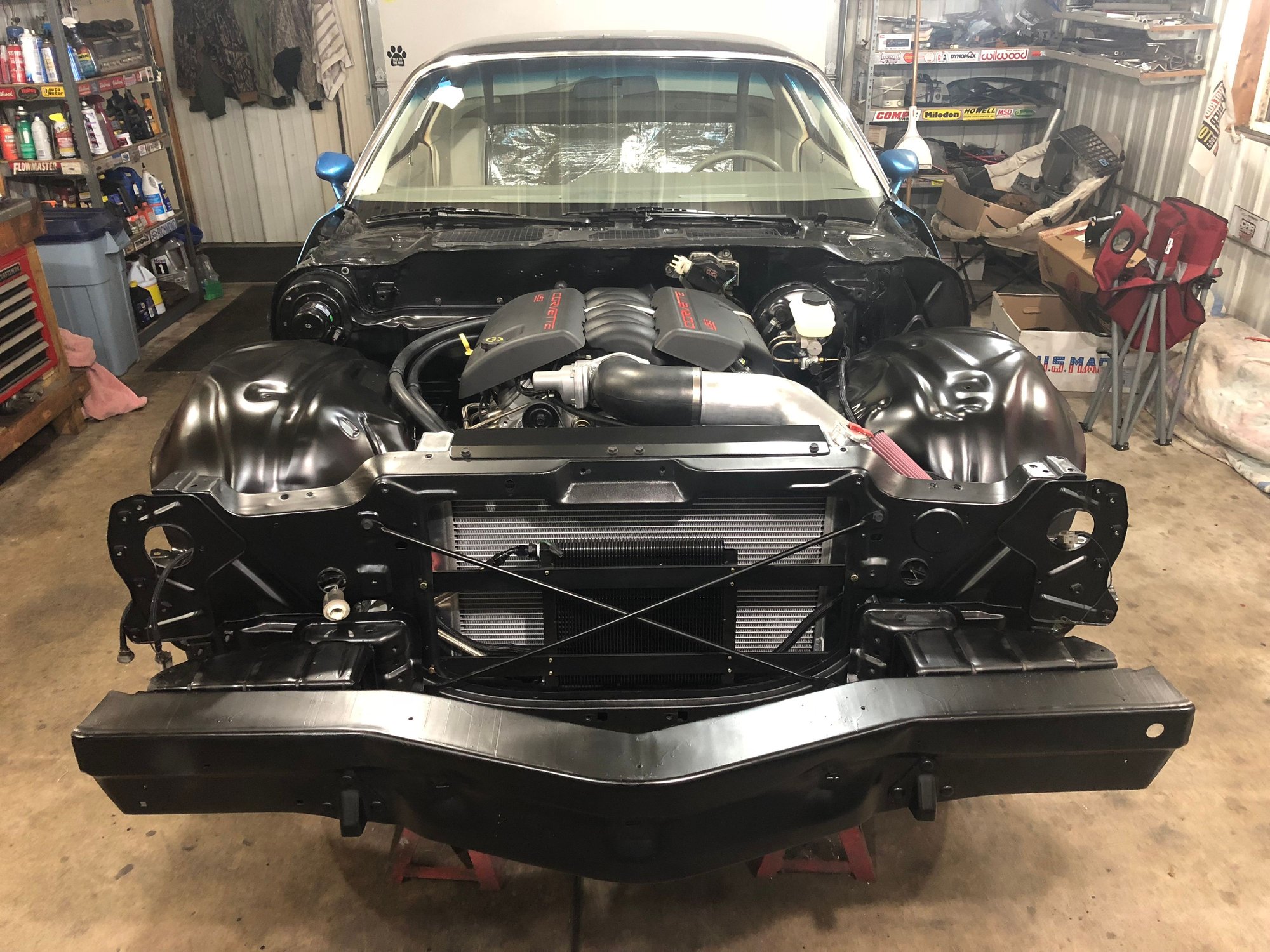

Not nearly hp wise as your hot rod but I have used the B&M stacked plate cooler on a few LS/4L60E swaps with great success. They measure about 11" x 11" cooling area.
Pic of my latest 80 project trans cooler set up. At slow speeds and higher heat times the electric radiator fan will pull air thru the trans cooler. The ECM controls the radiator on and off of the fan.
I wish I had that space! 11” by 11” is a luxury I don’t have in this car.
I have done similar setups to yours in the past and agree, that size cooler and location is great!
