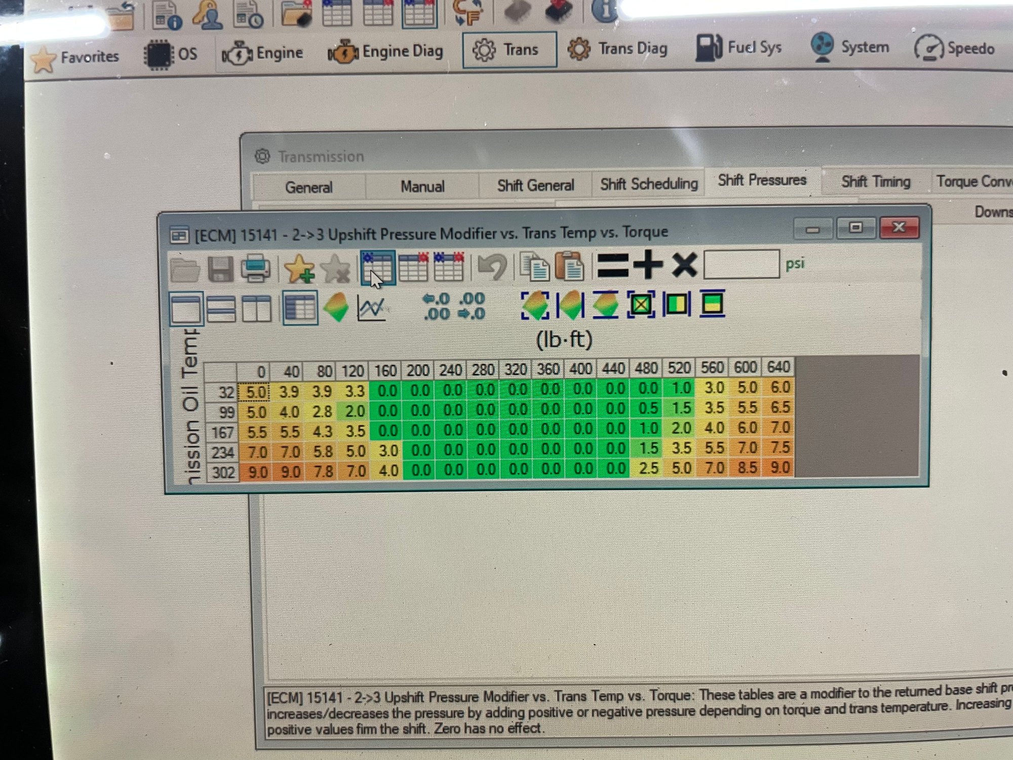

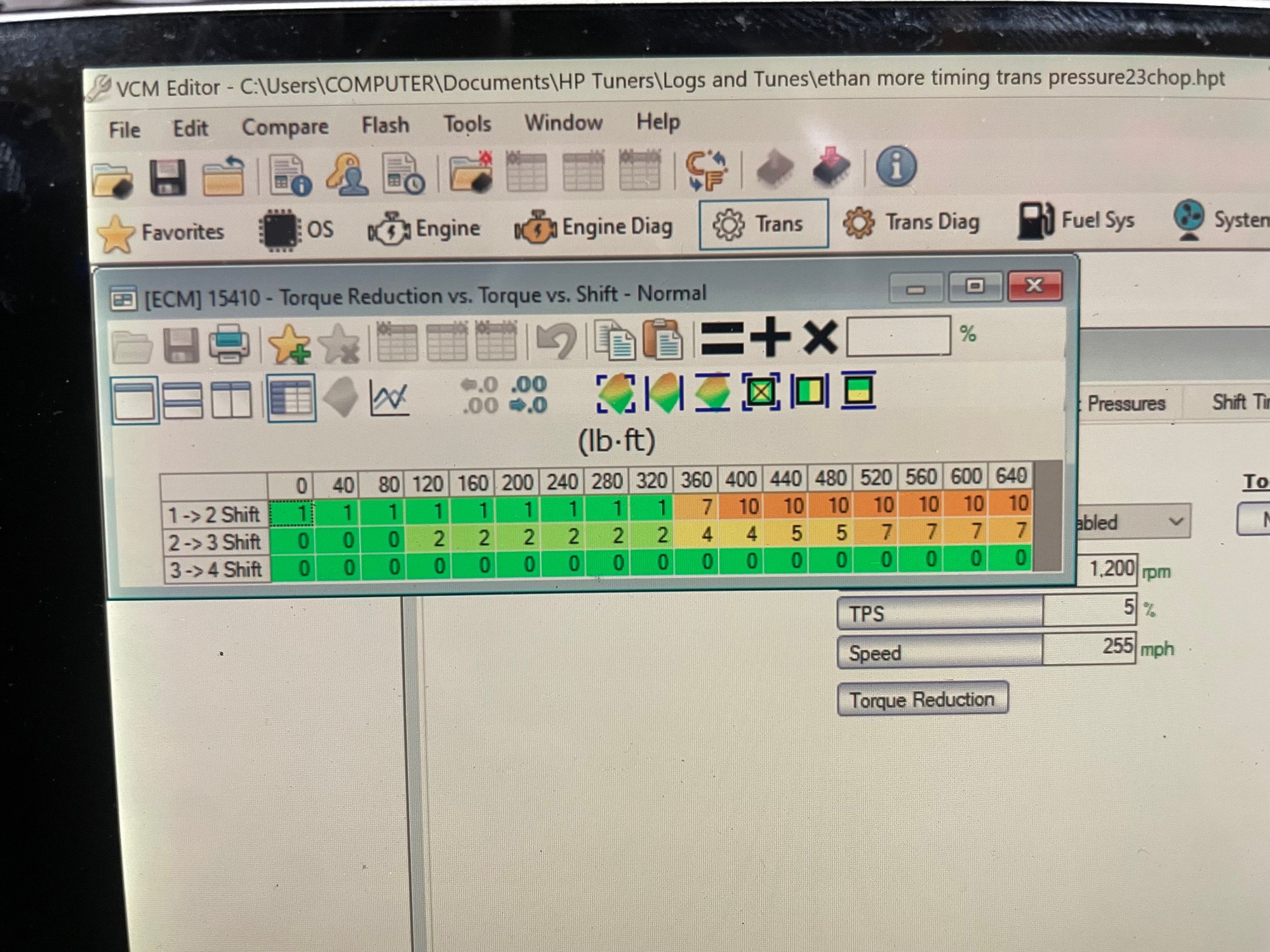

here’s some of my settings. Keep in mind this is a built trans. 4l79 drum, sonnax billet input, output, reaction, and overrun clutch hub. all leaks fixed, spacer plate drilled. Wide 2-4 band with new drum, sealed servo pin, corvette servo. I stopped using billet because they are too harsh. Basically it has everything you can do to it besides the sonnax billet gear carrier. 3200 stall

Thanks for uploading the pictures. I did a quick save of the pictures. I also did a quick comparison and it appears that I'm 90% there already with the Factory 4.3L S10 tune.

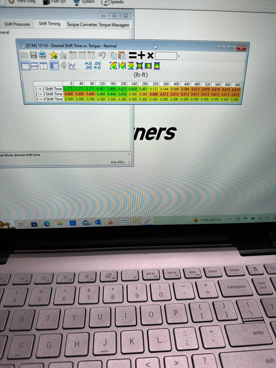

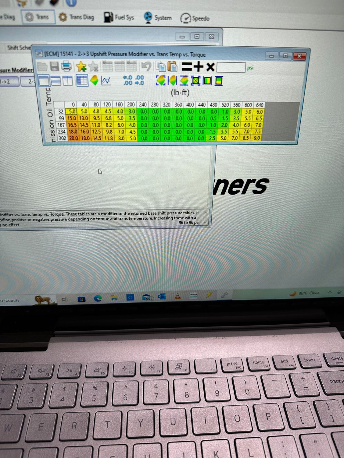

can you post pics of the same tables I posted so I can look at it. The multipliers can throw it off.

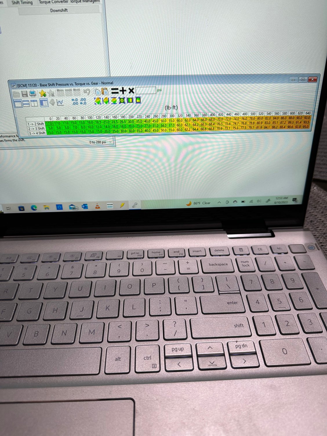

mine does not have the (ecm15150) table

you have tq management disable to zero. Yikes. That’s bad. Very bad. That’s what kills these transmissions. Whoever tuned it like that, probably should not be tuning. Copy what I have on mine for tq management, shift timing and pressures and then go try it. But never, ever disable tq management unless you just want it to break. Being that you are turboed, I’d probably add a few numbers to it. This is my sons NA table. My turbo car I have like 20 on the 1-2 and 15 on the 2-3 taken out.
