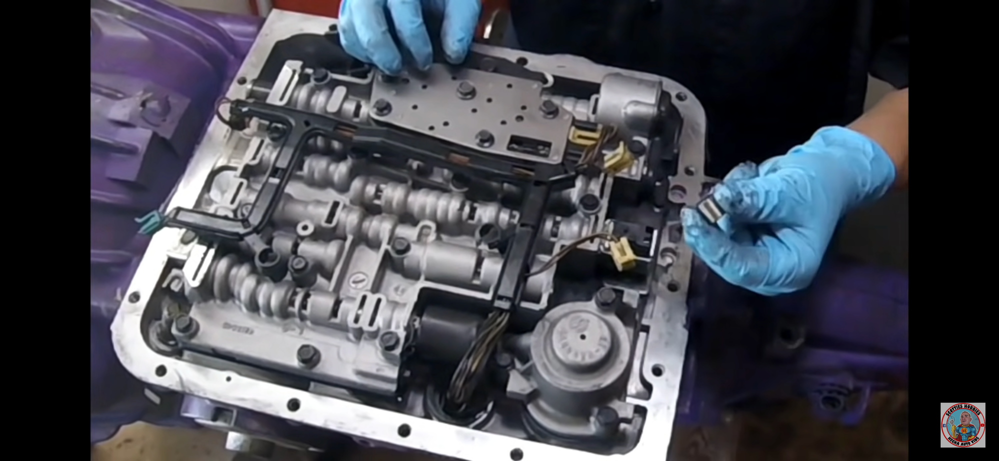

whilst watching an online video of how to test the solenoids, I noticed a spacer was removed from behind 1 of the solenoids. I do not have this spacer in my trans. I'm not sure if it's meant to be there and the guy I bought the car off lost it or its not meant to be there, but either way I don't have it. Could this be causing my issue?

If someone put the TransGo 4L60E HD2 shift kit in and left that sleeve out that could cause all your issues. That valve is for holding 1st to any speed or being able to shift to 1st at any speed. here is a copy of their SK instructions. See page 2 step 5
If it is missing you could probably contact TransGo and they may send you one.

I have actually managed to get it back together correctly and it's now shifting properly. It shifts to 2nd and then to 3rd at the correct time. The issue I have now, which is the issue the old owner had prior to stuffing around in there, is it's just basically neural in 3rd. It shifts into 3rd and there's no drive at all. I welded a bit on the end of the servo shaft as I have seen some do online, because when I pushed in the servo cover it went in approximately half an inch. But I have fixed the no shifting problem.
