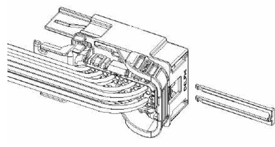

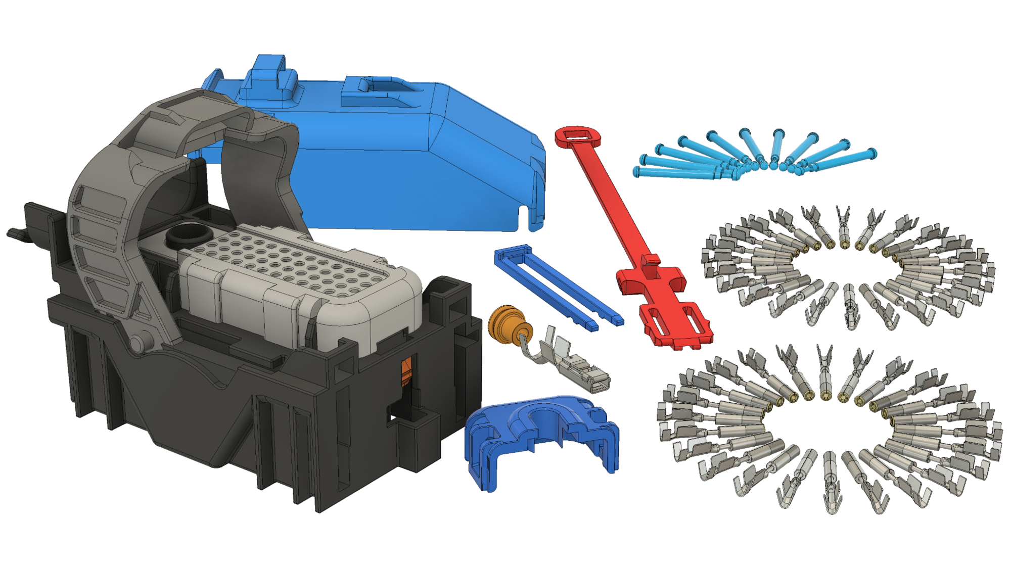

There are 3 TPA Locks to Remove:
-The Single Blue GT280 One-Way Blue TPA Lock.
-The Two-Pronged Blue (U-Shaped) TPA Lock.
-And the 48-Way Grey TPA Lock.
Once all removed, the Terminal Removal Tool can be inserted into the Front of the Connector Body:
The Tool needs to be inserted into the Opening-Space that resides and connects Two Terminal Position Holes together in a Small "Arch" shape:
The Terminal Removal Tool should be putting pressure against a Locking-Tang that Holds the Two-Grouped Terminals together.
At the same time the Corresponding Wire should be Pulled on from the Back-Side of the Connector-Body.

Removing the blue U shaped piece only gives access to the ground wire.
Removing the gray piece that is around the other 48 wires removes all of the wires and pins from the black piece. That would be a headache to try and get all of the pins back in the right holes. I released 3 of the gray snap locks and lifted it a little and saw that was not going to work. I guess I am ordering the GM pin release tool pictured. Maybe the China pin thing is not long enough. #^%&$&(^%%^#*^%#
