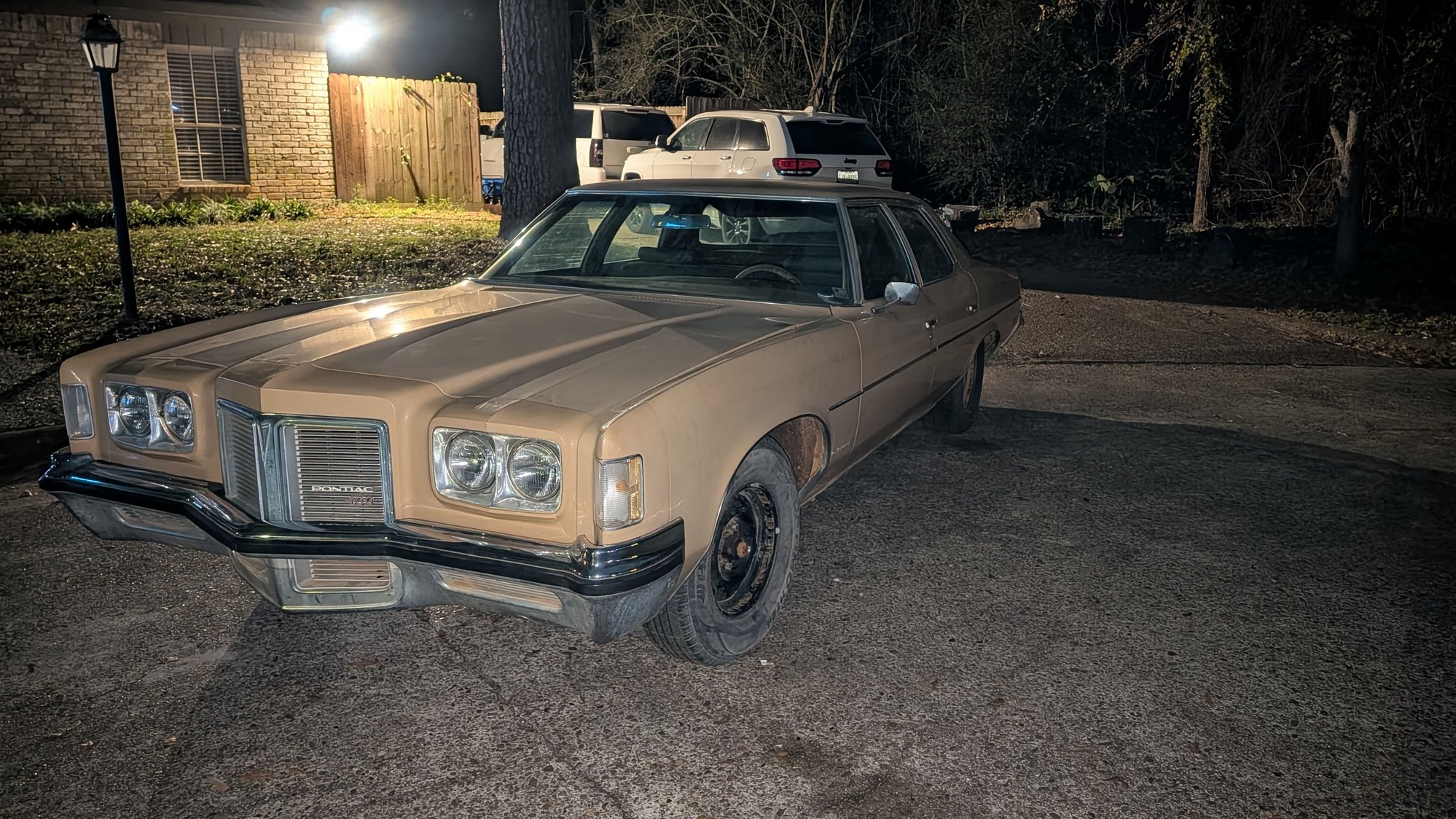

Been awhile since i posted here. Been building an engine for my truck, lots of time consuming hurdles. Everything kinda came together all at once and i ended up with everything i need to finish the truck engine, but......
I acquired a 1972 Pontiac Catalina 4dr sedan in almost great condition. In a barn since 1989 from the original owner with 73k miles, all original and intact except the seats and carpet.
Should i just get a junkyard 5.3 to put back in the truck and do the hard work of making this car suitable for a torquey 5.7 and 4L80e, or do the boomer purist thing and refresh the lazy Pontiac 400?

Pontiac has the basic 400 2bbl, my 2005 Chevy Malibu technically has more HP and torque i believe. Everything to really boost the Pontiacs power puts me at the same cost as swap parts when you consider machine shop time on the block and heads. Im not a purist, I only care about keeping the interior old car feel.

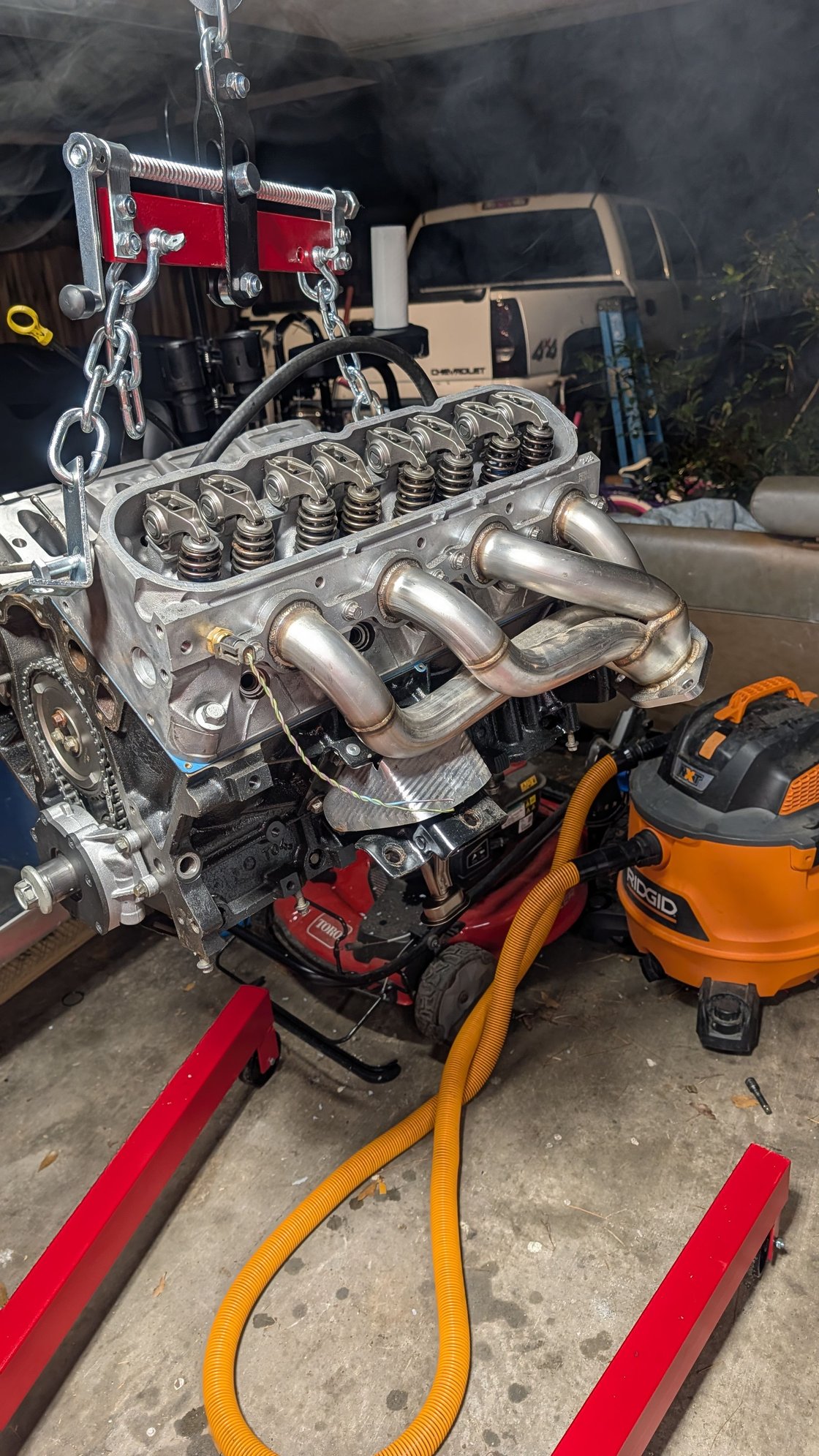

So, i have a fully built iron LS6 essentially but not a high revving one. The SUM-8718R1 cam, slight valve job, 5.7 flat pistons, should be good for lots of low end torque. I would need a new oil pan, figure out the accessories, HVAC is a must in Houston, I'd like to semi-daily this beast switching with the truck. New driveshaft, fully rebuild and regear the differential, motor mounts and fuel supply.
To do the Pontiac right, heads need alot of work to be good with ethanol. Threaded rocker studs, hardened exhaust valves, decking, the whole nine yards. Would be well into $5k just on the engine work and parts, thats me doing all the labor except machining. Then i need to refresh the transmission, which wouldnt be much being a TH400. It has goid compression on 7 cylinders, #2 is finicky. Itll sputter with fuel but most likely leak and smoke like a geriatric sailor. So i couldnt daily it without doing rings and timing gears, engine is fully disassembled essentially for that. Any modernizing takes a lot of work to have carburetor issues still just by design.
So, help me out here. My wife and daughters love the old car feel inside and out, they dont care for the poncho soul. I dont really either, i just think it looks cool and a great candidate for reviving. Got it super cheap. Could probably sell the complete engine and transmission for close to what i got the car for not including renting a truck and trailer.

Sell that 400 and drop a 5.3 with a turbo into that thing. Keep those rims on it too. A 1972 Catalina isn't a muscle car, and it's not suddenly a really valuable vehicle because it's got a 400 in it. Better yet, sell it to me and I'll make it run 9's, lol

Paint it black, throw some magnum 500s on it and call it a day.

Speaking from an economical point and a FUN/HP per dollar spent.... Why would anyone keep the old pontiac motor? Makes no sense to me. It will cost 5x what the LS 5.3 will by the time you get the dated motor machined with updated parts to be anywhere near the LS. Not that it can’t be done, but why would you want to? What difference does it make where the power is coming from once the hood is closed? What kind of power goal do you have?
Those 400’s were really anemic. 8.2:1 compression and had 175hp 2bbl base version and a 200hp 4bbl version. Even with basic upgrades I don’t think it’d hang with a cheap LS.
A $300 4.8 with a cam will walk circles around it. 5.3 even more so.
If drivable, I’d cruise it as is with the driveline FS. Might get lucky. Then put something fun in it. There’s enough room under that hood for 6 turbos. I saw a guy put 2 V8’s inline under that hood!
When It comes down to HP per $. The turbo is simply the correct answer. $300 motor with a $200 turbo running 6-8psi (no intercooler necessary ) will make every bit of 500hp+ with any small bore LS and a cheap cam. There is no cheaper way to make that kind of power I’m aware of. And you’ll want it with a 5000lb beast of a car.
Just my .02 anyway. Super cool car BTW, love the old boats!

I have the iron LS6 still hanging. I would need to get a 4l80e preferably, would need to regear the diff, wiring harness, get an ECU tuned, theres quite a bit involved with the LS swap. Talking purely fun per dollar spent, would be more fun getting it going without changing anything. Just reviving it and driving it would be the most fun.

The engine I have hanging should be 400hp/tq at the wheels once its in my truck. And should be all midrange power. Its just a big endeavor is all. Not against it entirely, i still think i should atleast get the original setup running and driving, so maybe itll remind me how much carbs suck and fully motivate me for the swap..
