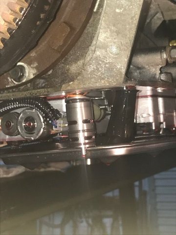

Originally Posted by FranksCustomTrans
If you have 0 presure one of three things it can be, Wrong converter not engaging put (very unlikely) Broken pump (Probable) PR valve snap ring was not seated and blew out of pump. I would drop pan look at that first since got to drain anyway , Then if its not that start pulling it back out to inspect pump . Those are the only things short of no fluid in trans that could leave you with no line at all .
DING DING DING !! Snap ring in the pan and PR valve blew out. THANKS!!

Snap ring goes back on such that the flat side of the snap ring faces away from the boost sleeve.
OEM part number for the snap ring is 11503348 if the one you have is messed up.
