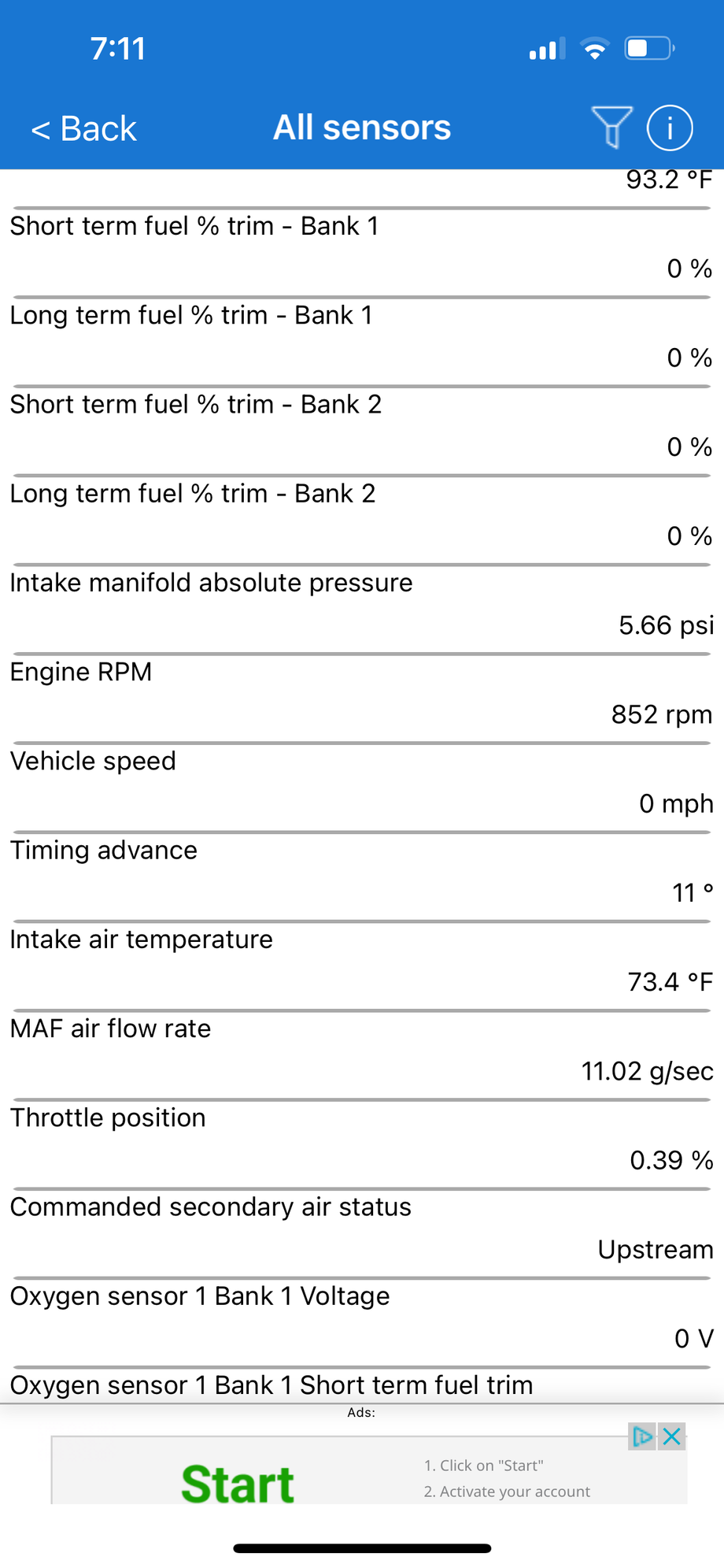

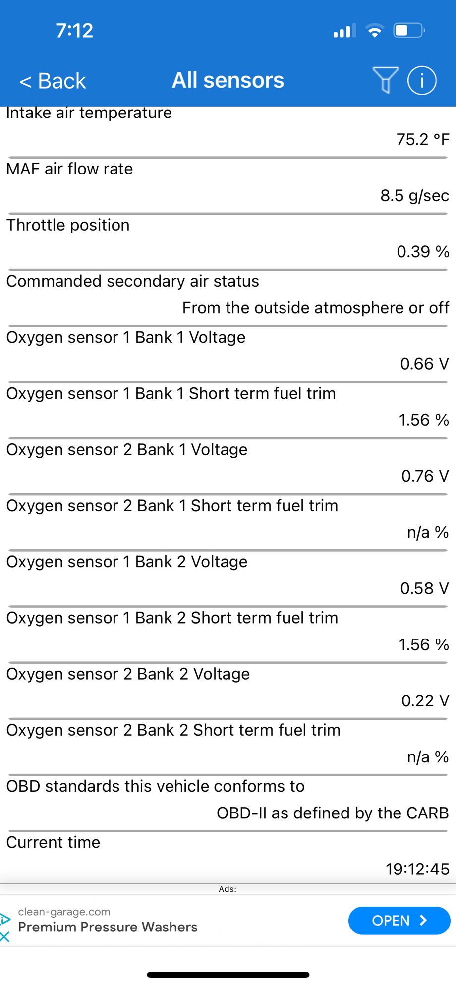

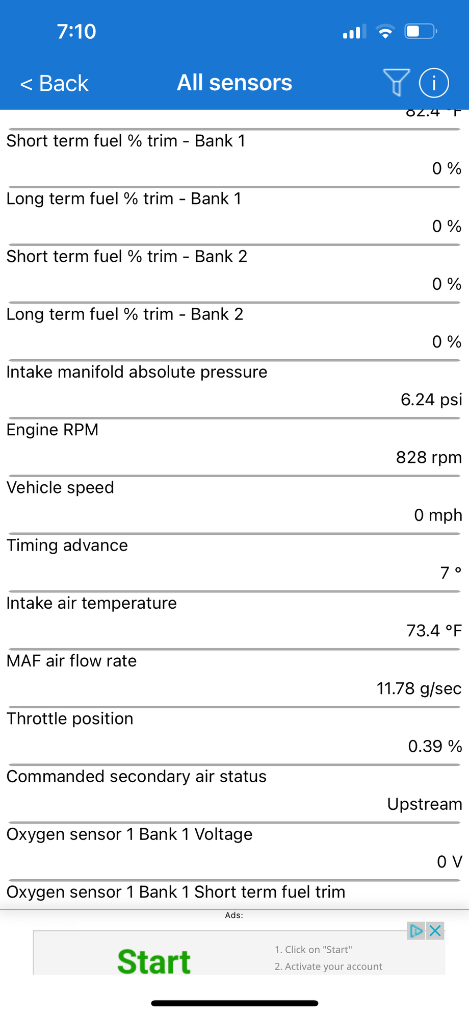

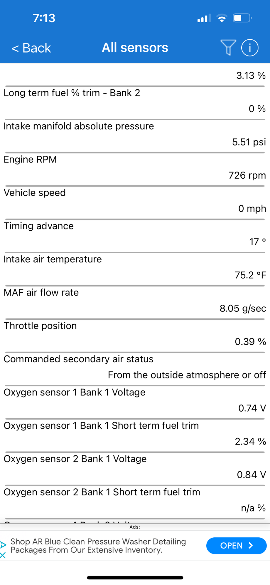

My OBD dongle came so I hooked it up to see what I could find out and unfortunately it says there aren’t any codes. I’m not sure if the free app that I’m using will read transmission codes or not but I thought so.
As far as the data goes I don’t know what I’m looking at or for really. It says the TPS reads .39% at idle. Is that the same as “0” as far as the ecu is concerned or is it supposed to read 0? What am I supposed to be looking at as far as MAF numbers? The cold idle doesn’t seem to be as smooth as it should be but if you weren’t looking for it you probably wouldn’t notice. I sure was hoping for a code. I’m not sure what to do next.
