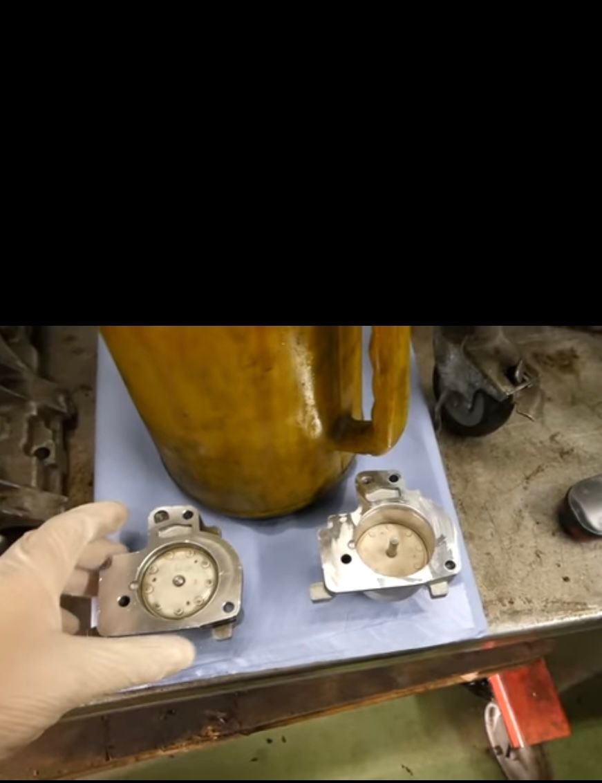

This is a screen shot of a YouTube video. Is the accumulator on the left bad & the one on the right is good? The youtuber says so.. When I took mine out to replace the EPC the accumulator piston was “out” like the one on the left. Is that my problem? It also rattled. Would a bad accumulator even care if the fluid is hot or cold?
Is the one on the left messed up based on where the piston is?

I dont see any wrong as such with either accum, the one of the right appears to have eitehr a missing or broken spring
OUTTER SPRING
Amazon Amazon
inner spring-
Amazon Amazon
And I would if you have the plastic one replace the piston -
Amazon Amazon
You should be able to have all of this in a couple days from amazon.
OUTTER SPRING https://www.amazon.com/ACDelco-24219...ps%2C84&sr=8-1
inner spring- https://www.amazon.com/ACDelco-24220...ps%2C84&sr=8-2
And I would if you have the plastic one replace the piston - https://www.amazon.com/4L60E-Accumul...ps%2C88&sr=8-9
So it doesn’t matter if the piston is all the way flush with the edge of the housing? The picture of the new ones has the piston recessed a little and I think mine was pretty flush with the housing.
Would a bad accumulator only shift hard when the fluid is cold? If no, where would you look if you have a hard 1-2 shift only when cold?
Accumulator is fine , likley places to look are PCS or AFL valve leaking
