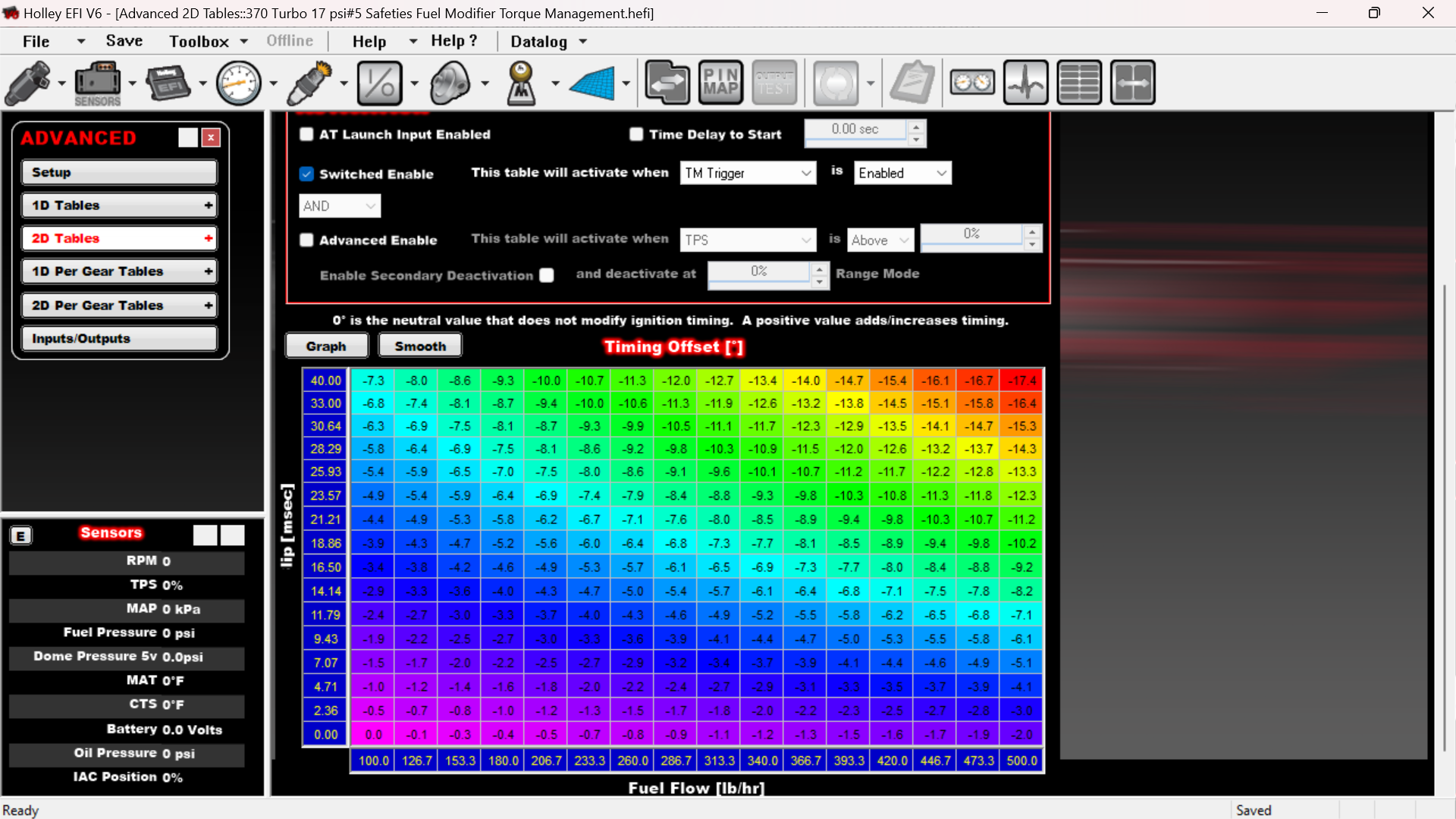

I've been hearing this a bunch lately when tuning the transmission. It seems like a real he said she said topic. Is it a good idea to utilize TM if a guy has a built transmission??
Definitely would like to hear some opinions on this. If anybody has a link to a video or article on this would also be great. Thanks guys have fun

It's a summer car that sees streets and track use and a bunch of highway roll racing. There's maybe 3000ish miles on it currently I would definitely like to see it get many more miles before it needs more work.
Engine and transmission are both controlled by a Holley Dominator. I do have some custom I/O setup with tables for TM

Hahaha okie dokie. I do have some custom I/O setup in the Holley EFI software for TM. I'm only just seeing that this is a thing. I haven't even glanced at it until now. If it'll prolong things then absolutely I'll implement that

i am referring to the torque management as GM calls it, which pulls timing on shifts to soften the hit on the internals of the transmission.
aftermarket ecus may be calling something else torque management. my haltech's 'torque management' is a drag racing launch system, so not relevant to what i said earlier

Holley calls it Torque Management too, I have a timing offset 2D advanced table where X = Fuel flow Y = Tans slip

Torque management is a pretty neat system.
It basically takes your high hp engine, and for JUST a split second, turns it into a gutless turd while the shift occurs, then once the shift is complete, the engine is back to full power.
We can get into a lengthy discussion about apply rate, friction coefficients dynamic vs static, pressures, etc
But the gist is: Most of the wear and abuse happens during the shift itself.
So if you can make the shift happen at 200hp...then once the clutches are clamped give it back to 1000hp...it will live ALOT longer
And unless you're trying to really fight for E.T. at the drag strip...it's going to be inconsequential to how fast the car feels.
We're talking .050 seconds that some timing is pulled.
Trans will live longer and you won't hardly notice it's even happening if the tuning is done right.

Perfect. That's pretty much exactly what I'm looking for! I'd rather make things last then empty my wallet at the Trans shop
