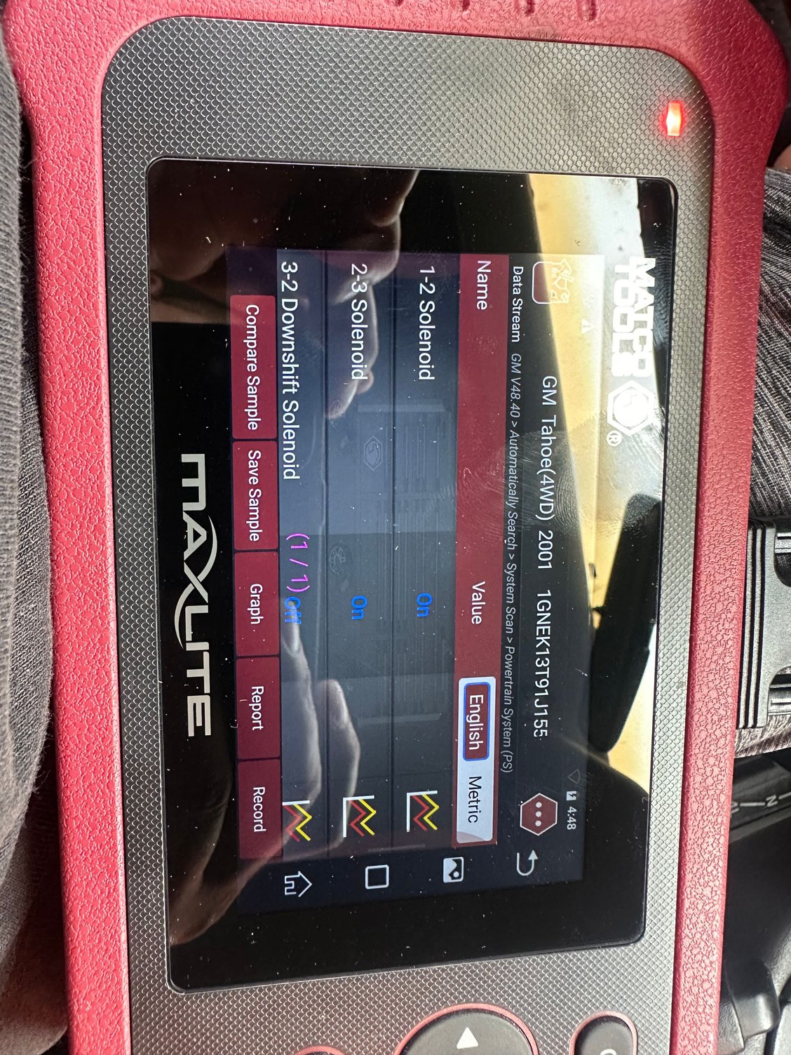

Ok so in all gears R, N OD, M1 I have about 60 at idle then jumps to like 210 when I blip it for line pressure.
I see no codes.
but I do see 1-2 and 2-3 are both on?

Vss is working… dang it
so it’s taking off in 2nd when placed in what I assumed was L1
but it’s in a 2000xj. Will not manual shift into 3rd from there.
when placed in D it goes into 1st gear but doesn’t move.
1-2 solenoid turns off when placed into L1 giving me second gear.
