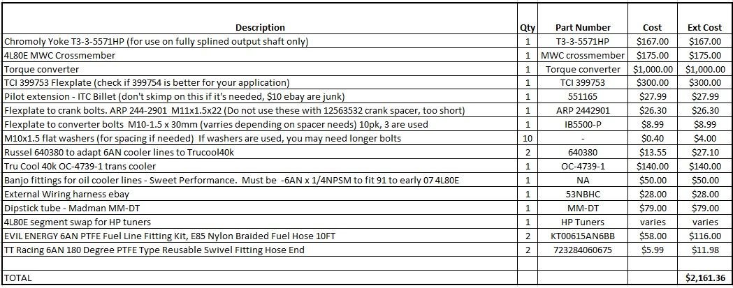

Rough example of cost to swap a 4L80E into an F-body that had a 4L60E in it give or take +/- 500 depending on torque converter selection.
Sure you can get a junkyard 4L80E, throw a transgo in it and hope for the best with a used compatible stock flexplate, TH400 stock yoke, cheap hayden cooler and some cheap off the shelf converter in it, but not something I'd personally do.

ive always used oem 60e flexplate/bolts with an 80e you just need to order the correct converter for that
