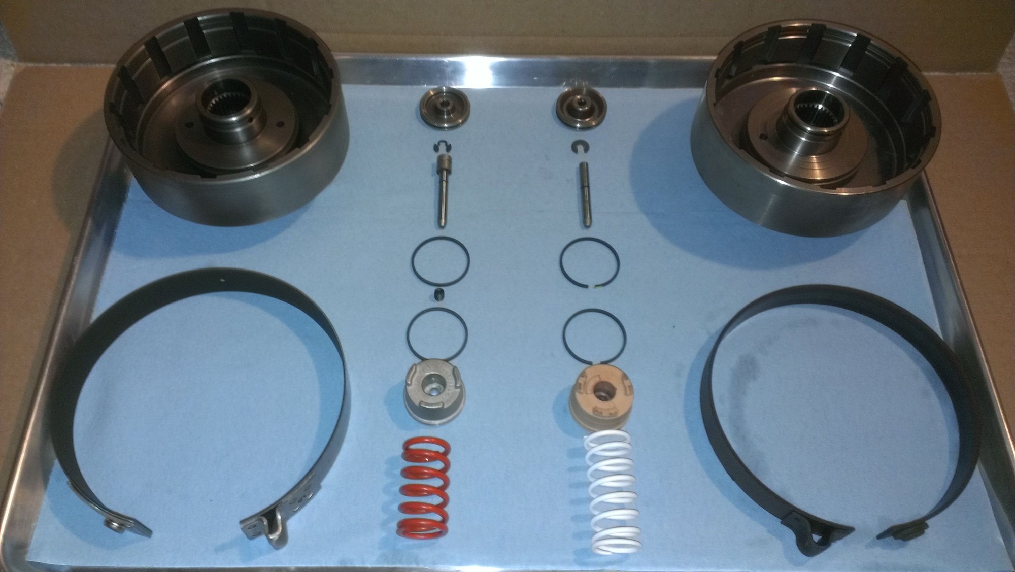

I forgot to Post an Image of the Components being discussed.

Originally Posted by jakeshoe
Leaving the spring out of the 3rd accumulator in the VB does not do the same thing as blocking the feed.
Blocking the feed also has the additional advantage of killing a potential crossleak.
And let's just give a generic .110" converter feed size and not take into account any of the other factors involved like input shaft orifice size, etc. Great plan!!!
Jake again I have no interest in arguing with you. I am perfectly aware they are not the exact same thing concerning the ACCUM. But I am helping what is obviously a novice builder. So The advice I give is based on the IDEA of simple things he can do without a great amount of explanation. I am not teaching a build it and learn all the tech class here. Just what I hope to be helpful simple things.
As for the orifice size again I gave a range as did others. He chose a .125 size. Not sure what your issue is I do not bother with you or your customers when they post here I just leave them till when and if you see them .
You are more than welcome to hang in here and teach a class on the complete details of each and every mod you do and why and how. I am sure it will be informative and interesting.
I do not have that level of time but do like to help when I can. And I am sure and think many here will say I have been a big help on numerous occasions. Both recently and the last 20 years .
Like I said I have no issue with you. You do you. i'll do me. Just like the others here Vortech and transguy etc I give help when I can and tailor it to what I think is the understanding level of the individual I am talking to. Without getting into the extreme details . Each of us put forward our ideas and we pretty much do that in peace.
You wanna add you 2 cents like everyone else GREAT you are welcome to.
But again leave me be and i'll do same for you. I am not here for drama in fact that's the last thing I ever want at all.
Once again have a nice day.
Thanks Vortec very cool. I do like this idea and way of doing this , may look into incorporation in my next 400 build.
