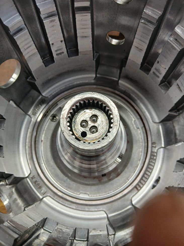

I am wondering how these 3 checkballs function. Even on a good shaft I see no movement out of them. Does not make sense to me that they would bleed fluid, I am guessing it is a way to seal the holes after the machining or casting process?

They're not checkballs, they are just plugs. That's how they plugged the oil passages after they drilled them. If they are loose or move around throw the shaft away.

If they are loose (which I have never seen) re-stake them. Problem solved.

No! Just re-stake them. You are making much more work here than necessary.
