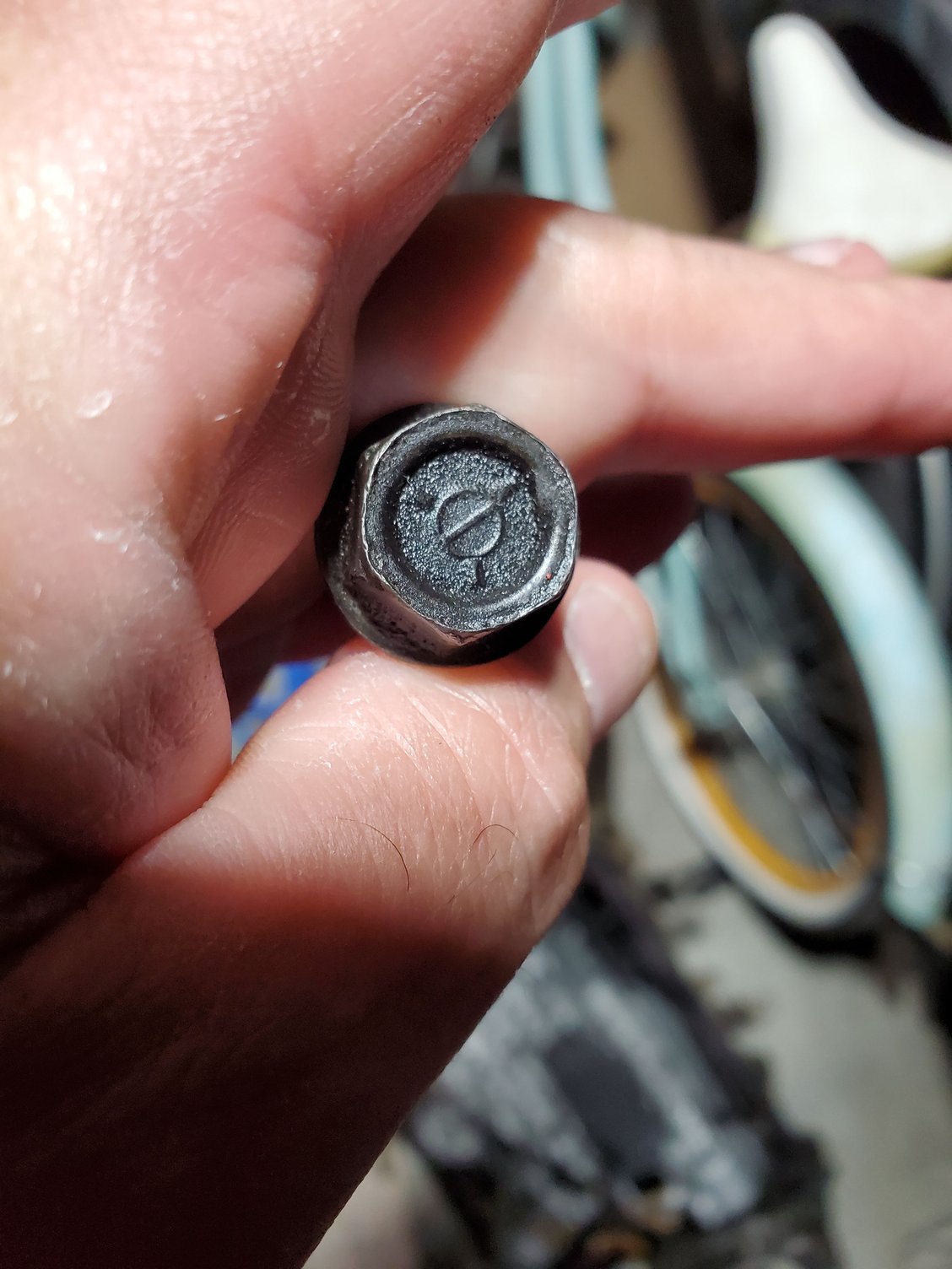

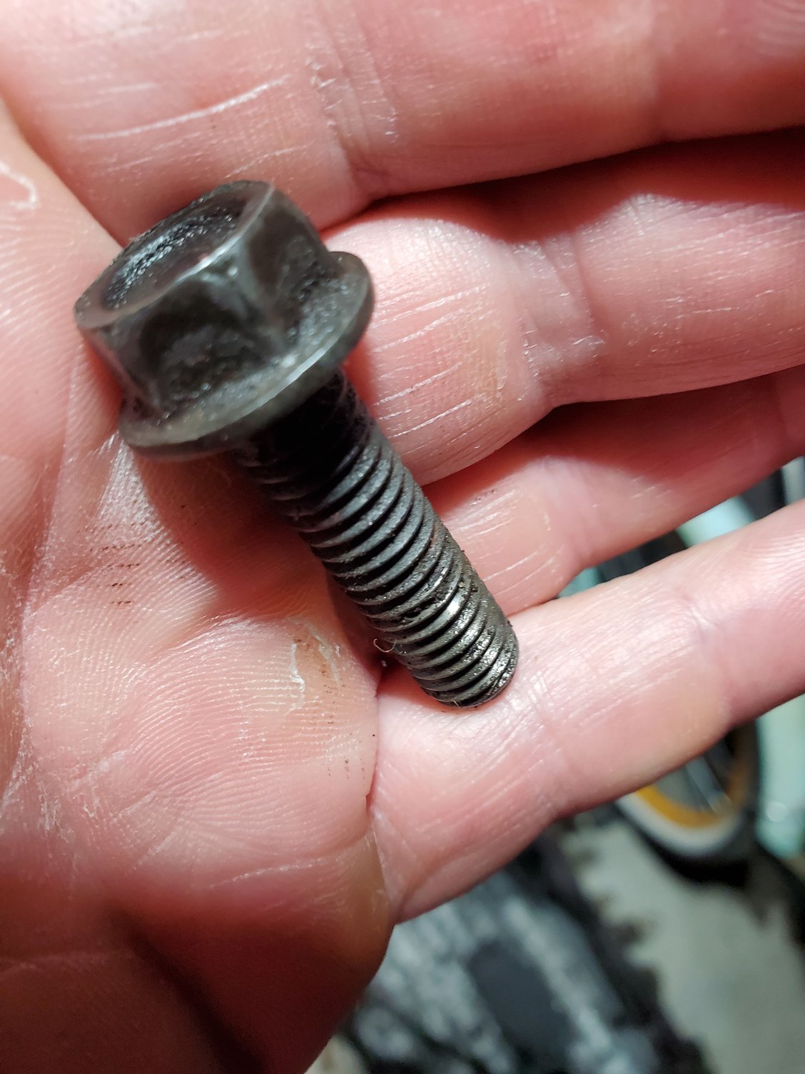

Anyone have a picture of the stock 4l60e bellhousing bolts for an LT1? I'm getting ready to reinstal mine but it only had 4 bolts holding it in and im not sure they were correct to begin with. I know it needs 6 so looking for best place to get replacements or does anyone recomend a better replacement. Im posting what i took out. Transmission was replaced before.
This is what i took out
No shank under head. Threaded full length.

I know they are 3/8 16 thread with 9/16th head but not sure on length . You should be able to get some at local hardware store. Just take one to match. They do not have to be grade 8 but I usually get grade 8.
Shank is ok too as long as not longer that the thickness of the trans bolt flange

Ace Hardware, Home Depot or Lowes should have a bolt that will work. I like to use a lock and flat washer when not using a flange bolt. You may be able to find a flange bolt. If not just side on the washers and then match up the length to the old bolt. A shank on the bolt is okay as long as the shank doesn't stick out the backside of the bellhousing bolt hole.
