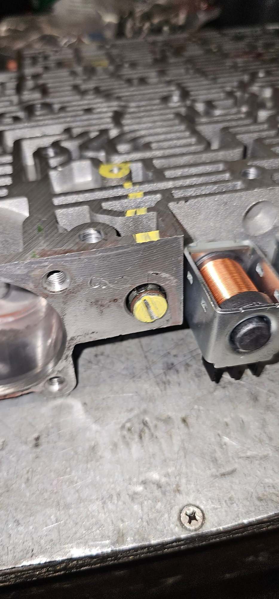

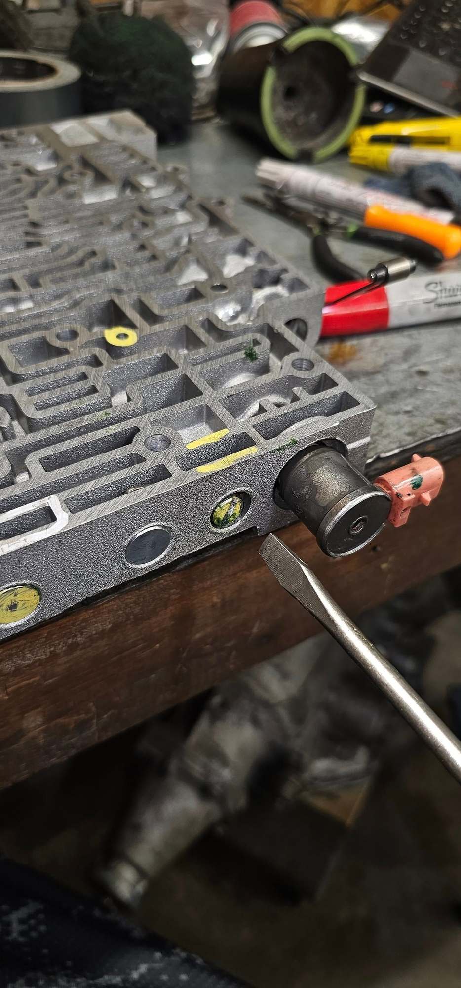

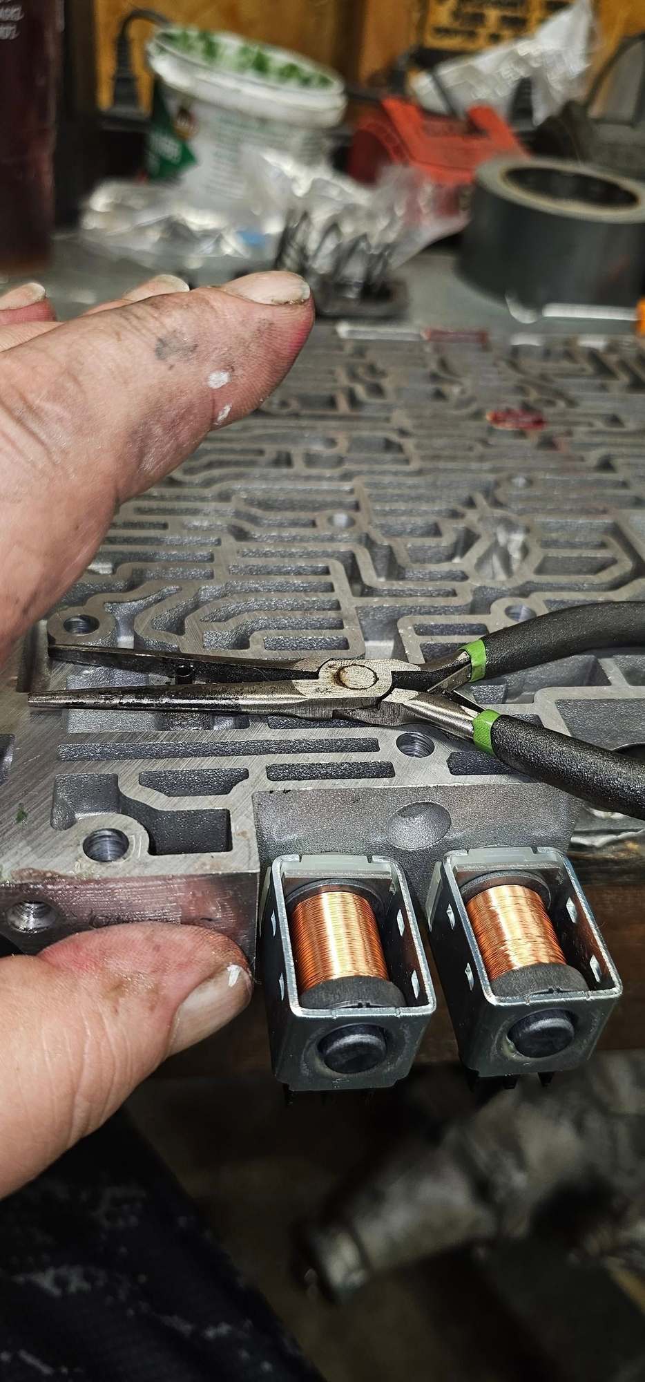

SHIFT KIT INSTRUCTIONS
Remove the fwd accume cover and replace accum with metal one, Remove rev abuse spring and valve.
Use a pocket screw driver and push roll pin from botom enough to eb able to grab it from vb top. place thumb over hole and remove roll pin. Remove old bore plug and push inner rping and valve back into bore. If you have one use a pipe brush brass to quicky debur bore on drill or drimel . blow out hole.
grease and install new plug oring to outside with flat head screw driver narrow enough to slide all the way to spring in bore. Us gentle twistng motion with gengle force till in place then roll then reinstall fwd accum spring, abusevalve aand sprng , install cover.
Remove sol 2-3 or B and remove two valve by tappng valve body gently on table, Install new 2-3 valve (note spring should be on valve but if came off insatll as shown and it has a slighly smaller end tha goes toward valve. install outer valve and install solenoid and clip.
Remove roll pin for accum with flat head through the bore end and then use hooked pick to pull accum out, (note if stuck or really ahrd to remove skip this step its no worth damaging body over )
Check that valve moves in sleeve good and the add longer spring included to the existing spring and the  reinsatll accum assembly and roll pin

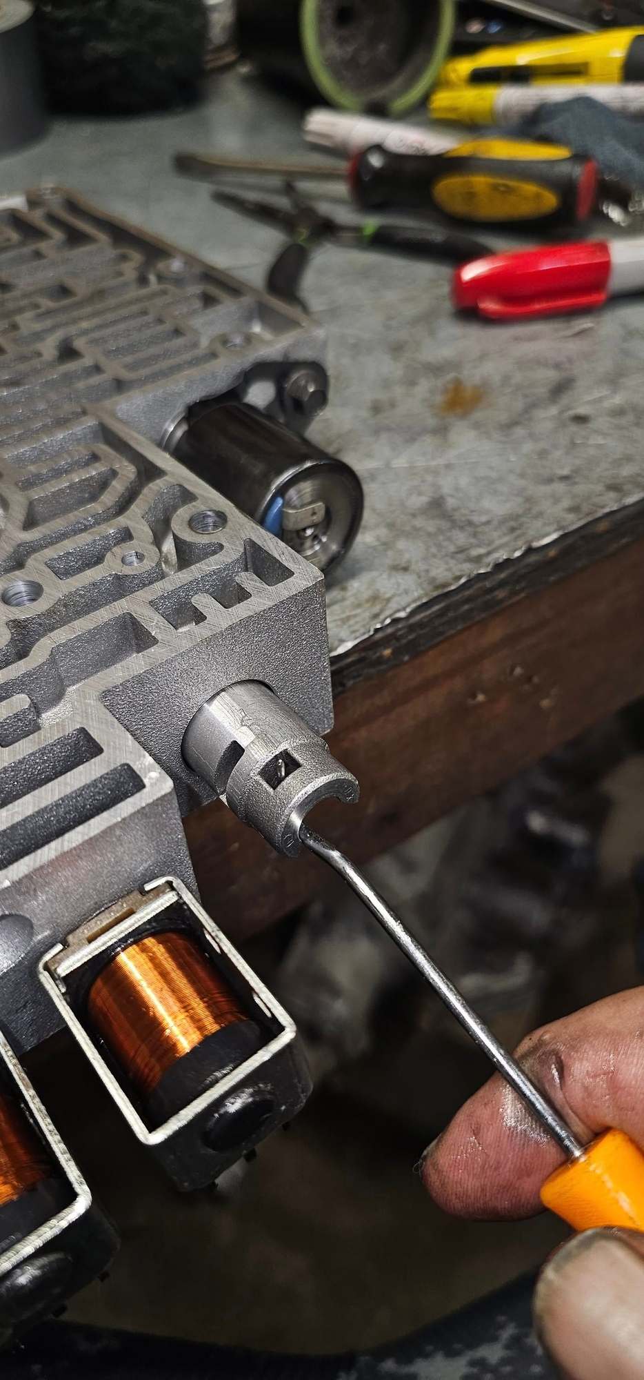

AFL VALVE With thumb over hole remove clip , end plug , spring and valve . Install supplied valve its .001 oversized so may drag some thats ok and then reistall spring and end cap then clip , its all kinda stiff .
When removing PRESURE SOL note how bracket is positoned and direction
If you like use screw driver to check AFL motion its stiff

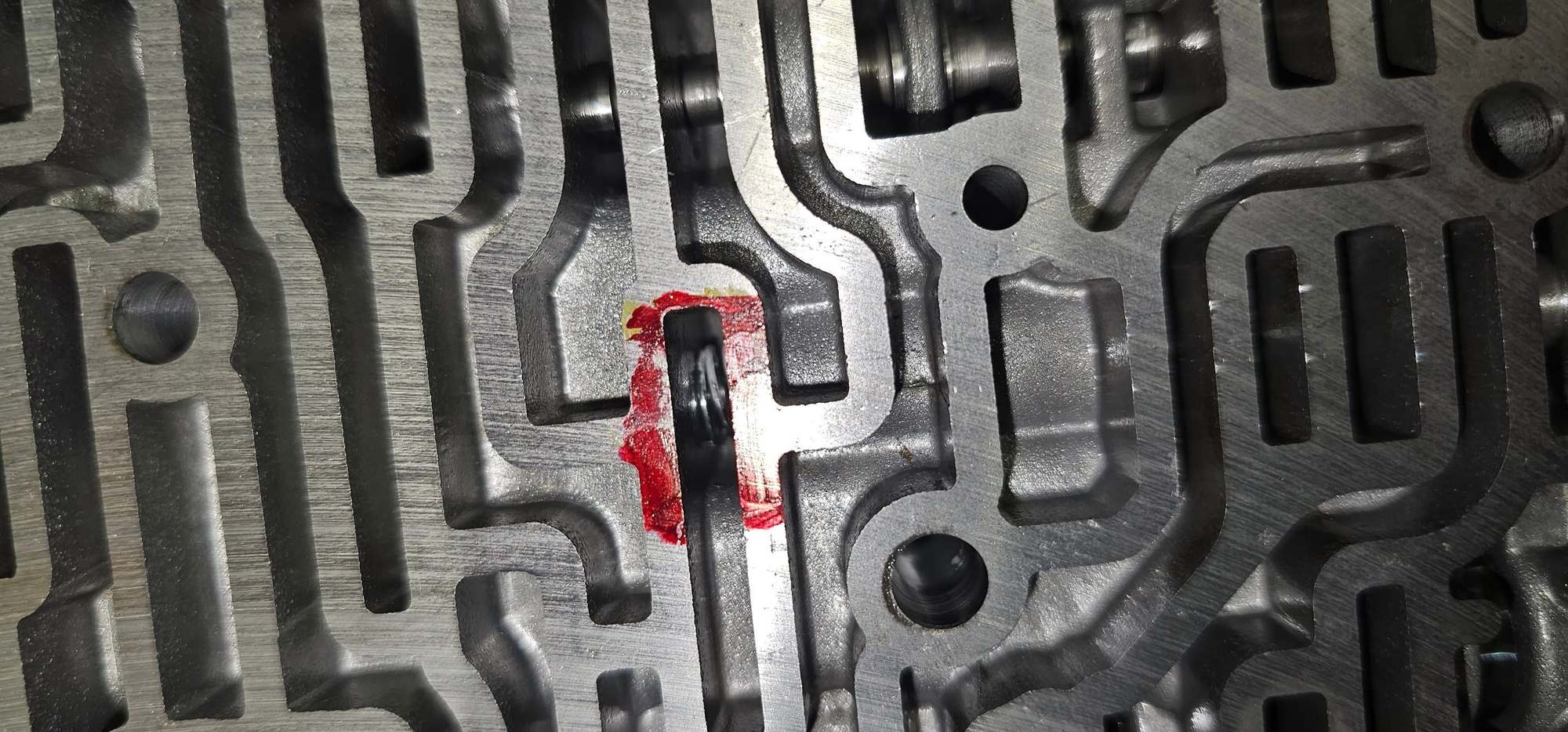

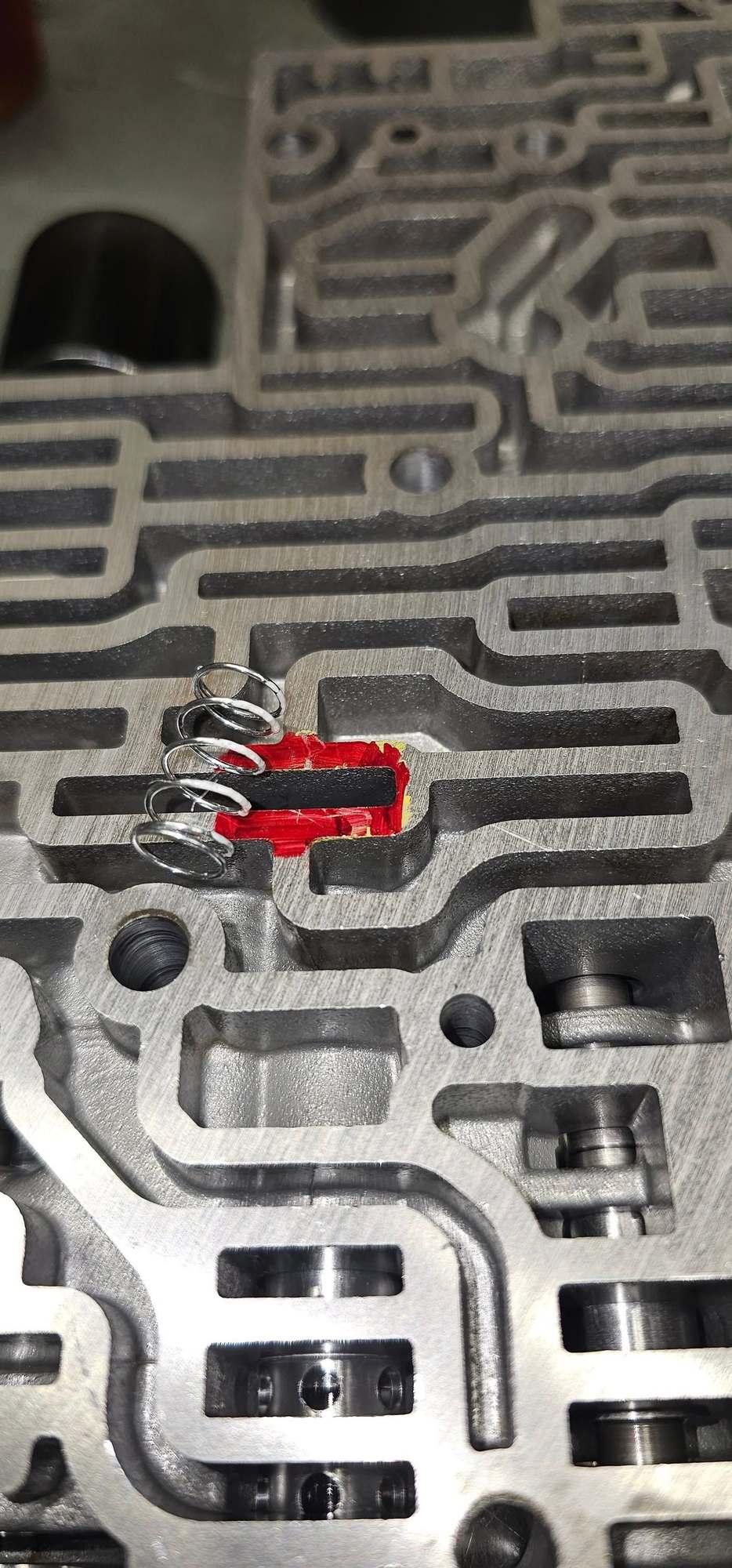

Spring over spot its goes. First look into th slot and use screw driver to push the isolator valbe away from bore wall
Sqeeze and push one of the short springs into the slot,
The use pocket driver to push into place . you will hear it click when in place.
remove converter reg end cap and replace as shown with rinnged one .
Remove and replace 4-3 valve end cap as shown .
FWD ABUSE PLUG Again remove the outter cap spring and valve. Then  from under side with pocket screw driver put pin up enough to grab from other side. Then with thump over bore remove roll pin . remove bore plug, iF YOU HAVE PIPE Brush as before debure hole and the grease plug and instal same as before wit gentle twist till in place to install pin. Then blow out bore just in case and reinsatle valve spring and stock cap

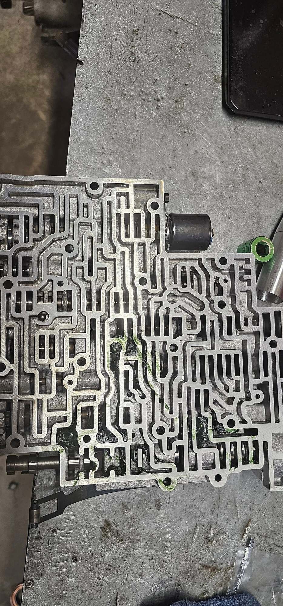

Now VB plate is ready to go except a choice, I have one hole marked . For light to moderate firm 1-2 shift leave as is . If frimer wanted enlarge to .093. NOTE THIS WILL ALSO AFFECT THE 3-2 DOWNSHIFT COAST FEEL .
With petrolium jelly place ***** in positiions shown. All stock positions except for the two at blocked hole postions bathtube and overun omit those.  Also no ball needed at 4th accum in case.
Plate no mod needed already done., Except I left the 1-2 feed at .083 its marked this size will give a moderate light thrtlle increasing to moderate firm at WOT . Those wanting firmer may increase this to ,093 but note this will allso make the 3-2 coast down shift more notable.
Install assembly as removed. Dont forget to tighten the three plate bolts and make sure three long 8mm in proper place.

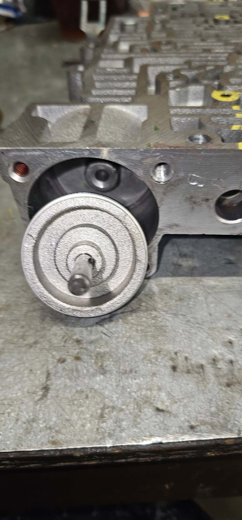

Servo and pin. Of you have a vet-fbody-gto or 94 to 96 impala see you already have the vet servo no need to change, Just swap the band pin and if stock 4th servo flip the 4th servo . when all stacked together should look i like this
With stock or the sonnax or any 4th servo when stacked you should have  between none and about 1/16th inch of gap between the cover and center peice  but the actual servo being in contact or within 1/16th of the pin .
