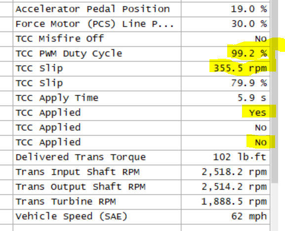

I’ve been driving around data logging with ho tuners and can’t get it to set the code again but I did observe this. Looks like it’s calling for lockup and tcc pwm is 99.2% but converter is not locked. It will eventually lock and slip is virtually zero once locked. Am I right in assuming that it should be locked here?
It could be something as simple as the torque converter lockup oring on the input shaft. Any time i have done a transmission removal (for an engine rear main seal, for example), i replace that oring. It's only a few dollars.
I've never had issues with that code on vehicles however. Check charm.li to see what the troubleshooting procedures are necessary to diagnose. It's a free website.
Also, do you have an external transmission cooler? I swapped a 4L80e on my 99 Silverado, which did not have an external cooler. I haven't really done any heavy towing with it, but want to say tge transmission runs a tad higher temperature than my 06 Suburban 2500 that has the external cooler from the factory.

It does have the factory external cooler.
I pulled the pan today to take a look for clutch material and replace the TCC solenoid and unfortunately there was quite a bit of clutch material mixed with metal. Something is slipping so looks like a rebuild will be necessary.
