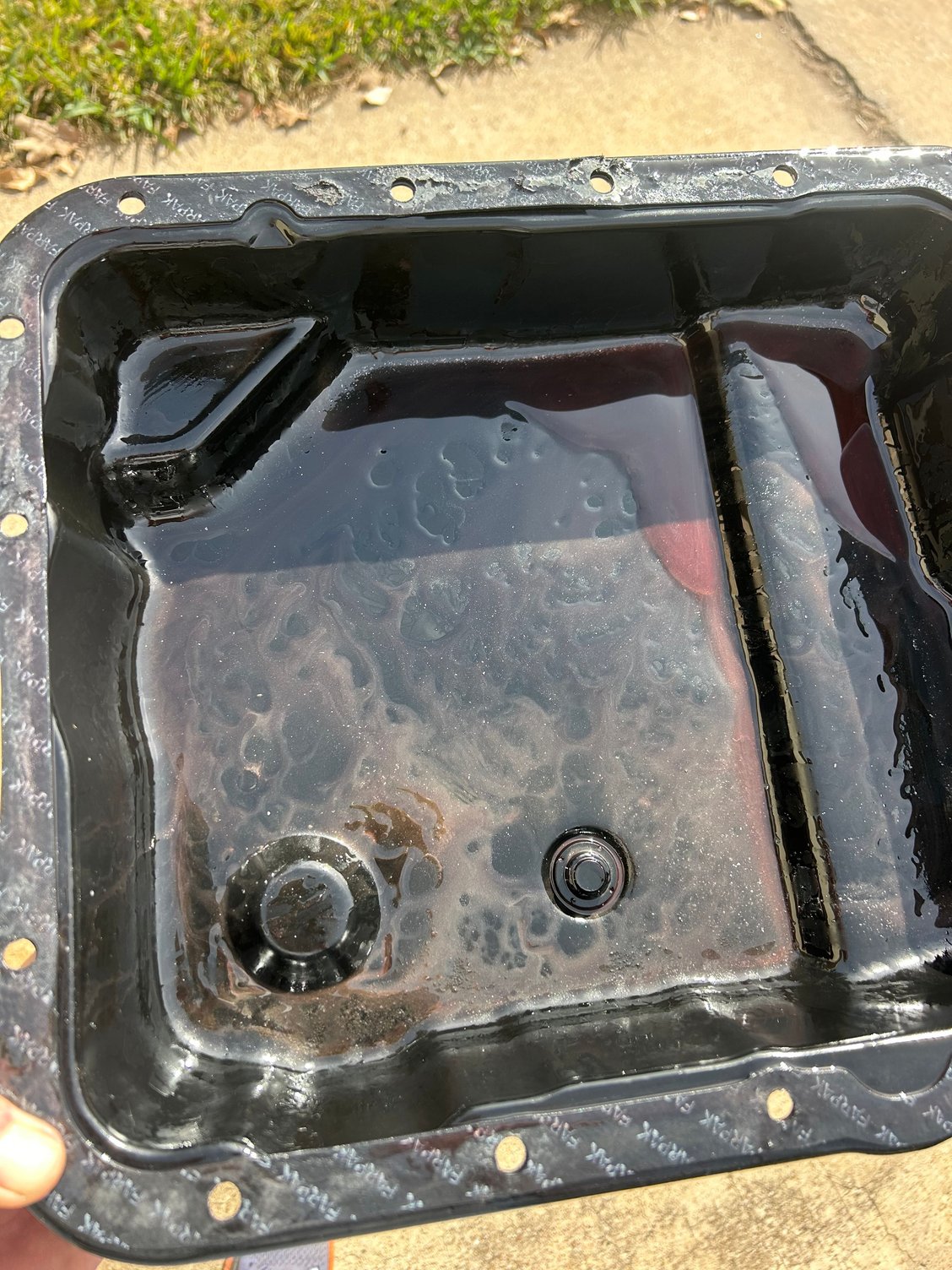

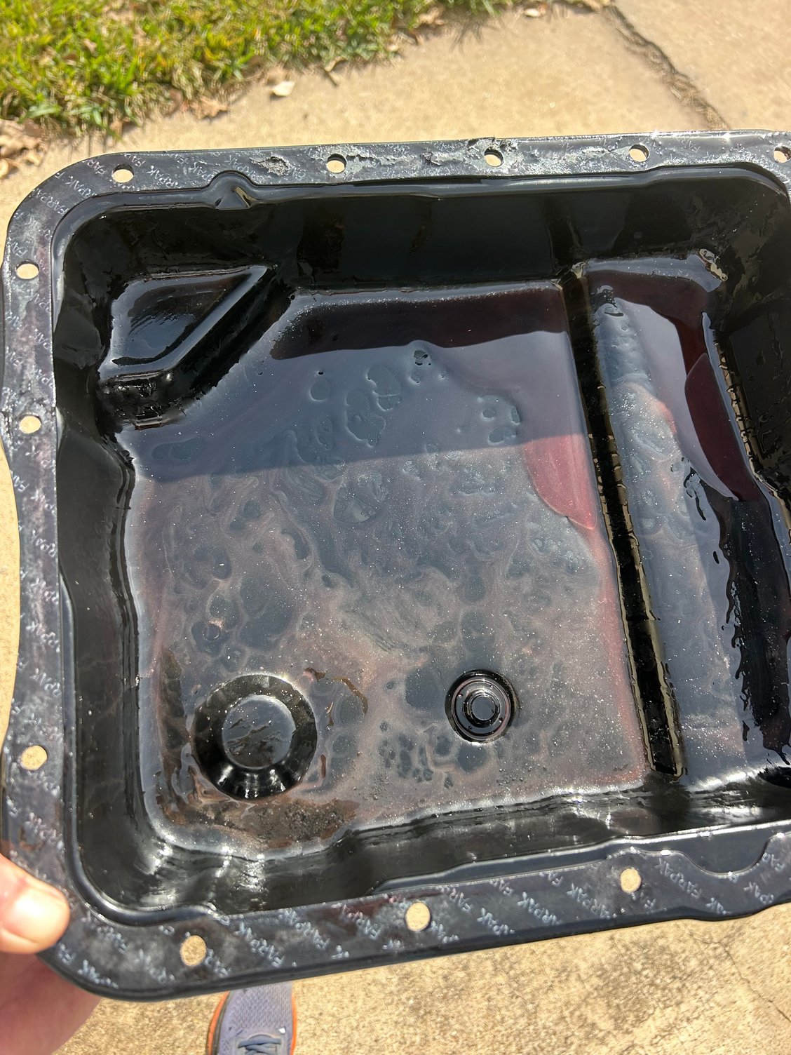

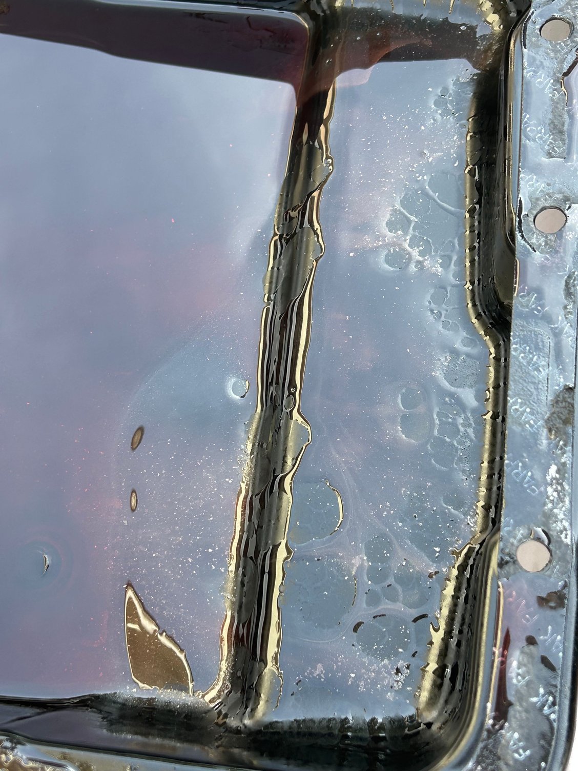

Default Dropped The Pan. Outlook Not So Good.
I dropped the pan and replaced the filter today. The pan had a lot of metal in after just 500 miles. The fluid draining out of the pan didn’t look too bad so I was hopeful for a second. But then I shat my pants once I had a look inside the pan.
I replaced about 6 qts of fluid and it’s at the full mark on the stick. When driving slow it seems like it shifts a little smoother going from 1st-2nd and 3-4. But it’ll still make a banging sound under the seat on a slow speed 2nd to 3rd shift. It might not be as hard or loud though. The bang only occurs when it shifts into 3rd at around 1500-1600 RPM (under 20 mph). No noises are made if the 2nd to 3rd shift happens at say 2k RPM. It doesn’t make any noses during WOT shifts either. Just at 1500-1600 rpm.
When I first got the car home from the shop it wouldn’t pull itself at idle speed in drive. I thought maybe because of the higher stall. But then one day it started pulling itself and it still will. This is just a guess but I bet the dude who put it in got the TQ converter spacing wrong, and the metal is probably coming from the splined shaft.

the material in pan looks worse than it is because of the black finish , Its not actually bad looks to be mostly crass whick some could come from new bushings and there will be some clutch material , My own car actually had more in it. In fact what you are seeing is the sole reason most have you do the first filter change. To get that out, Though you will always see some with every change. If not then the first change would serve no purpose.
And of course as you said you have no idea if the cooler was even flushed.
I would not expect it to fail at all personally based on what I see.
Now back to the "BANG" on you gave a little more info which helps , The RPM at which is happens and the fact it does not happen at RPM above 2000.
So now I have a good theory of whats happening.
ADAPTIVES- in the tune the PCM is programs to tryand atttain a specific shift timing from comand to shift at varying speeds, throttle levels. load measurements . What you have told me is that as the RPM and throtte are higher the "bang" goes away.
Ok now here is what I think is happening, Now obvioulsy the shift will be firmer due to the shift kit. But more is going on. When a shift happens the PCM looks at the engine RPM as the note of when the shift actually occurred, However at well below stall speed and the expected slip this time will apear to happen slower and longer than the goal.
Lets say the goal is .250 but due to the stall speed it at these low RPM does not see a definative shift and sees the time at .350 or higher. The PCM sees this as slipping and raises the line presure even though its not actualy slipping to try and get that .250 time.
Now as your shift with higher throttle happens at a higher RPM AND Closer to stall speed you will have less slip (stall) so the PCM will not raise the line to compensate .
Now you might ask why in 3rd but not in second? Easy the first ration is low and (numeracaly high 3.067 ) so the RPM will be again much closer to the stall speed when it shifts . So the PCM will either no change the line to compensate or even actually lower it if the shift seems to happen faster than the .0250,
But 2nd to third iS not such a jump and 2nd os comparably much higher gears than 1st and 3rd way way higher and these low RPM shift happening well below stall speed. The PCM sees the shift time as to long by the time it sees the shift via RPM which again is the only way the PCM can determine if the shift occurred, Thus "BANG" low RPM low THROTTLE 2-3.
In any case the info you have given makes me 99 percent sure ^^ is what is happening. as you say firmer throttle higher RPM shifts no "bang " .
Now I dont think the "bang" sound is coming out of the trans itself as really IMO that woud be impossible, But the impact of this low throtte high presure shift is just jolting the drive train causing it.
This could be fixed in the tune yes, By turning off the adaptives and even if needed reducing or pulling back the line at that throttle area and RPM. But you have no access to a tune or tuning software or the ability or knowledge to upload a tune even is sent corrections.

I will reiterate I have NO expectation of failure of the trans. Based on what was in pan and all you have described. I would put it in my own car in a heartbeat,

I hope you’re right that it’s normal. I’m too broke to have it even inspected. I’m not bashing your product. But I have a suspicion that it got installed wrong.
The first time it made the bang on the way home from the shop it was so loud that you could literally hear it from across the street. No kidding. It wasn’t subtle by any means. The loud bang is more of a clunk now. You can still hear it and feel it if you’re in the car but the neighbors can’t hear it anymore. That sound and feel one might could attribute to a shift kit. But the first loud bang was so loud that it sounded like something had broke. It was wicked loud. It wasn’t just like, “eh it’s a little rougher,” which is what it kind of is now. It was more of a, “Oh sht, did my driveshaft just fall out!?” type of noise.
When I first got it home it wouldn’t pull itself on a flat surface without giving it gas. But then one day it started to do so. Have you ever seen that happen?
This weekend was the first time that I dropped the pan and changed the filter since I was waiting to reach 500 miles to do so. But the fluid was drained and filled enough times during that 500 miles to where the bulk of the fluid was replaced several times. You’re right that I don’t think the cooler was flushed prior to the new transmission going in. That’s part of the reason that I drained and filled so many times during the 500 mile break-in period. Is that still a normal amount of metal considering that it was drained and filled numerous prior to dropping the pan? You don’t think that the input shaft is getting chewed up everytime that it runs and that’s where the metal is coming from? Thats my fear. Bad install job I’m thinking. I did do a few pan drops on the original transmission prior to having it replaced, and it never had any shiny metal “brand new” looking metal in it. It was always just dirty with gray clutch material. I never saw any metal like this in it.
If it wasn’t for the fact that it wouldn’t pull itself at idle and then all of a sudden it will, or for the first initial super loud bang when I was leaving the shop I wouldn’t be thinking that the metal was converter or input shaft related. The now not so loud 2nd to 3rd shift is “liveable.” I’m just worried that it’s has other issues going on that aren’t shift kit related.
What would be the symptoms of a converter that was installed incorrectly? Do you think that if it was going to “crap out” that it would have done so within 500 miles? FWIW the converter that I’m using is just a reworked stock converter. Some of the reviews of those that purchased it stated that they couldn’t tell the difference between it and the stock converter that they replaced. In other words that it wasn’t a “radical” enough of a stall to where it wouldn’t pull itself in gear at idle speeds. Mine wouldn’t at first and then miraculously all of a sudden it would.

Honestly most every time you pull pan you are going to find some , In fact what I see in your pan on a black pan is less than expected . I see what looks to be a little brass, No chuncks and some minor clutch material , But nothing out of the ordinary , As for draining flusihing yes some would come out but some would remain and tricket out of filter or lay pan when changed and of course you will have some wear in material , Nothing IMO out of the ordinary. . So I am not concerned particulary is it was not flushed to start with it can take some time for crap to work its way from cooler through converter, and valvebody and back to pan.
The not pulling at idle well indeed if the cooler was not flushed some little something could have gotten temporarily loged someplace and maybe it was doing second gear start it worked it way through and boom fixed.
And of course the trans you replaced did not have new bushings ect.
Of interest what was the failure of the original trans ?
Oh and actually of note my first change on mine was actually WORSE as I did not note a burr on my yoke that tore the tail bushing up pretty good so I had considerable silver n gold. then noted where is came from fixed the yoke bure. changed the filter and that was 34k miles ago,
I have not done anotehr since as that what they have magnets to collect that stuff and oils been clean, Probably will do it this summer sometime.
I really do not think at this time there is any issue left that cannot be worked out with a bit of minor tuning (I will say I am not a fan of "reworked stock converter to get over a 3000 stall")
But thise are my thoughts on the matter, I think the trans if fine, Likley cooler was not flushed and maybe stuck a valve or plugged some orifce making second gear start so no movemt and whatever it was eventully cleared and I would not be worried about it, And reality, you have a warranty while true right now you cant take out and send to just have checked , But it there is if were to become a HAVE TOO.
I woulld look into the TUNE and not just for trans but you can get some impressive power/ drivabilty even on a stock car with a good tune.
I would not worry about changing fluid again till at least 20 30k miles and then yes I would expect some material . that is the reason they have filters and magnets in them to collect the little debris,
I ask about the old trans as if it was a 3-4 clutch failure that would explain the early extreme 2-3 shift again adaptives left over from previous trans and it would have gradually gotten better .
So in answer to your question, No I would not be concerned, I would drive and enjoy the car and If i could would consider an overall tune not just for trans but for over all performance whan you can afford it .
In the mean time if you do have a problem which I honestly dont expect, You know here to find me .

The long shifts the PCM would have tried to compesate for, And that would expplain the intial extreme bangs with the new trans.
Reason explained. With no reset with scanner of tuner it would have set presures at first while like the older slipping trans over time it would settle down at least to the extent that the stall stuff I mention would have allowed. Basically the more you drove it the better it would get .

I don't think the "bang" is/was a tuning issue. I will again outline my personal experiences with a very similar application:
2000 WS6 Trans Am, 3.23 gears. Same model year and gear ratio as the OP.
Yank 3500 stall speed
Stock 4L60E, and then a built 4L60E by local builder FLT (FLP at the time)
Stock tuning (LS1 Edit wasn't out yet, this was ~25 years ago) other than an HPPIII for WOT shift points and fan settings
Car behaved pretty well with the 3500 stall speed and stock tuning, it pulled forward on level ground at the stock 550rpm idle speed (from day one with the 3500 stall speed). Only issue was a little idle surge when stopped in gear due to the different load of the smaller diameter, higher stall TC, and WOT shift points were a little early. There was no bang, no clunk, no pronounced issues with shifting to or from any gear at any rpm or throttle position - and that was with stock tuning. Same was true when I upgraded to a built 4L60E the following spring.
Later, I tuned the PCM myself using LS1 Edit after a cam install - but I never needed to correct anything to attain proper shift behavior at light throttle.
Having said all of that, I was under the impression that the OP had an FTI converter, something like a 3200 stall speed? I thought I read that in an earlier post. I didn't know he was using a rebuilt factory converter. If the converter is some off-the-shelf rebuilt stock piece, then I would consider it suspect (especially since it wasn't pulling forward at idle but now it is). Could be any number of issues with that converter if it's some generic stock rebuild rather than a top shelf higher stall like an FTI, Yank, etc. This is new information of which I wasn't aware prior so, at this point, my guess is either that there was an install mishap or that the generic converter is junk and causing some issues.
But, I will go on record saying that I do not think the problem is tuning related. Too many folks (myself included) used to put 3000-4500 stall speed converters (top shelf stuff from Yank, Vig, etc.) in these cars back before we even had proper "custom tuning", and I don't recall ever hearing of anyone (myself included) having issues with low speed shift "bang" from stock tuning. There would be other issues related to idle surge, or lock-up issues if you had a cam, or "limp mode"/codes (usually only with the more sensitive 2001+ PCMs and stall speeds in excess of 3500rpm), but never anything like the OP is describing. It should always have pulled forward on level ground in this application, and nothing should *need* to be adjusted in the tune to prevent loud banging which can be heard outside of the car. Tuning might help to cover an issue, but it's not the source of the problem here IMO.
To be clear, I'm not in any way pointing a finger at Frank or his trans. Personally, I suspect something happened during the install, and/or that converter might be junk if it's just a stock rebuild (which is not what I understood it to be originally).

I don’t think that you’re grasping just how loud of a bang the initial bang was. It was loud as F and it was pretty violent. It shook the car, it wasn’t just a little “shift bump.” It was so loud that I pulled over to make sure that the driveshaft didn’t fall out. That was my initial guess as to what the bang was. The ECU was reset numerous times when the old transmission was still in and it didn’t shift any better or any worse after a reset. It was still the same ole sht.
The bang was an oh sht something broke type of bang. It wasn’t a “guy thinking the shift kit should shift as smooth as an OEM trans” type of bang.

Im using 3200 stall FTI Street Brawler converter which is 11 inches. After it was installed and it wouldn’t pull itself in gear I reached out to FTI asking if they thought that it should. They said yes it should be able to pull itself in gear because it’s more or less just a re-worked stock converter. They asked where the spacing was set and I said that I don’t know.
So yeah I think that something went wrong with the install. I guess I’m just going to drive it here and there and hope that it doesn’t break. I bet it will at some point though. FTI Street Brawler
