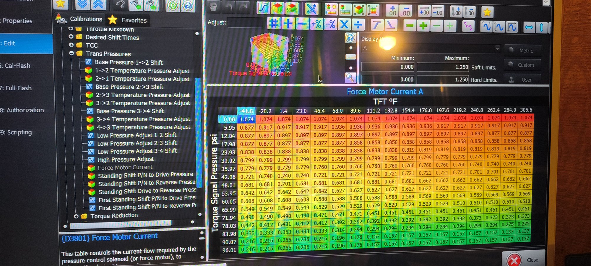

I woulld look into the TUNE and not just for trans but you can get some impressive power/ drivabilty even on a stock car with a good tune.

Also as I am sure you have been in the tune GM actually puts negative numbers in the presure modifiers under this very set of conditions , I assume to mediate it even stock.
Anway today I will certainly be raising my part throtte shift points back up as I hate the stock tunes overall feel and not just the (bang/clunck) which IMO is tolerable but slippy feel of the whole set up being so very far below stall speed .

If you have EFILive or HPTuners,I prefer EFILive you can go into the trans table and adjust some of the trans parameters,That might help before you start taking things apart.Before I went to the Holley Dominator I had the 0411 pcm,My car would bang into gear going from park to drive,I raised the #'s in the force motor current table,Just the upper rows,Shifted nice and smooth after that.Something maybe you can try.

In my own car I was not at all pleased with the overall feel of low throttle shifts. To me with the stall even though still shifting at same timing and speeds did feel sloppy well except 1-2 as the low gear nature 3.07 first wound it up a little more so it bumped but the 2-3 felt kind blah and overalll slippy and 4th really worse. Then on as I mentions on mine when warm the TCC would come on in 3rd and 4th at very low speeds and throttle and added another level of clunky and general "yuky feel" . I lliterally fixed it in a single move by raising the low throttle low speed shifts by 20 percent , With 323 would probably go 10 to 15 percent and I moved lockup to 4th only above 40 mph.
I think what you are feeling can best be described is like a manual trans upshifted to early and the back and forth clunk feel as drive train relaxs the grabs.
Honestly if you plan future mods or are not looking to get a full tune or want to learn , Rather than a Tune. I would consider getting HP tuners myself . Most simpler mods you can do easily yourself as its pretty user frendly and cost less than many charge for a full tune. Then you can chose if you wanna learn more, I am learning it myself now, The trans parts and tables as pretty easy. Fuel trims and timing Im not having easy time learning lol. To much math .
