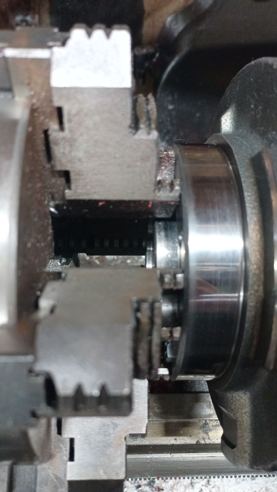

1. How do You hold the Center Support in a lathe? (for 9436851 TH350 pump/TH400 Output bearing install)
Dont want to scuff the Sprag race, is that Really how its done?

1. Yes you hold by the roller clutch* race ("everyone does"), oof!, unless you want to take it apart? See Below.
EDIT: You can hold the INSIDE section of the roller clutch area (non-critical), but you only get about 0.250 of purchase. I got a 6 jaw to get a solid grip on it..

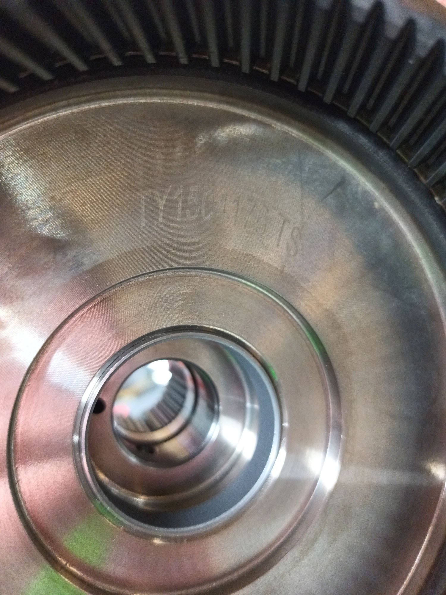

Chinese Repro Deep Dish Drum? Laser etched TYXXXXX on the bottom.. doesnt look GM...

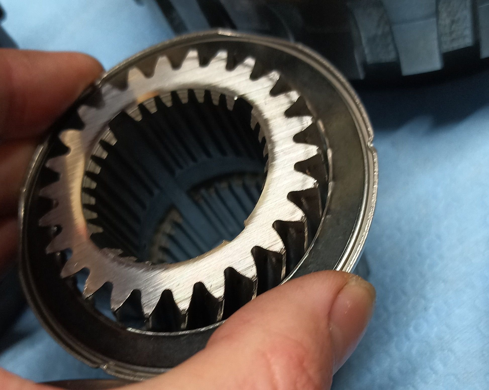

13. Sun Gear Shaft - why do the splines stop short?
14. Sun Gear Mods - How do you sleep at night with those ugly cut-off wheel gashes in the side? Let's see some machined examples!

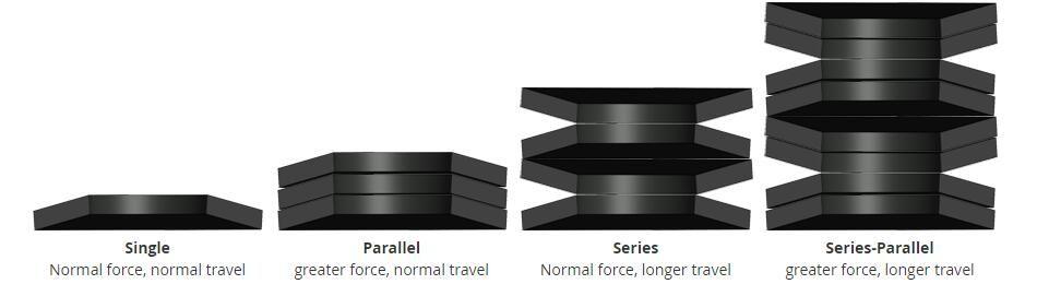

19. Anyone throw an 0.040 80E Wave between bottom of the fwd, TH400 Wave and 77 steel as a way to absorb 0.040 in the stack.
Too many beers? Should I phase the waves? Constructive or destructive interference?

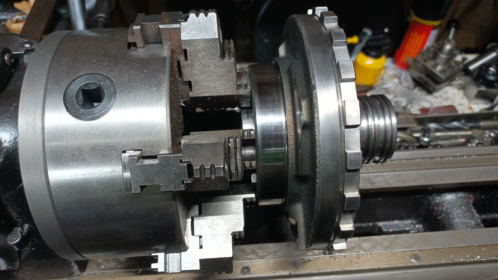

The area I chucked IS critical, its the Reaction gear Bushing race.. havent resolved the oiling passages, or seen a picture inside.
Still might be the best area to grab, although, it is entirely more durable than expected, and the outer roller clutch race might be fine to grab..

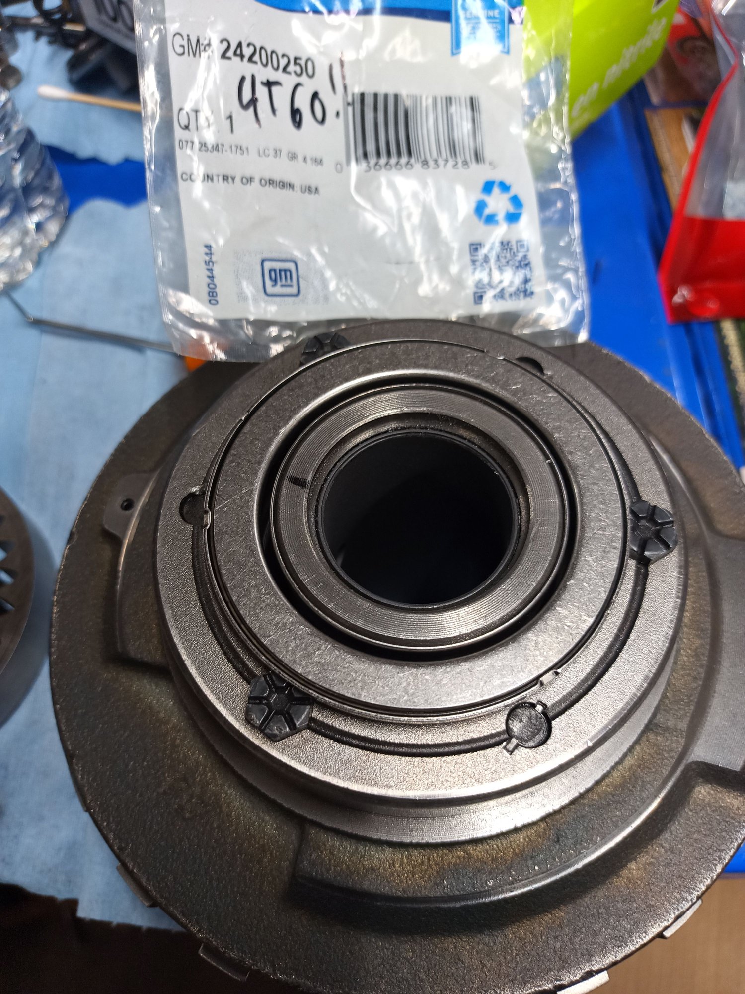

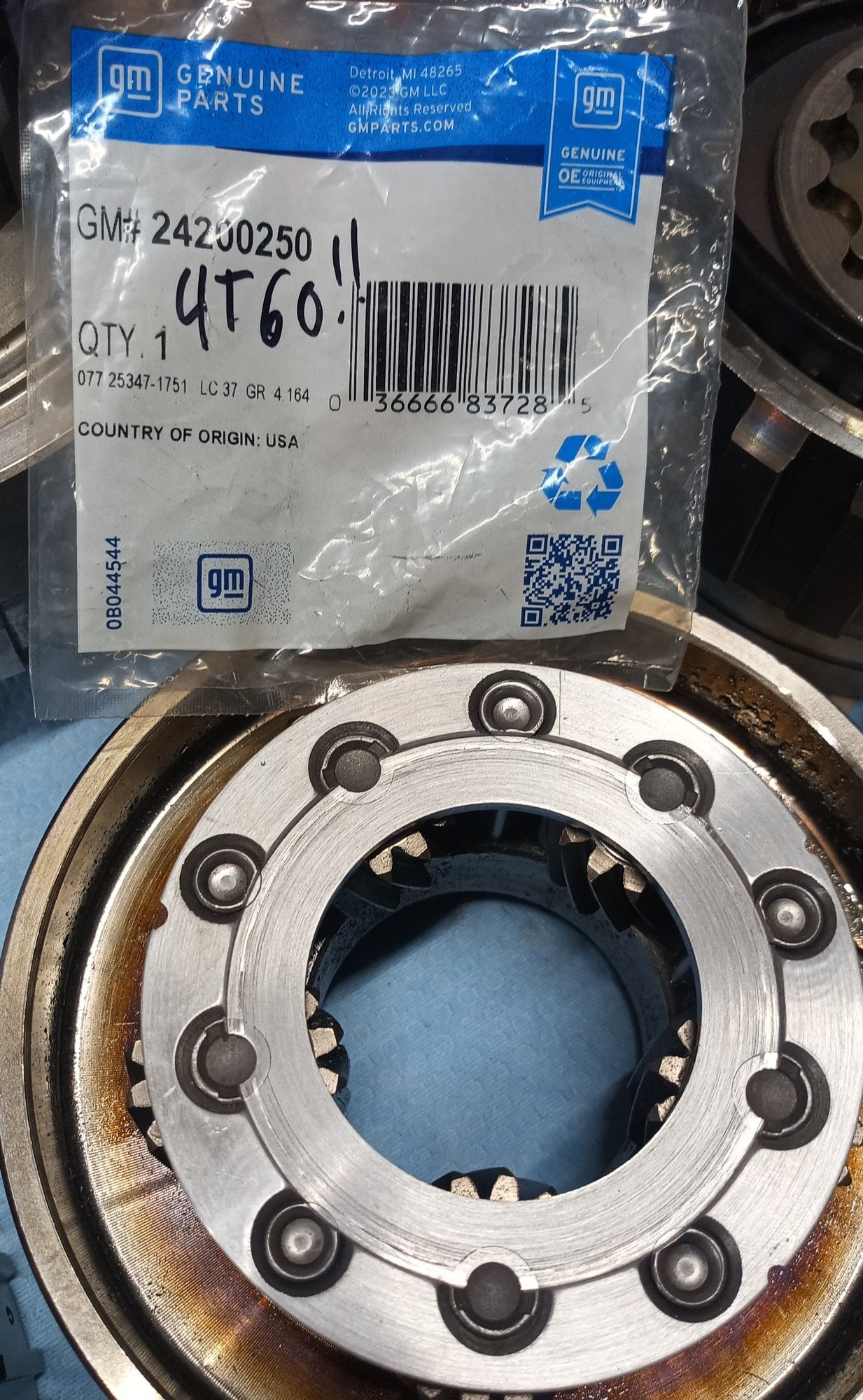

Reaction to Int/Center support, (I've learned a lot about this interface lately, heh.
A TH350 bearing is DUMMY close, but the ID is off, even when the inner race is skimmed a ton.... I might destroy a bearing ID trying to fit one, its that close. The 4t60 bearing mentioned above is kinda large, but it clears the ID.
Here is a series a photos for reference.. I have a spare support I am going to cut and fit a bearing in.
First is the TH350 bearing, skimmed for the sun reaction mod / sun shaft ALMOST clears..
Then the 4T60 Bearing
Its a little big, and the thrust washer isnt centered, I think this is the wrong bearing for this application.
Here we can see the TH350 bearing is a better fit, and the thrust is pressed into the center of the race.
This fits great, if only I could get the bearing in there.. Why...? because.

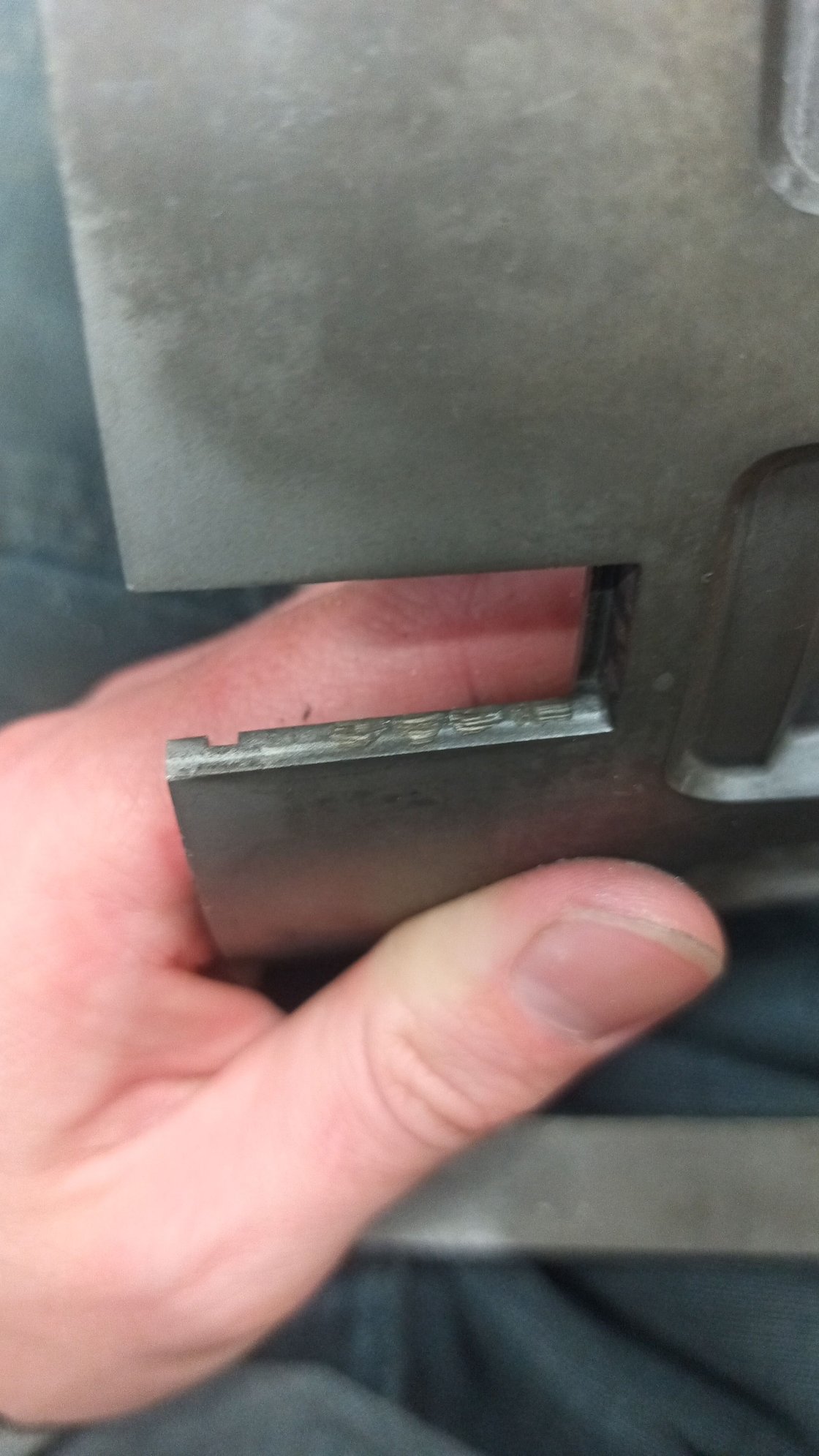

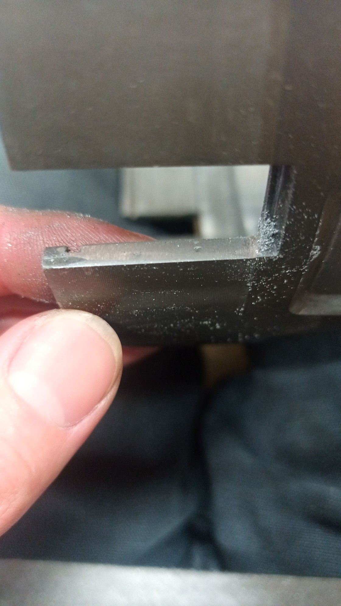

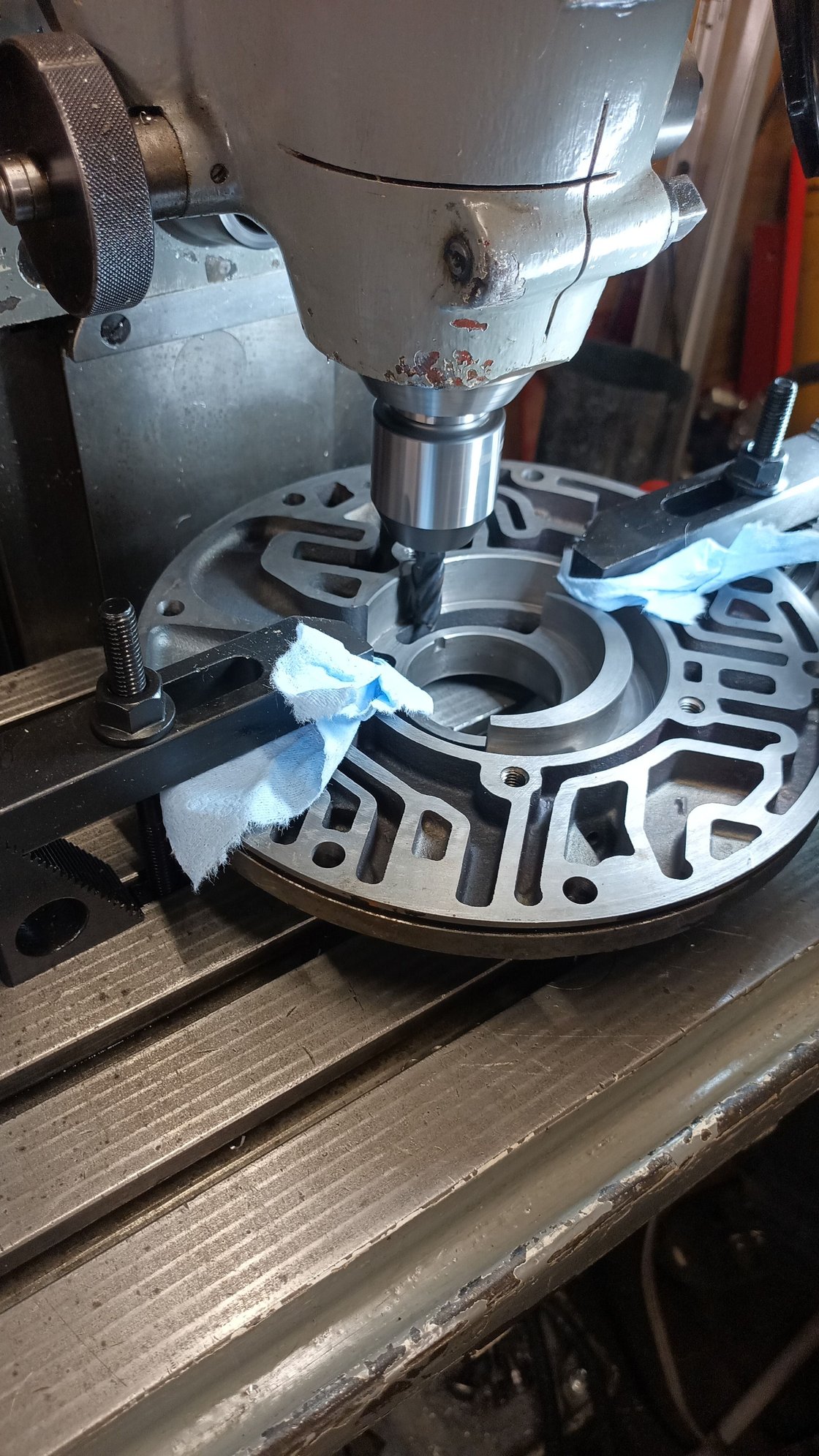

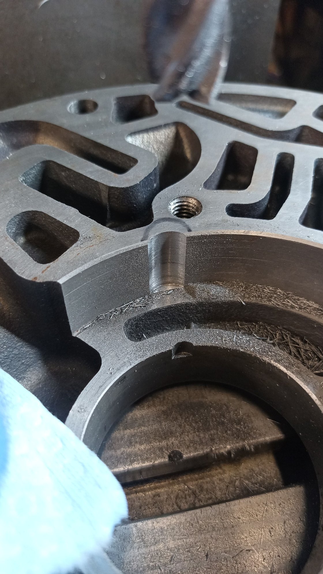

15. Tell me I put it in the "wrong" spot! Ahaha

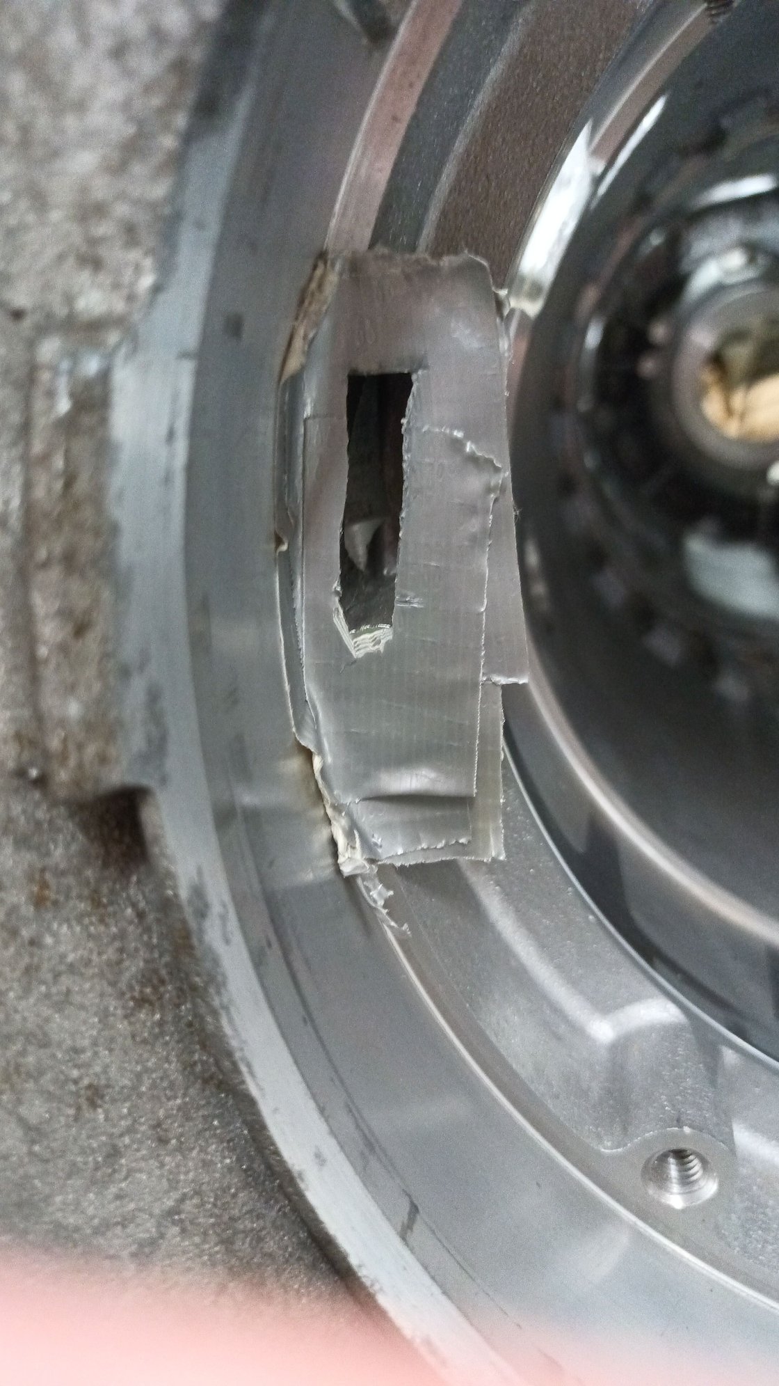

Bonus points if you know what kinda machine that is.
Check out the feathered offramp on the wedge..? from factory the transition is quite ugly.
(more pics coming)

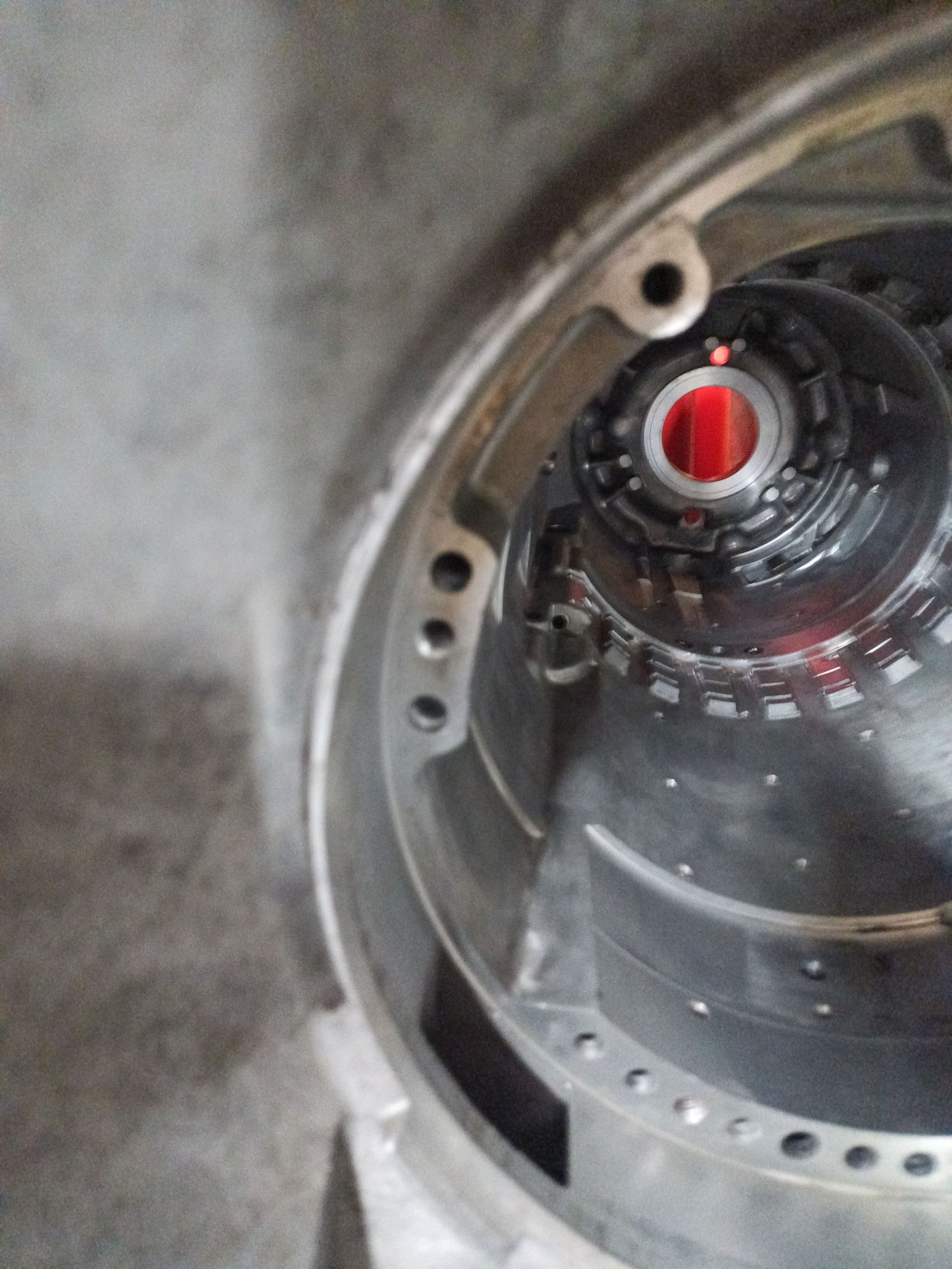

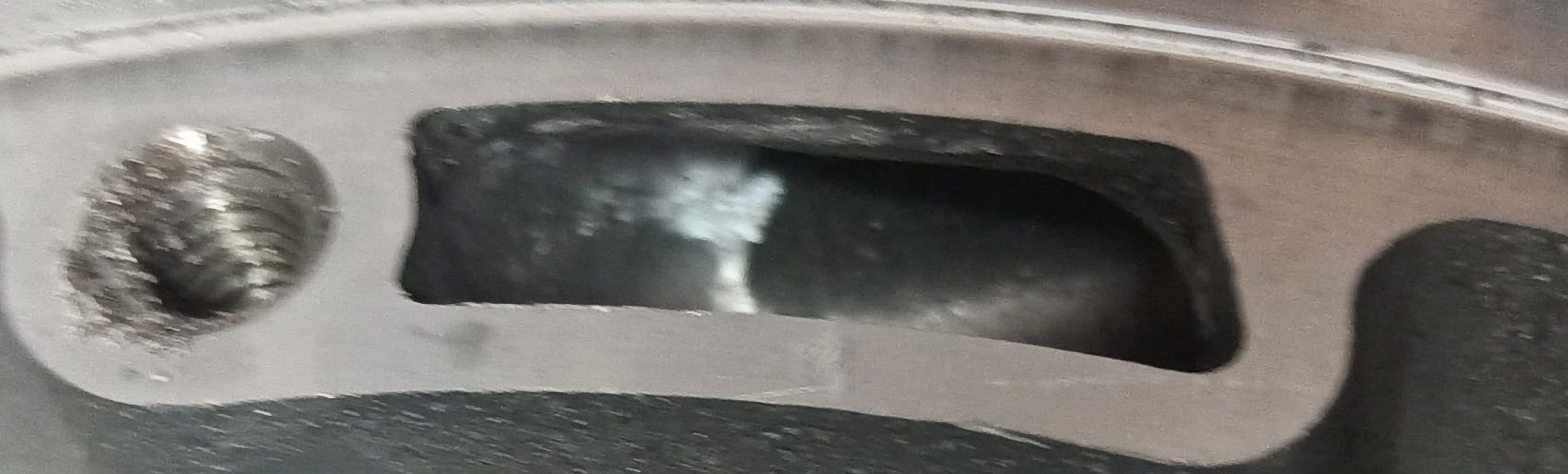

Tried for the thick part of the housing, wasnt keen on going into a wall or a threaded hole.

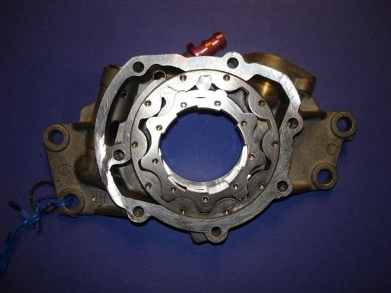

Various TH400 pumps for reference, and they seemed to be going After the last bolt..
Before the last bolt is also suggested. as close to the floor as you dare.
I probably could have eeked out another thou or so.
Two thoughts here,
1. it functions as a *cushion* to keep the outer gear off, and/or
2. it allows lube to be pulled out and around an otherwise dry gear.
If you believe 1, it might be better after the bolt hole, where the wear is centered.

Porting... Holy cow that was a challenge.
You can not touch it with your finger.. You can hardly see it. Photos were nigh impossible. Zoomed in Shakey cam.
There is no discernible way to get the "back side", as the bottom pan port is too deep to do meaningful work, and coming at the back side - from the front - results in a burr with a zero-point speed at the tip that effectively cuts nothing.
.. but now, you could drive The Magic School Bus through there..
A ton of material removed.. the entire wall coming from the outside was able to be laid back.
The main drill bevel was completely laid out into a round hemisphere flush with the floor.
Do NOT touch the margins at ALL. Hence the tape (also protects against skid-offs).
I can already hear the cylinder head porters and No-men out there screeching about CSA, SSR, and flow velocity and yadda-yadda
However, I also know that plump flow is a function of before and after restrictions, like a turbo, and if you can offer more to the pump easier, it should also output more, easier.. right? Lets hear your thoughts.

17. Duplicate of Q5.. but for the sake of records, what is the front and rear bearings used on the fwd hubs..?
For the "top" or back, people use the Ford bearing thats kinda $$, is too big ID..? The one CK suggested in his article, I have 2 PN for it..
The Sonnax unit uses a different bearing still, that requires the OD of the hub to be skimmed down. sounds better.
Im seeing a fair bit of 4T60, 4L60, C6, and a couple other goofball non-standard bearing sizes thrown around.. Would love to hear what you have used.
And what do others use for the "bottom" of front? I used the OD Carrier (inside) bearing, as its the exact OD as the original washer.

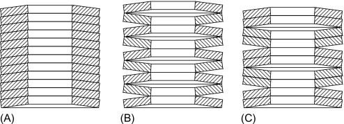

19. Incase anyone missed the Reference, or totally thought I was clowning, I will leave this to ponder.
I Know y'all hate waves!!

28. Large Window in the case on Late models, near the Accumulators.
What is it for? Pic at 25
Checking something in the stacks? (Observation window?)
Or is it to allow oil out of the stacks, cooling the plastic accumulators (which are raised out of the oil)
29. What is the little sheet metal dingus on the inside of the oil pumps? by the 5 bolts..
What is it called - and what is the part number? They're often missing from cores that have been dicked with....
What's it do.. what happens when its missing?

25. The DUAL CASE FEED was easy as...
With all these Dicks in the Room, it still took 30 years to plug a hole!
It's a shame that it wasn't included in the LATE vs EARLY thread.. surface level brainpower..
Plug the hole in the oil pump with a M5 0.8mm plug + Loctite 567. (Or use EARLY pump)
I measured it at 0.160-165".. Considered a 11/64 ball, but I dont trust em.
Drill and tap the case from the side ~1.5 inch, and down from the front ~0.5 inch
Deepen as Required. Then port it! hahah
For the Love of God, Use a Drill guide!!
