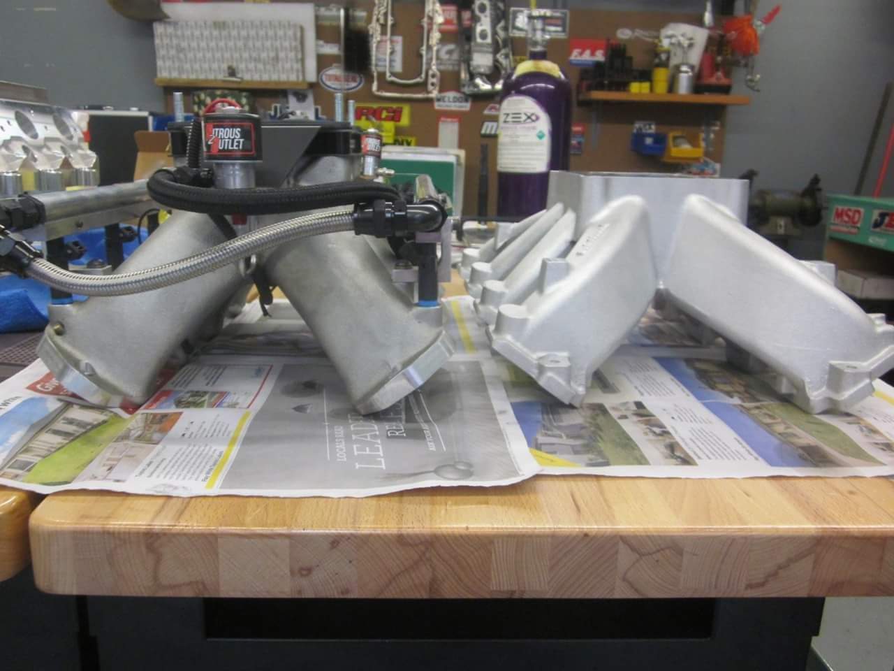

They are similar sizes, as you can see in pics. I couldn't justify the cost especially when my mate tickled the ports on my ls3 supervic. Aiming for 700+hp, back on dyno shortly

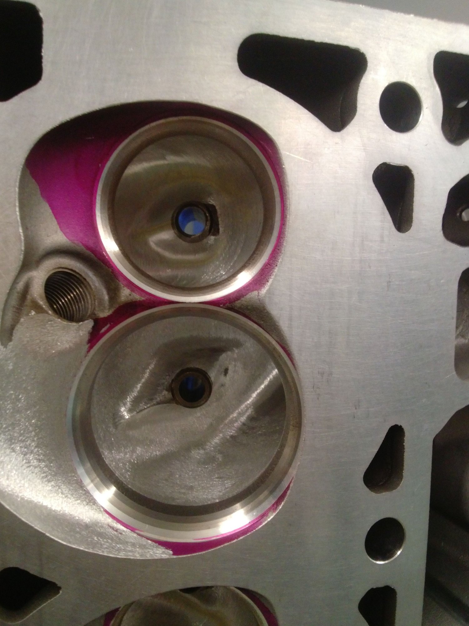

Hand ported rectangle 5364
