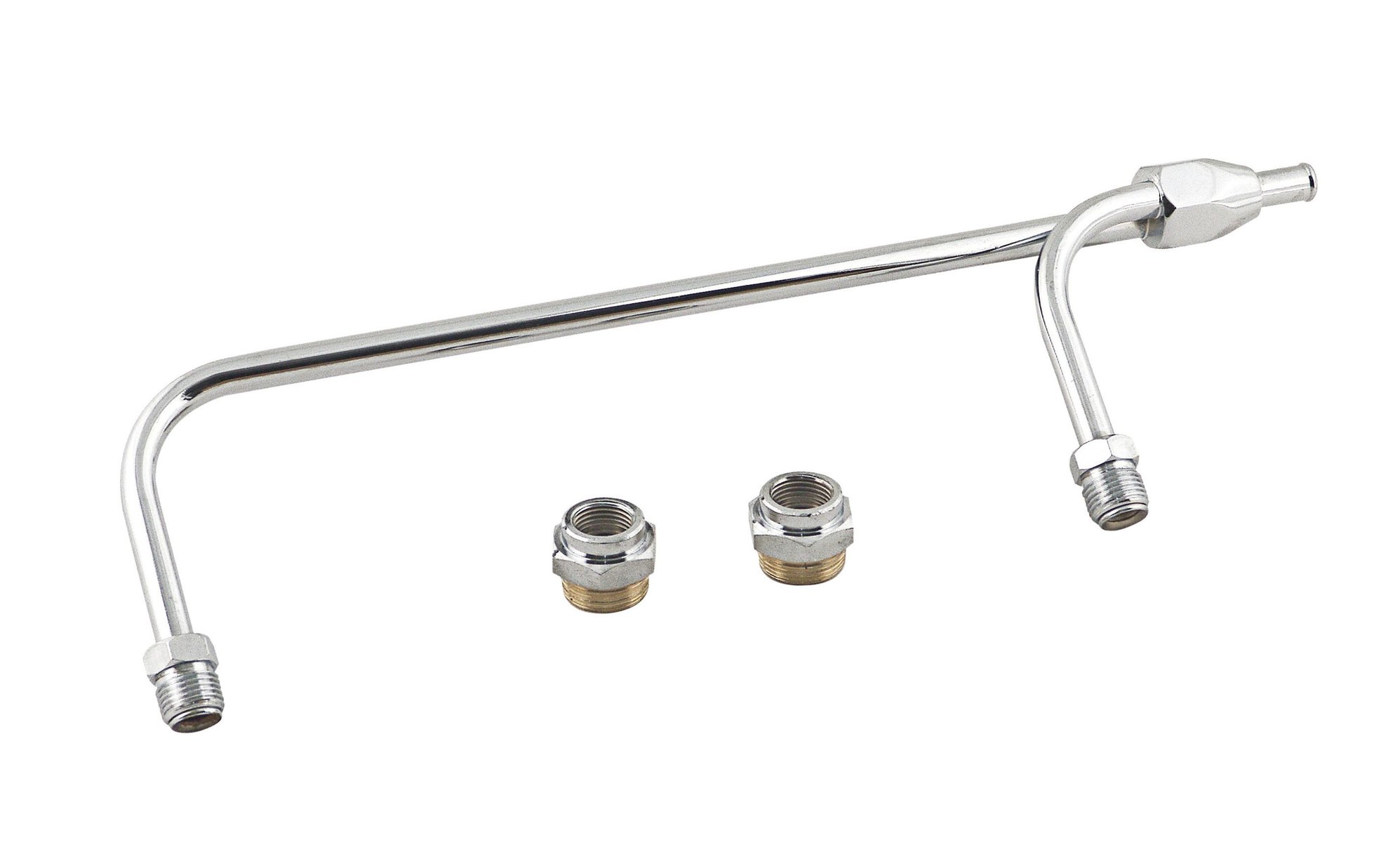

Replacing Holley carb lines. they are dry rot and cracking. Do I have to replace with high dollar 200+ psi lines or will the cheap gates 3/8 hose work? Thinking about a direct kit does anyone know a good one for the Street Avenger carb

Why not just put the right stuff on there ?

Get the correct hard line for your carb.
