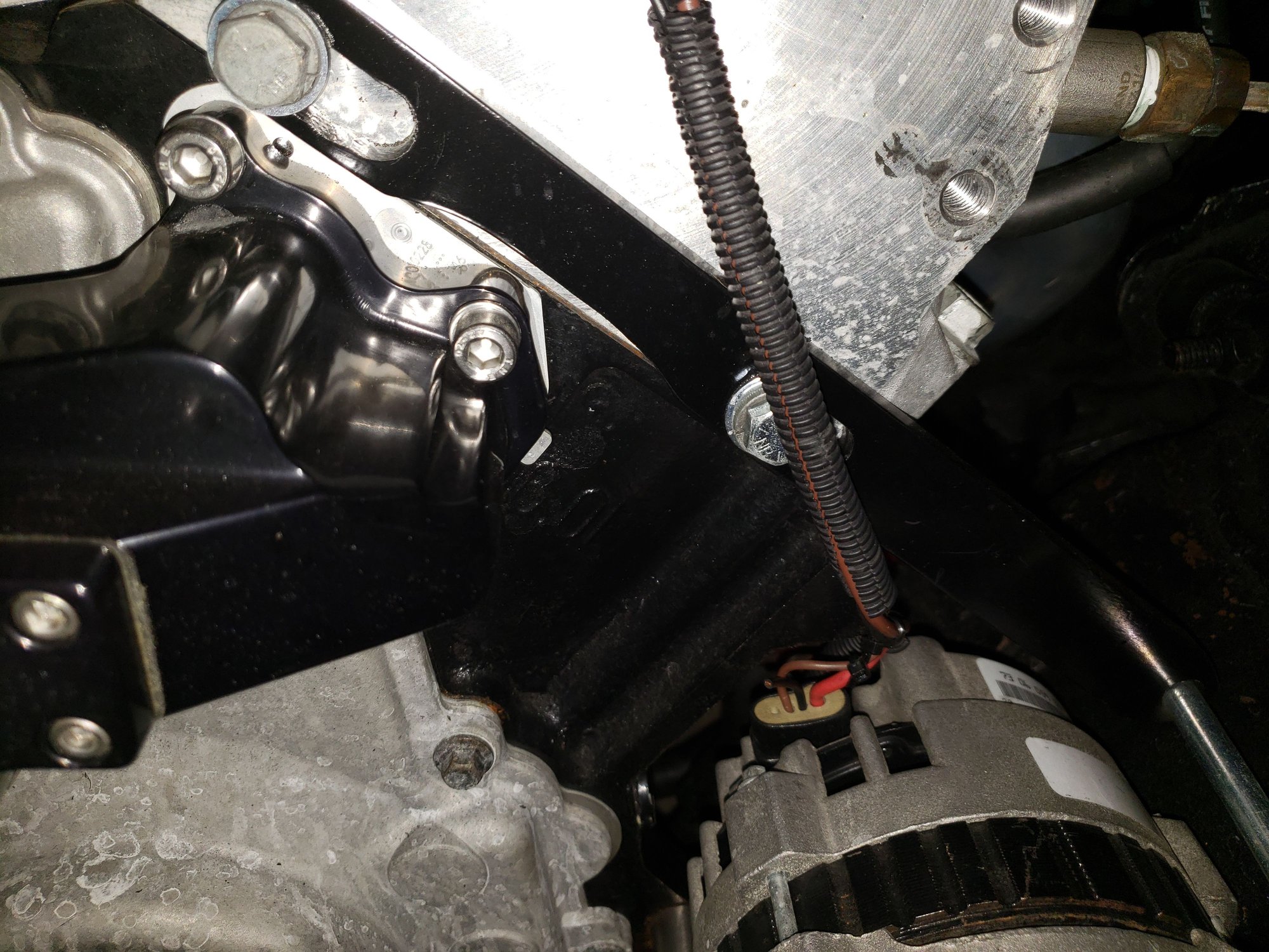

I have a bolt in one ear to the block and a 1/4" x 2" flat bar with a slotted hole for tension...has some flex and get a little belt squeal when goosed...but belt is staying on
I have to run out to get a pic.

ICT Billet has what your looking for.

Thanks fellas! I got the ICT mount!!
