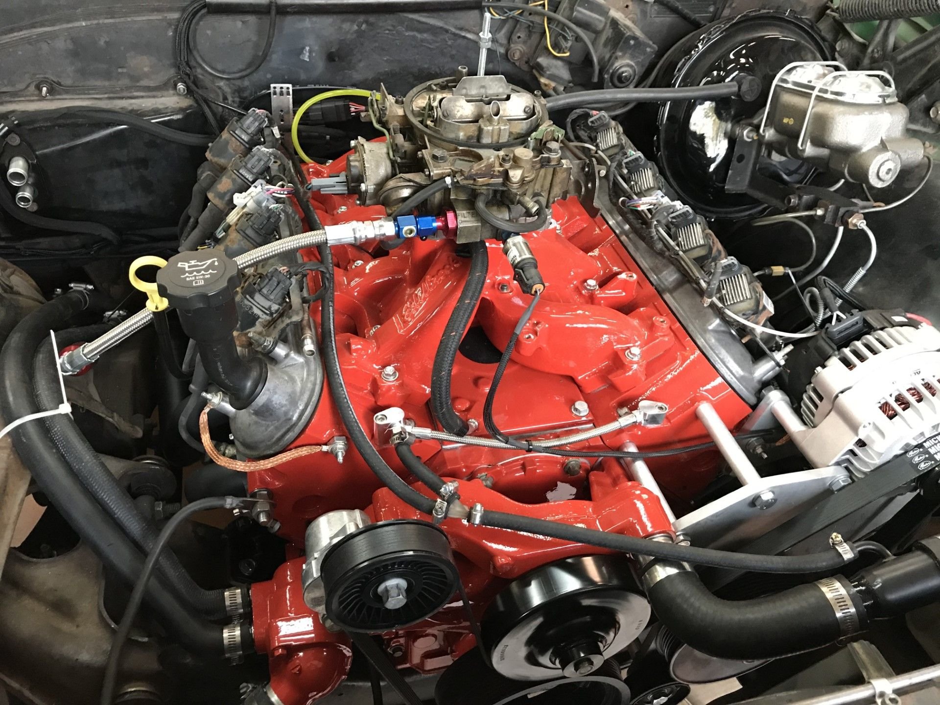

I have a stock shortblock L33 with Summit's 218/227 cam, Dual plane Edelbrock and Quadrajet carb, 5 spd Richmond in early Camaro, I get abouty 23-24 mpg, when I'm cruising. My AFR gauge is pegging at 18 on the highway, goes right to 12 when I step on it. Best of both worlds.

That's terrific. What model Q-Jet?

it's a 17087118 (1987 carbureted F-body 305). Non electronic but dual capacity accelerator pump that I cancelled. It's a dual main air bleed 750. I've tweaked quite of few of them over the years with all kind of recipes I learned from others and some I developed, and this one runs quite well I must say. I'll try to post a video where I'm cruising down the highway and we can see the AFR gauge, along with other gauges. It's on my phone so it me be tough (for me, LOL) to bring it here.

Default quadrajet set-up
