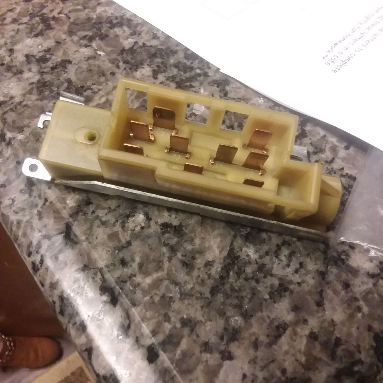

Yes I did LE35TH. Here is my switch,, starting to think not the problem
