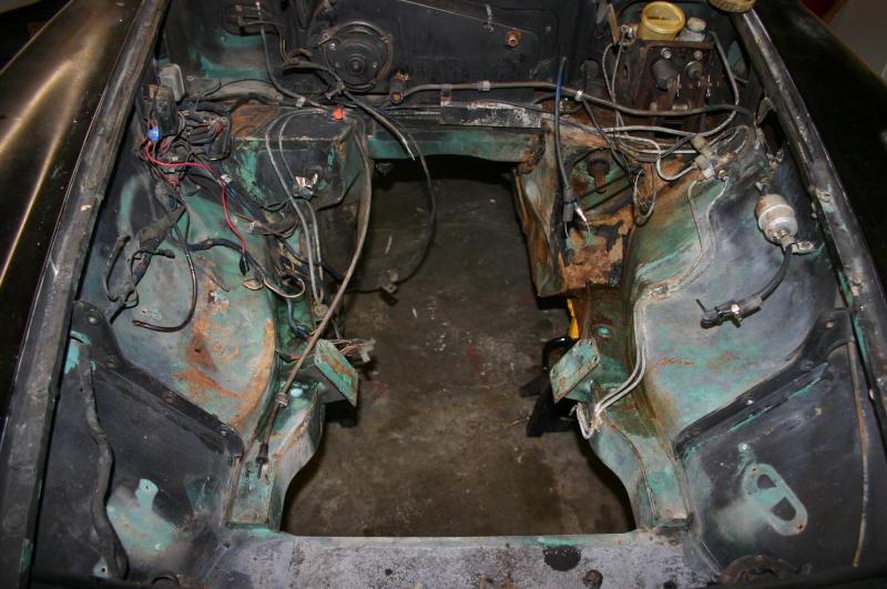

The engine and front subframe are out of the MG.
Yes, some fabrication will be required to squeeze the engine in there!
I'm seriously considering keeping a live axle in the rear. I was going to stuff a Miata independent rear in there, but since my donor Camaro has an LSD I might just keep it. I've been told the Camaro rear will fit into the housing from a 2WD S10, which is just about the perfect width already. Comments from those who know? I don't plan on any engine mods, just the standard LS1 power should be fine in this little guy.

You need to use a 2wd S10 rear from a 98 up S10. That will have the 28 spline axles already. the older ones had 26 spline axles and wont go into the later model diff. 4WD S10 housings are 4" wider than the 2WD ones. I believe they are close tothe 60" hub to hub width that you will need for the B. Yea I looked into this with my 72 convertible body B already. just through in an 04 ZO6 cam and springs. best bang for the buck in a body that light.

Thanks for the info, that'll make my life a lot easier. I'm working off the published track widths of the trucks, not hub-to-hub. Anyone know what the offset of stock S10 wheels is?
