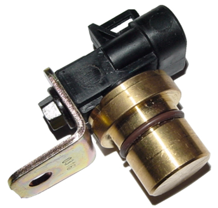

Anyone know if the crank sensor for the 24x is orientation critical ? 'Im trying to mount sensor on the front of the engine and if I put the plug facing forward like it is normally mounted that puts it in line with the alternator belt
I could maybe face it so the plug faces backwards but that may still be a problem, preferably I'd like to face the plug up or down
It's a dual track sensor correct ?
Any help would be great - thanks
#40
The crank sensor mounts into the LS engine block where its in close proximity to the crank reluctor wheel.
