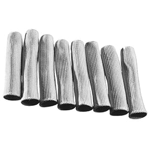

Third suggestion. Go to autozone and get a pack of plug sleeves. I believe they are usually Accel brand, and back with the Spectre chrome stuff.
Ive been running these for years. Ive even used them to insulate fuel and brake lines, and clutch hydro lines where they come close to the headers. My #2 plug on my car is hard against the primary. The boot has never melted, the sleeve has never burnt. Im running stock Z06 wires too...nothing special. Stainless uncoated headers.
Thats how it is 24/7. Laying right on the header. They look kinda cool too in my opinion.
Just make sure they are nice, double walled fiberglass ones. I think they're about $40 a set...maybe less.
