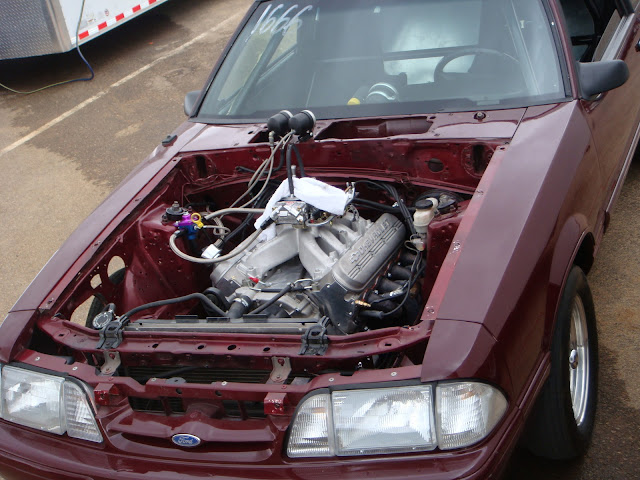

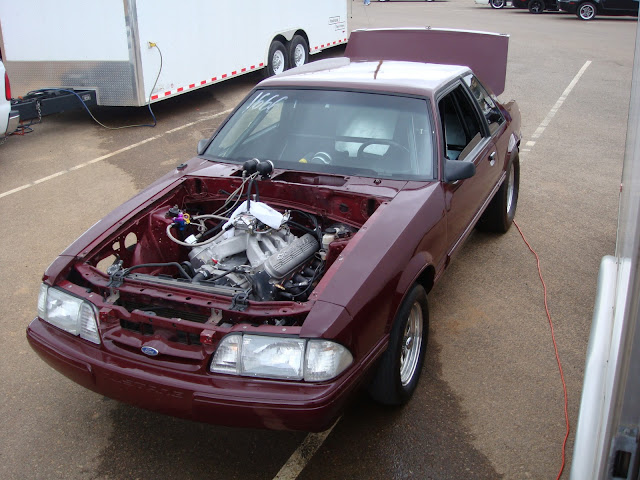

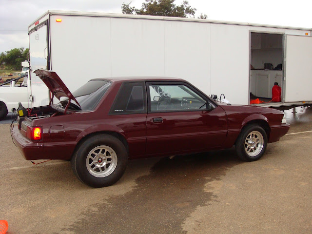

Back from the track and it was a very eventful day. I had some tech issues with neutral safety, holes in the firewall, and harness dates. The tech guy seemed like he was being really strict with me and not others. They still let me run, but told me to take it easy and not come back without everything fixed.
I ended up getting 3 passes and all I can say is that this car is crazy.
Pass one:
I just wanted to make a 60ft pass to see if everything was tight and in place. I simply went WOT from idle and ended up cutting a 1.35 60ft time. No wheelies or craziness, but the car started to dart to the right after about the 100 ft mark. I coasted to an 8.6 at 63.
Run 2:
Much better burn out and brake stalled it up to 2000 rpm before going WOT. The track was kind of wet and the car got out of control and ran a 1.5 60ft. Coasted to the finish and went 8 something.
Run 3:
From idle I went a 1.37 60ft time and got out of control around the 100ft mark. I let off for a bit then decided to finish the run up and feel second gear. Haha. I got back on it and instantly bounced the rev limiter. I never saw the shift light so I ended up sitting on the limiter for quite awhile before realizing it was time to shift. Bumped second gear and pulled it out to the finish line. Ended up running a 6.6 at 90mph. HAHA
So it's time for me to get the car scaled and figure out what is going on with the car pulling to the right. I had the limiters set on the second hole and slicks at 9psi. I need to figure out what the shift light and rev limiter are doing too.
