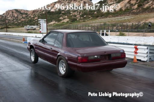

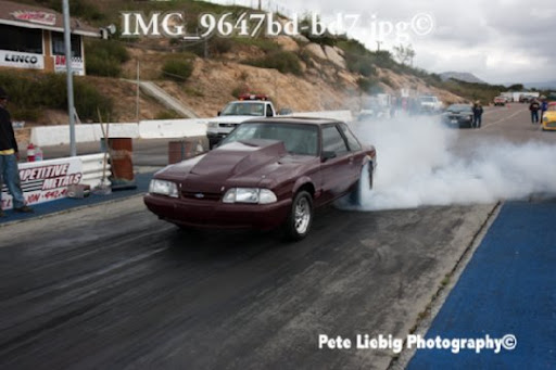

More pictures from the track photographer. I took these from his website and all credit goes to him for them (http://www.paklphoto.com/?Snapshots%21%21).

What is that orange/brown dust that was coming out of your exhaust when you launched? You can kinda see it in the first pic above. Maybe rust from inside the exhaust pipes? Or is that something to do with running e85?

I have no idea, but I think it is just the camera/angle/light. The car doesn't really do that as far as I can tell. Haha

No I saw it doing it when we were there watching you run.

Then I would guess it is rust. The bullet mufflers and headers were used and the car has very little run time on it.
I don't imagine it is anything at issue with the car.

That brown stuff is from the E85, there's a few turbos car around here than run it and their's all do the same thing when they're on it.

E85 is a weird fuel. It smells horrible in liquid form (like cheap liquor). When it is being burned in the engine, it really doesn't smell too bad but definitely a unique smell. My car has no cats and it doesn't give you that running rich eyes watering feel like normal gas does.
My car drinks a TON of E85 on a pass...even a partial pass. I would say that it was about 1 gallon per run between the driving, idle, burnout, and pass. I will probably bring 10 gallons to the track for a complete day of racing.
The cooling effects of the fuel are kind of weird when compared to what I am used to. My engine has an expansion plug rather than thermostat currently. At idle, I can't get the car over 150 degrees even with the fans OFF. After letting the car idle for 5-10 minutes in the staging lane and my most complete pass, the car was only 150-160 degrees on the return road.

9 psi in the tires can be very silly off the line. I would never run them below 11-12 psi and even that can be a hand full to drive if the car does not go straight. My car with a 28x10.5 tire likes 12-15 psi. Anything lower than 12 and it wads the tire up like your's in that picture. It looks like your rim is almost bottomed out on the ground on the left rear. Too low of air pressure.
Has the car been aligned recently? Or did Kevin do it with those wheels on it? I check mine every time I change something with the susp or tires.
1.35 60' is awesome. It should do low 1.3's or even high 1.2's when you get it all lined out. Good job.

I haven't even had a chance to play with tire pressure yet. It ended up at 10.5ish psi after the burnout. I will try a bit more air next time and see what it likes.
The car hasn't been aligned since I did all of the work. A bit of playing with the car and running it through suspension travel, and it appears the darting is caused by a bump steer issue. I either need to adjust it or add some length to the rods. I plan on dropping the car off to get scaled, aligned, and the bump steer issue sorted out before returning to the track.
I'm happy with the 60ft time and I know it has more in it. The car went straight and was quite calm during the 60ft. It only got crazy down track before the 1-2 shift. The 60ft was off idle (1000rpm) or 2000rpm with the travel limiters on tight (very little travel). I hope to go 1.2s when on the t-brake and susp. dialed in.
