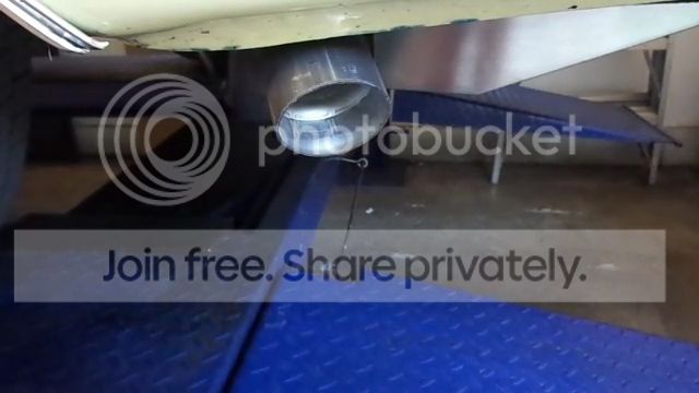

Click on the link for how it sounds
http://vid13.photobucket.com/albums/...t/MAH02543.mp4
Old Jun 21, 2016 | 02:37 AM
  #306
Jimbo1367's Avatar
Joined: Jul 2009
Posts: 8,034
Likes: 663
Thanks for the pics. Do you recall the brand of overflow tank? I love the sound. Nice and quiet!

I had the exhaust dumping out just after the rear tires (headers, X pipe, and Magnaflow XL mufflers) but the drone was HORRIBLE. At certain RPMs it would drown out the radio and good luck trying to talk to anyone in the passenger seat. My solution (that I am still working on) is to extend the exhaust to the bumper, and I am also adding 2 Vibrant 1792 resonators right before the tips to lower the volume a bit and help with the rasp. I will report back on how it works out.
I wanted to report back on my exhaust mods in case anyone following along is wondering how it turned out. From the outside, the car is quieter, but still a little loud for my taste. Inside the car there's a HUGE improvement. Still a tiny bit of drone under significant acceleration, but the volume inside is MUCH lower. ALL the rasp/coughing sounds are completely eliminated, and everything feels silky smooth now instead of feeling like I am riding around in a racecar. I am likely still going to swap out my Magnaflows for the Dynomax Super Turbos as Ken suggested, but for now I am pretty happy.
For anyone interested, I used Vibrant 1792 resonators (2) near the end of the exhaust. I also extended the exhaust to the bumper instead of dumping after the rear wheels.
