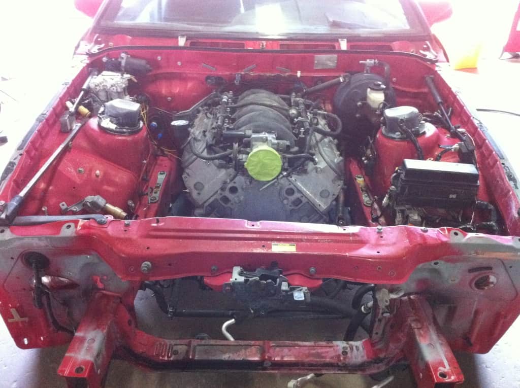

This is a fairly easy swap. You can fab motor mounts that line right up with the factory engine mounts on the subframe. The transmission crossmember is easy also. The Corvette FFR mounts where the stock filter did in the rear of the car. Install a Walbro pump in the stock tank and you are good to go. 1st generation CTS-V exhaust manifolds work but angle milling the mounting flange allows them to tuck closer to the block for a little more clearance. Making the stock gauges work isn't too bad either, program ECU for 6 cyl tach and use a Cable-X box for the mechanical speedometer. 4th gen Camaro oil pan clears the crossmember with no modifications.
The LS engine is way lighter than the stock turbo engine so you will need shorter springs in the front. Also the LS engine has most of the weight behind the shock towers and sits lower in the chassis.

I am also doing a MK3 supra lsx turbo, my question is what engine mounts will work best. I know that chopping and cutting is required but does anybody know which would fit a mk3 supra better?
Old Sep 19, 2012 | 08:07 AM
sierrac3_s2000's Avatar
Joined: Jan 2004
Posts: 368
From: Americus, GA
The ones we used that are in the photos above came from here.
http://www.progressiveautomotive.com/motor.htm
They are model MM-LS1. We then made the plate with the tab on it that fits into the stock subframe. We used a grade-8 bolt tack welded to the plate so that you could install the nut from the bottom side which is easily accessible. The tube from the motor mount kit fit perfectly over the top of the bolt and also prevents the bolt from turning should the tack weld ever break. Hope that is clear. Unfortunately I don't have pics of those parts.
