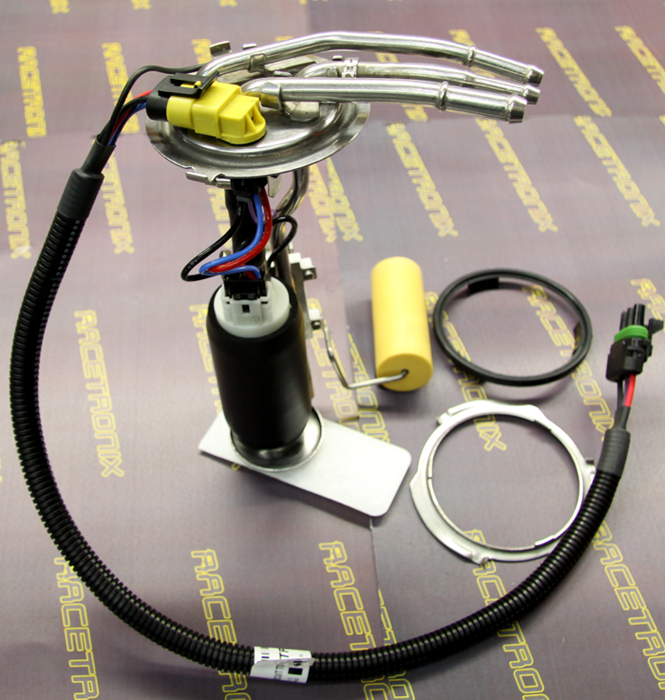

I have a 72 chevelle conversion. I'm going to use the GN tank, can some one help me out with all the fitting.
The fitting off the tank to convert to a -6an line?
How do you go about running the return line to this style tank?

http://www.racetronix.biz/itemdesc.a...W255AN&eq=&Tp=
found that looks nice

Is there a way to convert the sending unit like this to accept An fittings? I know racetronix sell one already made but I want to see if there is another way to do that so I can save a few bucks.
Are there any threads that shows how to run the hoses from the fuel tank up to the fuel rails? If so please post the link. I searched & couldn't find anything.

You could cut the flared tip and perhaps:
http://www.summitracing.com/parts/FRA-581906/
http://www.summitracing.com/parts/FRA-581806/
they also make them for -3 and -4 for the smaller line.
what do you mean by 'how'?
I am using steel line, 3/8 feed and 5/16 return.. taking them from a rear crossmember near the fuel tank, to the chassis at the front of the cab (its a truck), then rubber line up to the manifold using the stock style connectors.
I thought about braided stainless, but as its all hidden, why waste the money.
and using rubber hose from the rear of the steel lines to the tank (return) and tank to filter(LowPressure) to pump(Walbro 255lph external) to filter (HighPressure)
Sam

how would those be put onto the line?
