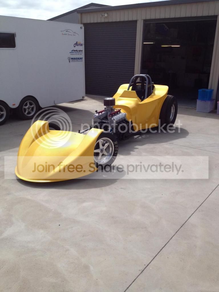

Race car has been at a friends house for awhile now while we were building the engine and getting the engine and trans into the chassis, so it has now finally come back home.
Looking at this photo though the engine gets lost, I think it needs a set of twin turbo's

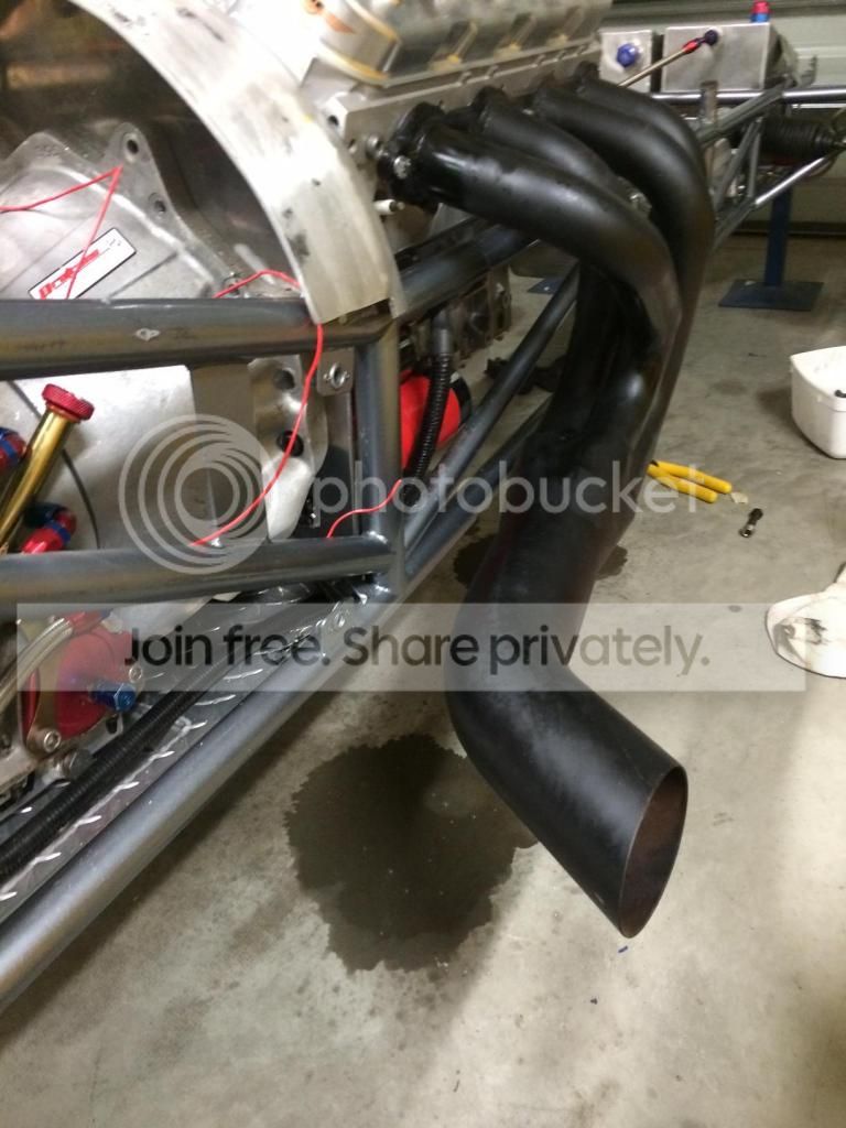

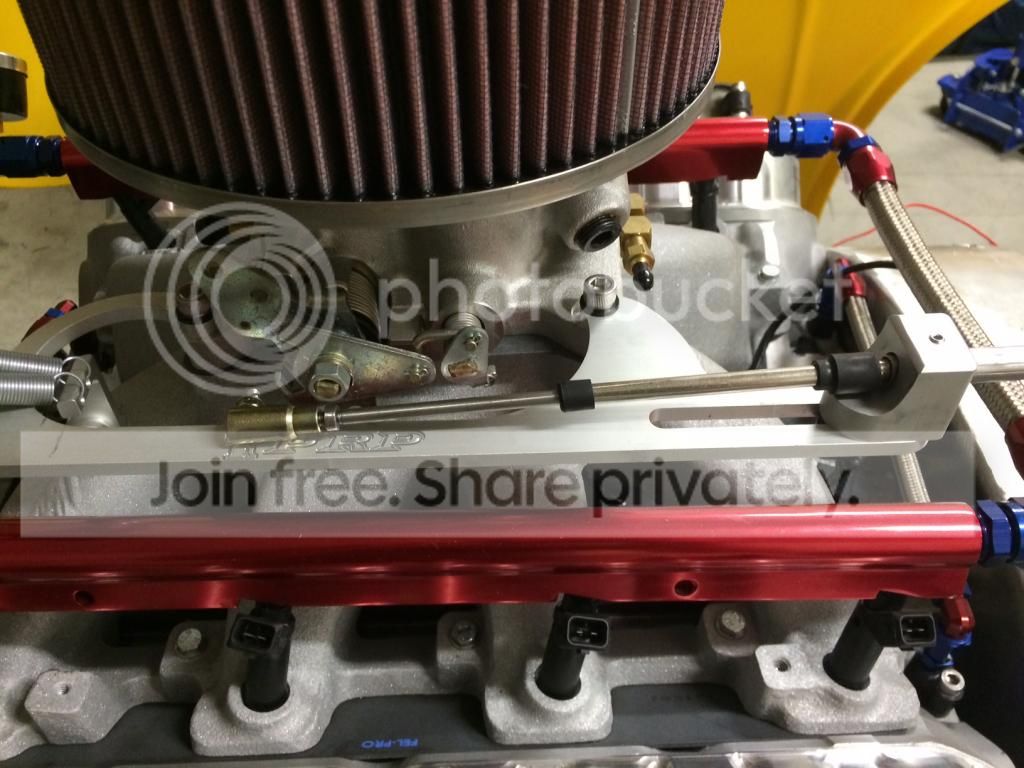

Throttle body mounted, throttle cable bracket and fittings 95% complete. Will have to fabricate a small extension off the ball joint to reach the throttle body.

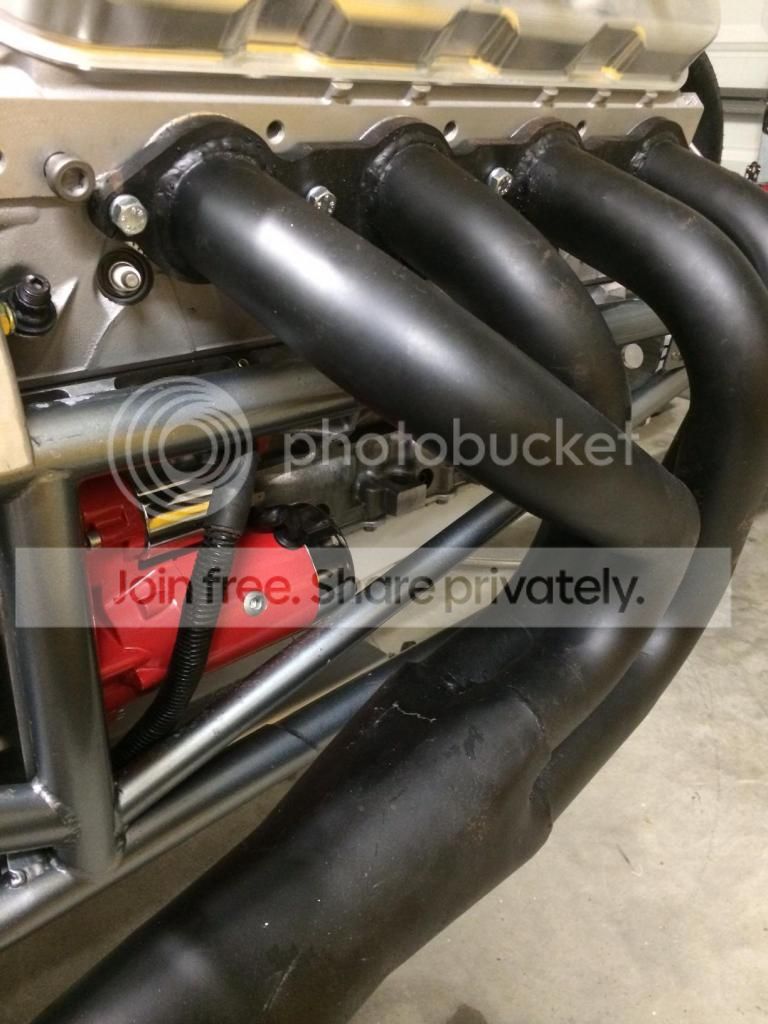

Starter motor shimmed up to within tolerences, and right hand side pipes installed. Starter wiring hooked up.
And lastly a test fit of the floor to check it still fits with the new engine plate, and different starter motor and wiring locations

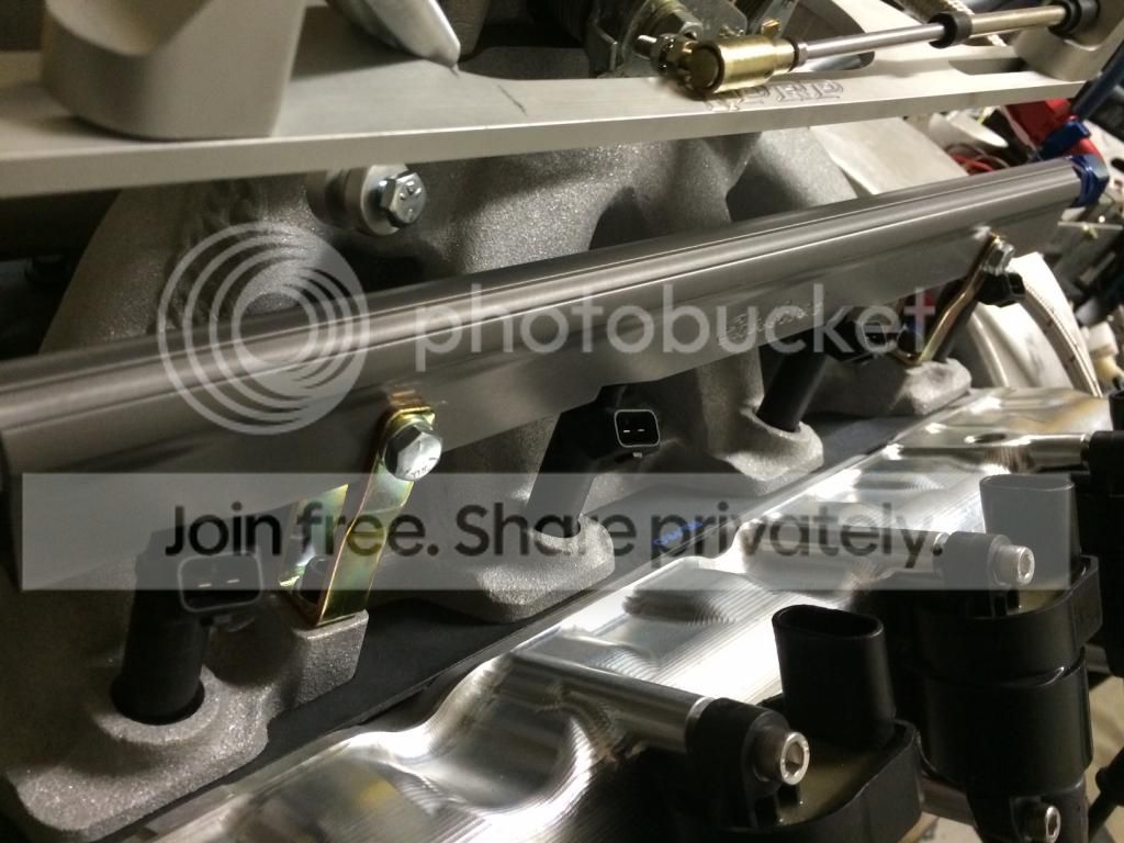

However I cannot get the fuel rails to correctly seal against the injectors with 60psi flowing to them!
So have had to order the Edelbrock fuel rails to suit the manifold (was trying to run with a set of generic ones)

New fuel rails that actually don't leak. Fire up tomorrow hopefully

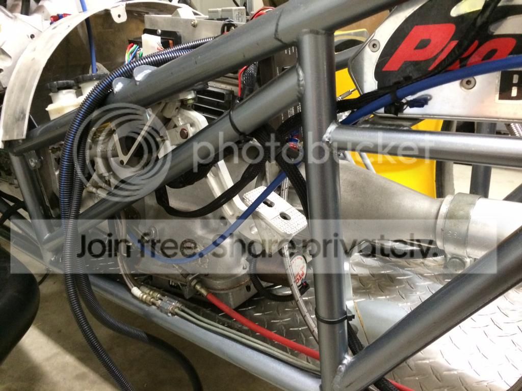

Excellent work man and very cool build. Never realized you were that exposed to the transmission and driveshaft.

Thanks and yeah, everything is a tight squeeze!
The tailshaft is enclosed in a 5mm think alloy tube, and uses couplers rather then uni's. The gearbox is all SFI rated casing etc.
